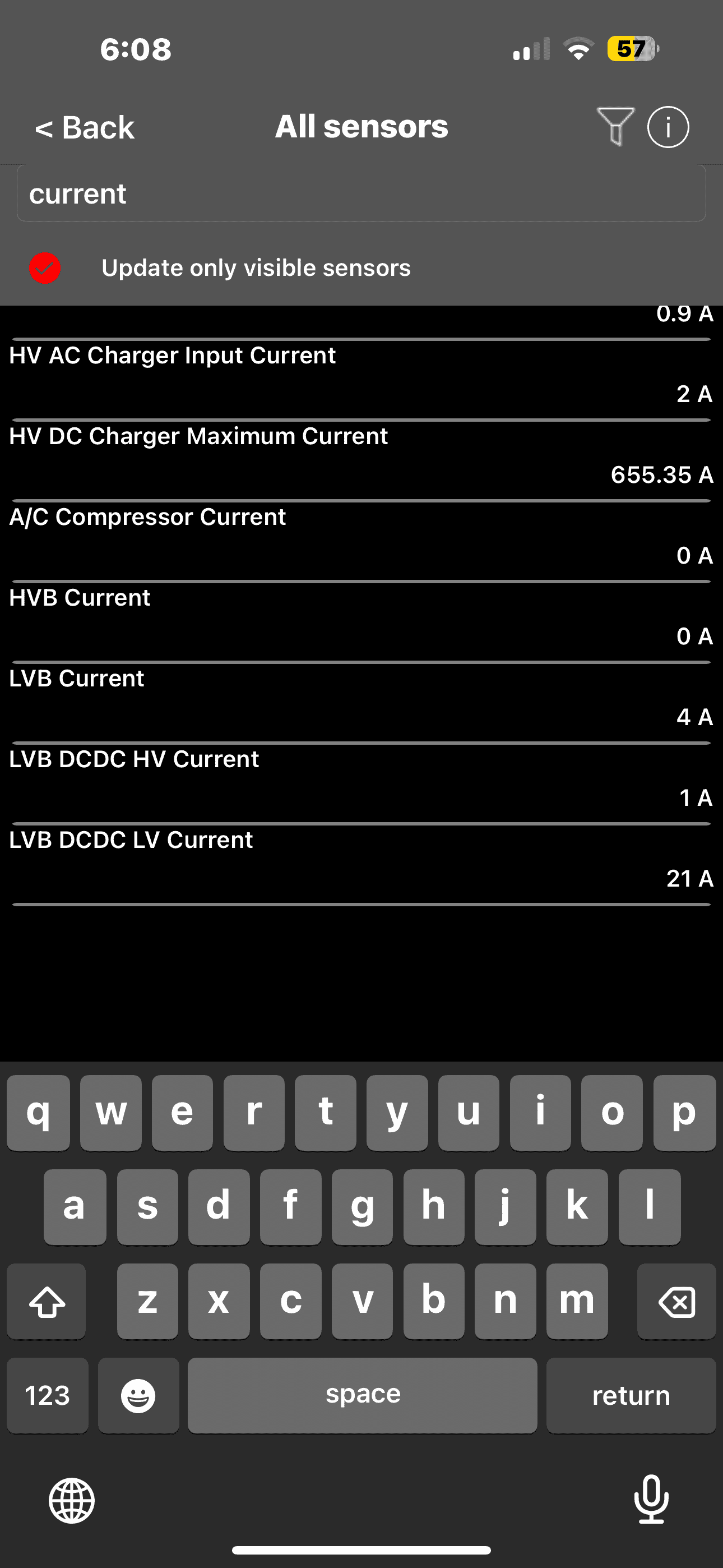

I have checked this several time and it does not have to be plugged in to charge LVB. It is not intuitive and I didn’t expect to see it work this way but you can clearly see in the scanner current is coming out of HVB and LVB SOC going up when in accessory mode unplugged. I always thought HVB is disconnected unless you turn on the truck. May be DC to DC converter is hooked up to HVB before the contractor that feeds the motors. I don’t know how it works but this is what I see.

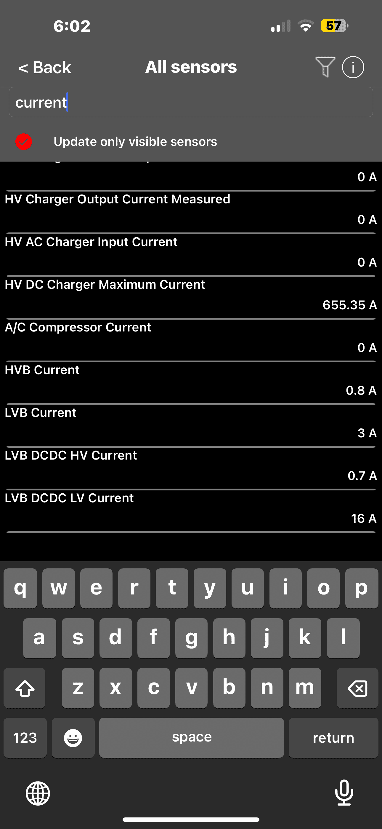

Here are screenshots of what I see entering Accessory Mode in various ways. IIRC, I turned the headlights from Auto to Full Off before taking any screenshots for any of the three Accessory Mode schemes. All accessories like FAN and AC on the Sync screen were off, too.
The LVB would seem to be charging faster if the truck is plugged in in Accessory Mode as the applied LVB voltage is significantly higher. Someone more knowledgeable about truck electronics would have to explain what the various sensor current readings mean. Sorry if I should have captured more sensor readings in one screenshot by figuring out how to dismiss the keyboard display on my phone created by typing "current" as the desired sensor filter in CarScanner Pro.

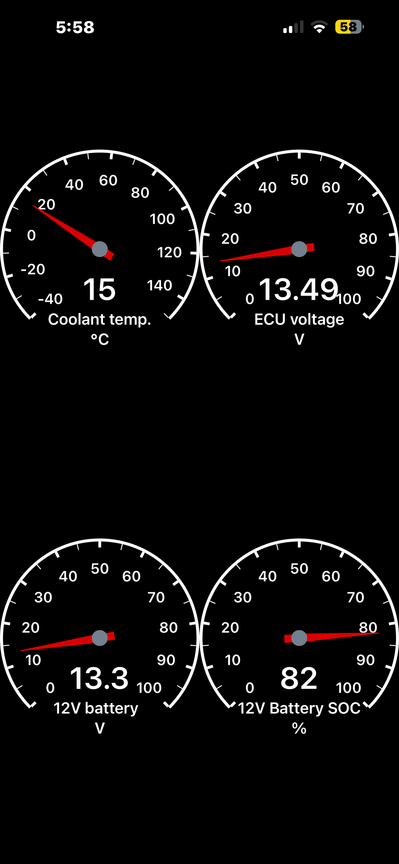

Truck Unplugged. Just press Power Button.
Notice just the battery icon on the lower right dash(pic #1), the reduced applied LVB battery voltage(pic #2) compared to two other schemes below.

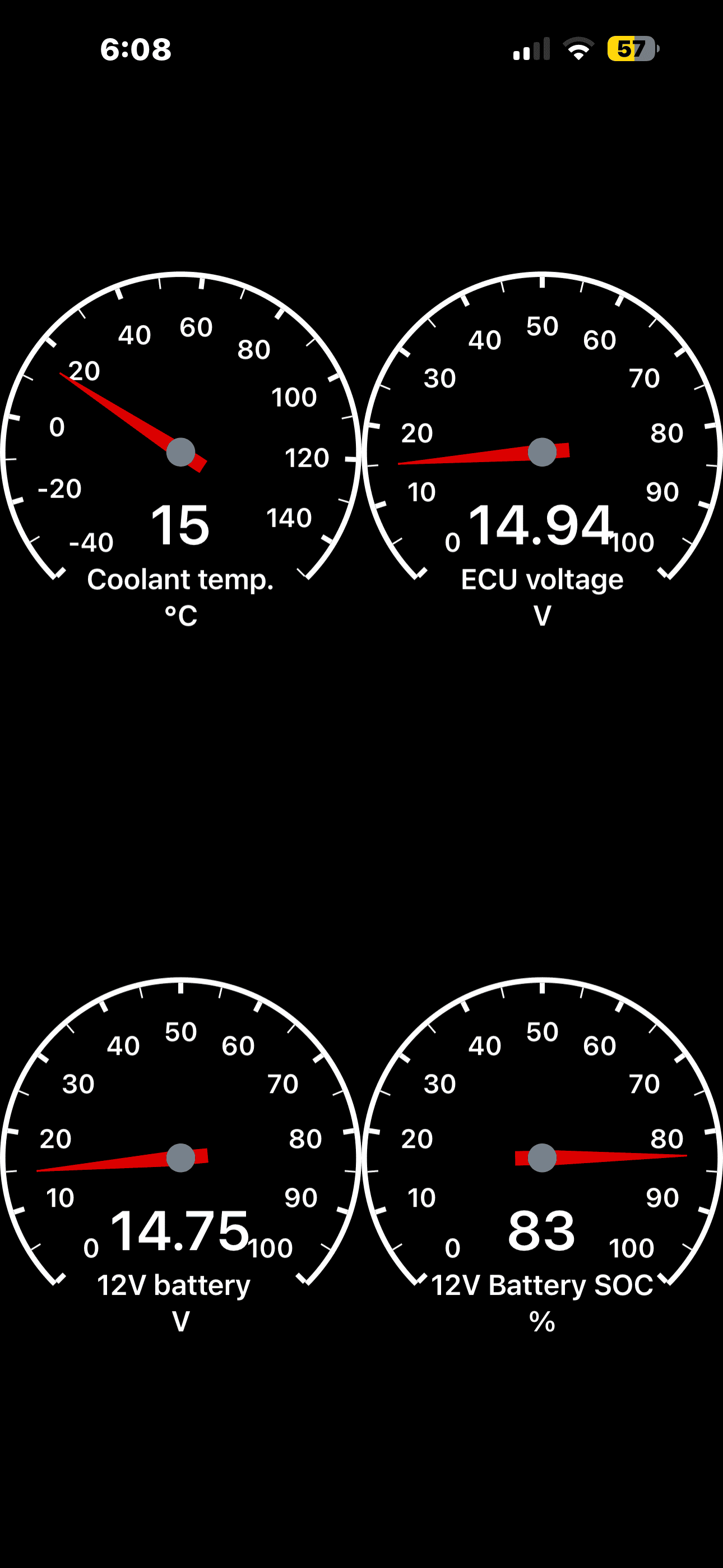

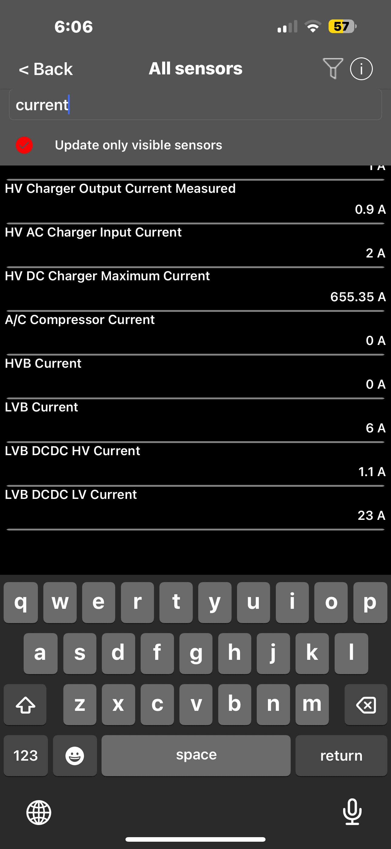

Truck Plugged In, Just Press Power Button.
Notice both the battery icon and the charger icon on the lower right dash(pic #1), and the higher applied LVB battery voltage(pic #2) compared to the previous scheme above.
Great shots. Thanks for sharing. I have been passively using the scanner occasionally for specific purposes but now you got me excited enough to customize my own screens and start looking at stuff closer to learn how this thing works.
