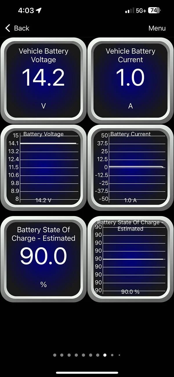

Here’s with the truck on:
Ford F-150 Lightning 12 volt battery indication - issue? IMG_0106

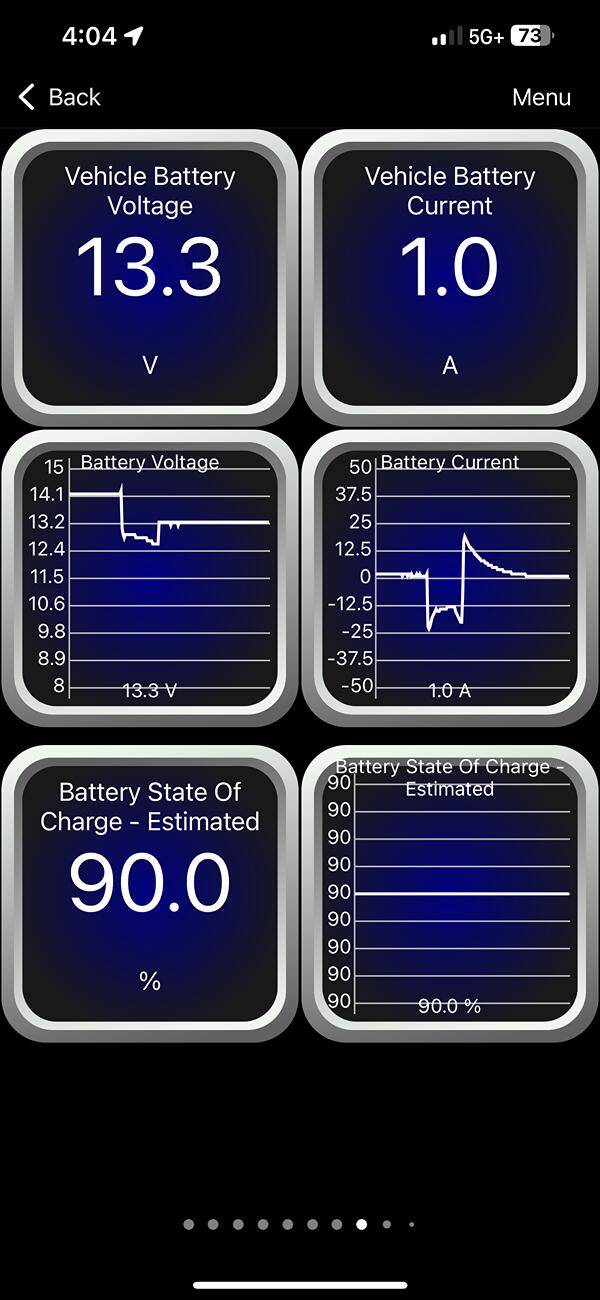

And here’s in accessory mode:
Ford F-150 Lightning 12 volt battery indication - issue? IMG_0107

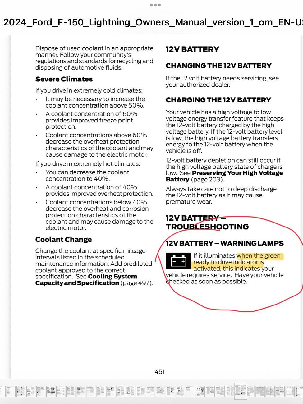

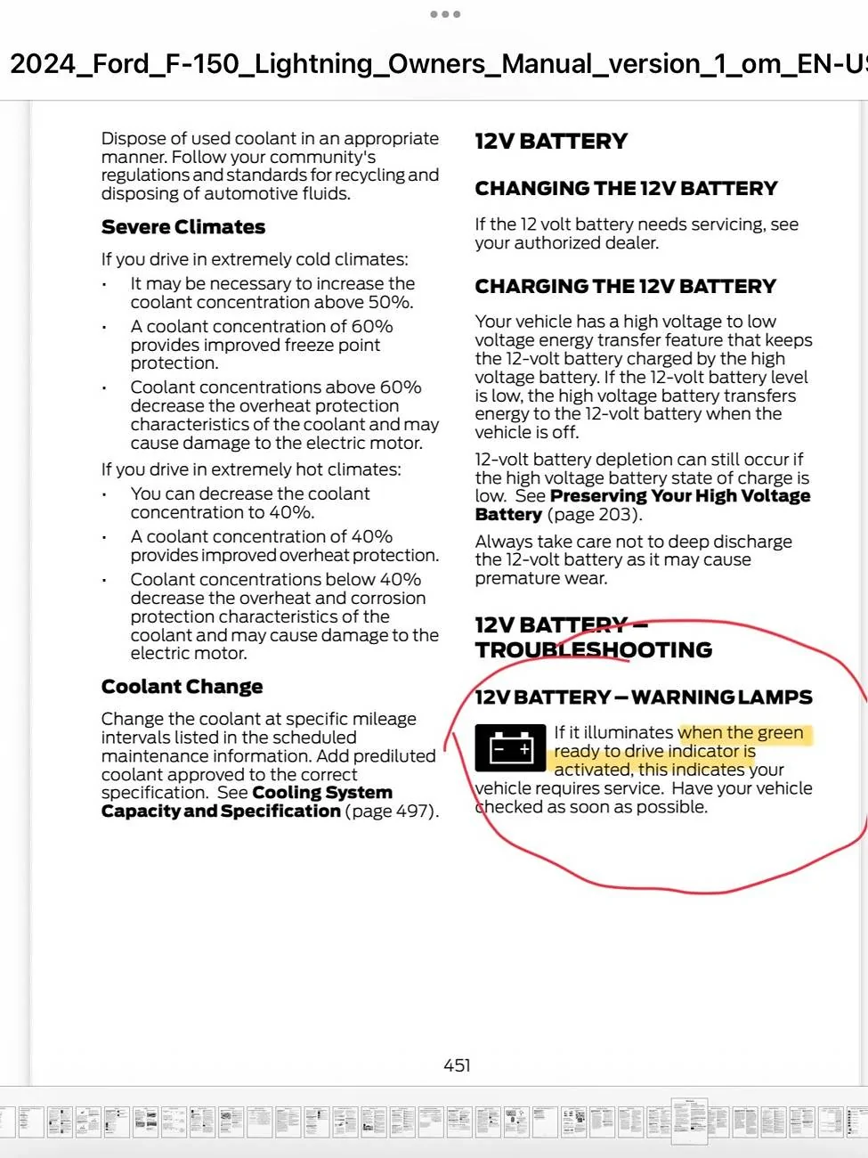

I fully understand both of those. But that is not a "problem" as would be indicated by the dash light indication. As I said at the beginning, I recall reading here that what is normal is that at boot up the indication will display and it SHOULD then go out unless the 12V battery is in trouble. Mine never goes out while in accessory mode. Works fine when "On" and therefore the HVB is providing charge to the 12V system.
Guess I will ignore it.
Don’t ignore it, it’s telling you something just Like a regular car.
And the truck ain‘t “booted up“ yet, until she is in “READY“ mode.
The 12v battery Indicator being displayed is only a problem if it’s
still displayed when the “ready” light is on.
Ford F-150 Lightning 12 volt battery indication - issue? IMG_0406
This is no different than a regular car.
When an ordinary car is in AcC mode, without the engine running (no alternator charging output), the 12v battery light is on to let you know you’re draining the 12v battery. Normal. This is what you’re seeing.
If the 12v battery light is still on when the engine /alternator IS running, that is a battery or charge fault indication. PROBLEM.
In our truck the “ready” light is an indication of “engine running/alternator charging“, (but in this truck the so called alternator is a dc/dc converter )
So,
If the 12v battery light is on when the “ready” light is on, there is something wrong with the 12v battery or charging curcuit. PROBLEM.
Otherwise, you’re in AcC mode and depleting your 12v battery so the 12v battery indicator you see is normal.

Ignition status--Voltage-- Bat Lamp
OFF------------12.0v------not showing
ACC -----------13.4v------RED
READY---------14.5v------not showing
As mentioned by a few folks above, the battery get's moderate sustenance in accessory mode even though the legacy lamp behaviour persists, this mild boost in charging might be 'just enough' energy to maintain the 12v battery without extraordinary loads.
