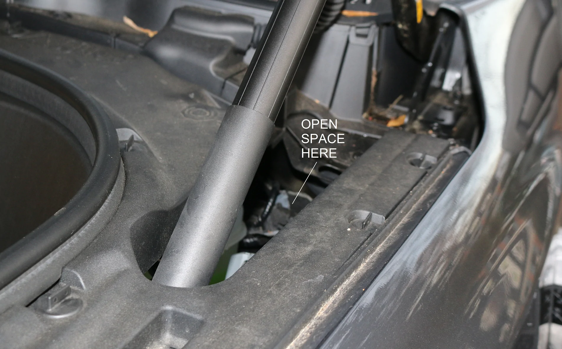

You can feed the wire through the space under the frunk strut when it is opened:
Ford F-150 Lightning 12v Battery Swelling IMG_6022-open space under frunk strut
I was able to reach in there to feel where to drill the small hole next to the hings and to route the wire over towards the battery compartment.
