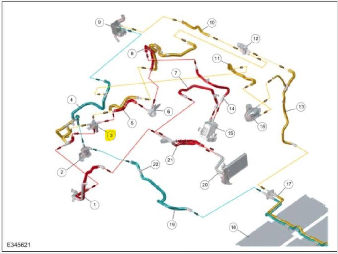

So I researched some more and while that valve and another one do provide power train cooling, they are also responsible for diverting coolant to the ProPower inverter, cabin A/C / heat, motors, on-board AC charger, DC-DC converter, HV battery, etc.
So while it is critical and part of the both the power train and battery cooling systems, it also serves other components.
I'll send you a DM.

NOTE these are schematics of the Mach-E system which the Lightning shares the majority of concepts, (Max Tow components are not included in this version)
Ford F-150 Lightning Ticking from 12v battery compartment 1746566831577-ht
Ford F-150 Lightning Ticking from 12v battery compartment 1746566663929-26
