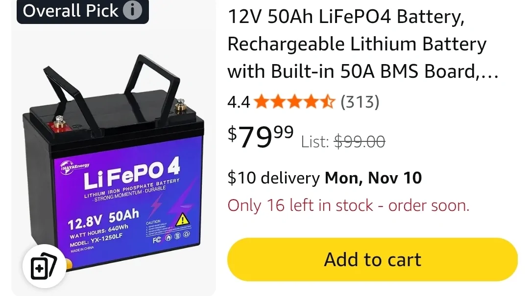

I believe this will work for you. It's a 12V LiFePO4 battery with a built-in Battery Management System [BMS]. The original battery is also rated at 50AH. I believe the BMS would allow you to direct substitute it for your factory battery.
I probably would use it all the time, but to get you out of a pickle, it should work great. The good thing about LiFePO4 is you can charge them and they stay charge for a very long time.... and they are small and light. So charge it and store it in the Frunk.
You'll have to add adequate jumpers to connect the battery to your existing disconnected cables, but that's easy. Be sure to isolate the ends of your jumpers to keep them from touching.
What does the rest of the group think? Do you think it will work? Why wouldn't it?

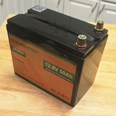

I'm going to replace the stock 35Ah AGM with this one, has the battery terminals on the same end like the original just add adapters as shown, and is almost identical in dimensions.
The only caveat to using these type of batteries is temperature, LFP does not like it cold, extreme cold that is, will charge and discharge well below the temps I see down here. They also make them with built in heaters for extreme climates.
Ford F-150 Lightning 12V Emergency Charger 54893124970_9f9f2a6aa3_w
I have a solar system for powering my home and I use this brand exclusively. Customer service is top notch! Only had to contact them for a couple of issues which they promptly remedied with other products they make, haven't had any issues with their batteries.
