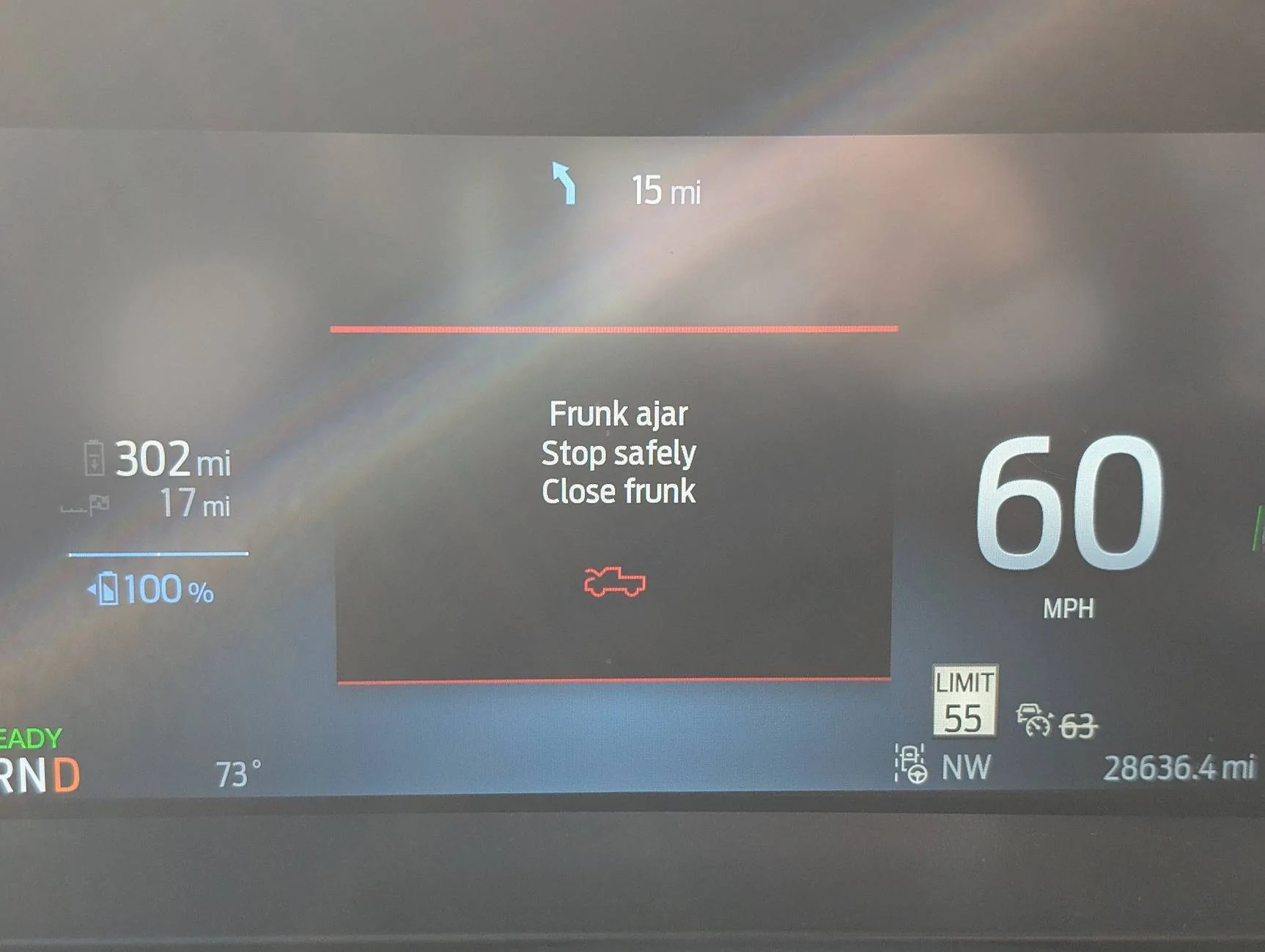

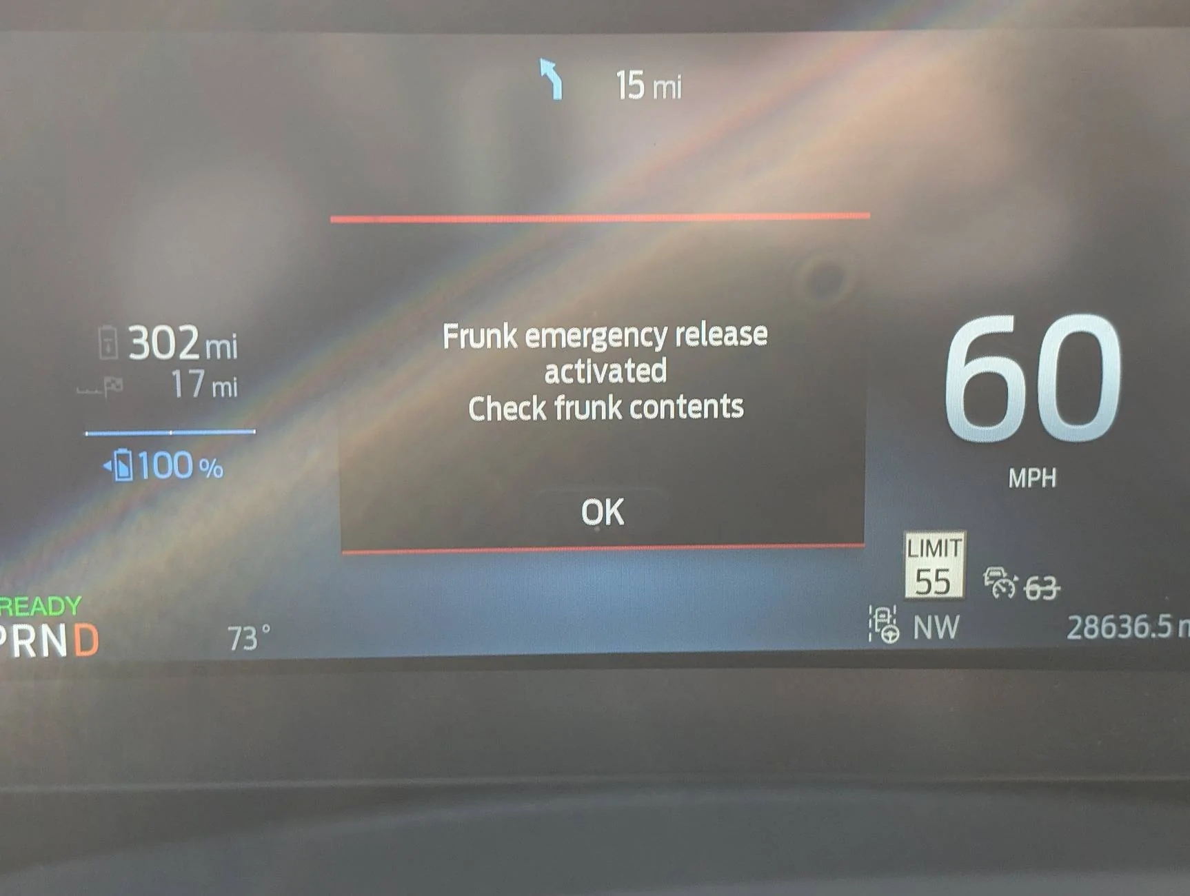

This is what happens when cargo presses the frunk emergency release button while you're driving. The truck does some warning bleeps and flashes these two screens.
Ford F-150 Lightning Emergency Frunk Release Activated - lesson in organizing cargo in the frunk 1000019079
Ford F-150 Lightning Emergency Frunk Release Activated - lesson in organizing cargo in the frunk 1000019078
Fortunately the frunk does not fly open. It remains closed while driving.
As you can see from the speed, I was on the highway. I took a interchange corner on-ramp and the cargo shifted in the frunk. Apparently enough to press the release button.

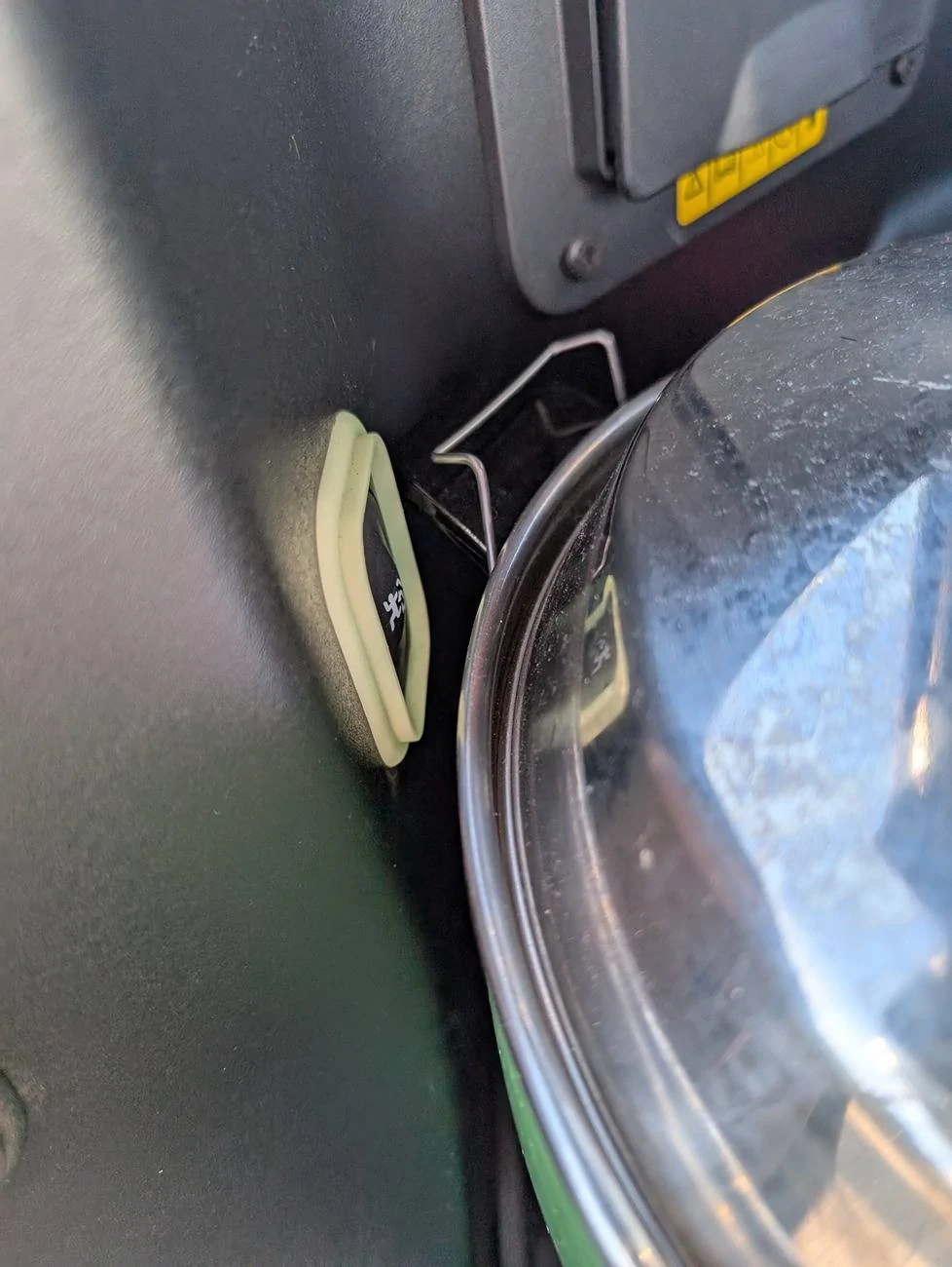

I drove another mile or two, enough to get off the highway and pull into a parking lot. Opened the frunk, shifted cargo around so it wouldn't press the button, and continued on. Here's the offending item.
Ford F-150 Lightning Emergency Frunk Release Activated - lesson in organizing cargo in the frunk 1000019091
I do recall folks here 3D printing a cover for the button to prevent this situation.
Lesson: Keep stuff away from the emergency frunk release button. If the button does get pressed while driving, it won't cause a crash, you can still see because the frunk stays closed.

I also had this happen a few times with golf clubs. The 3D printed cover helped as long as it doesn't pop off. I glued mine on to keep it in place.
