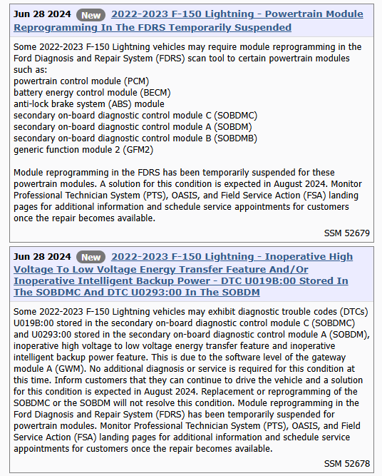

Well there’s nothing that can be done on our end. first, we don't have any powertrain updates to apply anyway so the GVMS block is kindof a moot point, but we're all still waiting on the updated gateway module that was supposed to come out "in June". So maybe later this week we'll see something show up, like Wednesday-Thursday timeframe....when most Lightning updates appear in FDRS.

Now instead of 'June' it's going to be 'August'......(well that's the new plan, could move the goalposts again later I suppose....)
Ford F-150 Lightning 2022-2023 Lightning-Powertrain Reprogramming Pause-Now Extended to October Ford_and_the_Football
Ford F-150 Lightning 2022-2023 Lightning-Powertrain Reprogramming Pause-Now Extended to October PTS_28-Jun-24

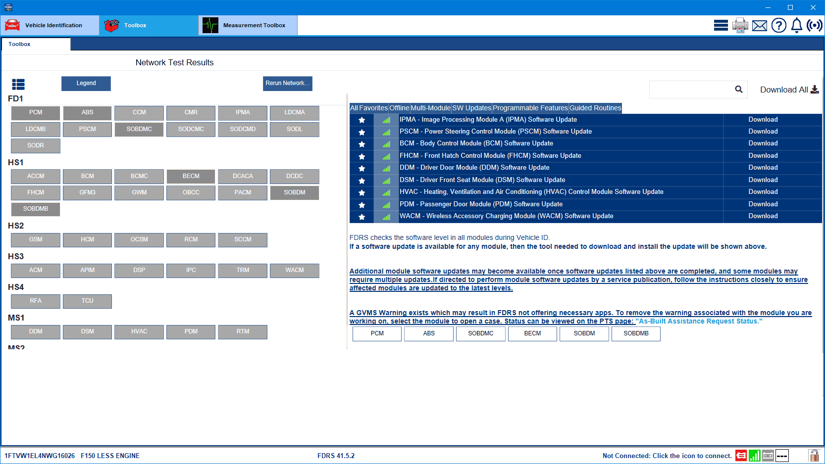

Does this apply to ‘23 and '24
PTS alert just says "Lightning".
But the GVMS blocks are not on two '24 models I checked.
So it's assumed that it applies to '22 and '23 MY only at present.
'24 model:
Ford F-150 Lightning 2022-2023 Lightning-Powertrain Reprogramming Pause-Now Extended to October 24_Lightni

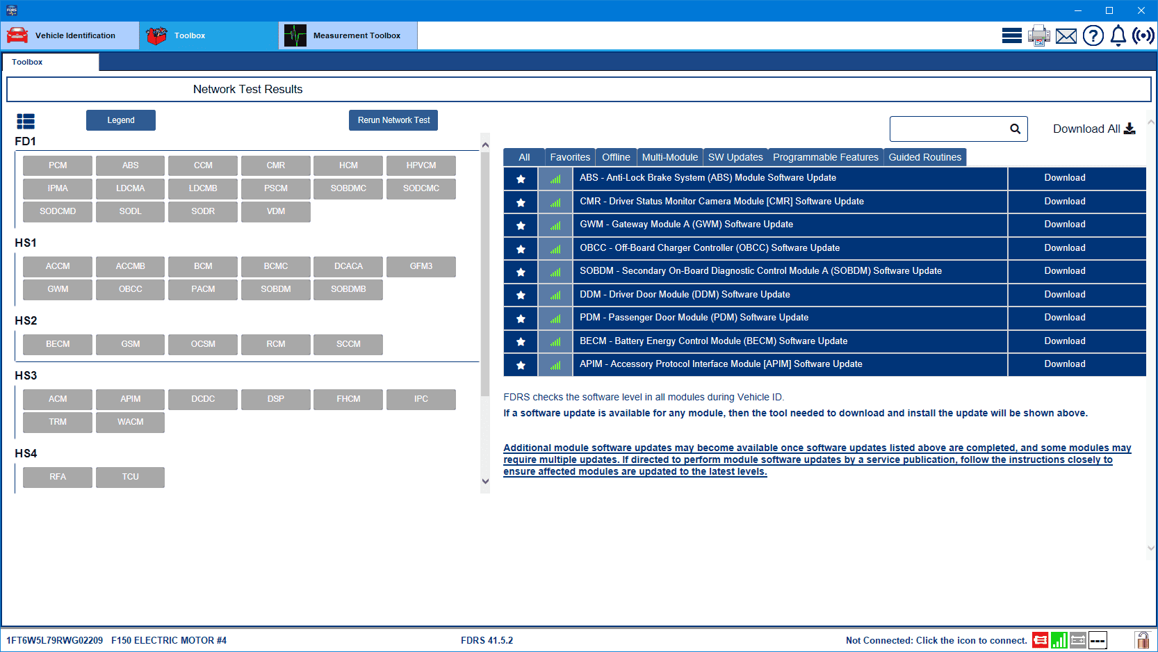

Hello. My Lightning has been in the shop for a month now. It's a 2023 lariat standard range. Anyway, it was unable to charge at home - it would charge for about a minute and then the blue circle would go orange and result in a charging error. The dealership confirmed the same issue with their charger (all level 2s). They diagnosed it as a bad secondary on board diagnostic module (which one, unsure... I'm new to this and learning).
The truck WAS operational and able to drive, I just could not charge it (obviously an issue that needed to be dealt with). I drove it to the shop with 80% charge.
They replaced the SOBDM with a new one, and have been unable to reprogram it. Since then, the truck is not functional (won't even , they have to jack it up to move it), still sitting there, and they keep telling me they are waiting for Ford to tell them how to solve a programming issue. They have brought it into the shop a couple times to check their work, but have confirmed its programming.
It has been a frustrating month now and they seem to be still struggling with programming this module as of today. Is the topic I am posting under potentially related to the techs have been having with my truck? It is a 2023 Lightning. They tell me it is a "programming issue" of the new SOBDM they installed. And if it is related, when will Ford allow the techs to program the module?
TIA for any help.
There is a block on programming all '22 and '23 model powertrain modules right now. The SOBDM is one of those modules that Ford isn't allowing techs to update (or do a PMI to install a replacement as well I'm guessing).
In this example below that's what the 'GVMS Warning' info means, and this would currently apply to your truck as well:
Ford F-150 Lightning 2022-2023 Lightning-Powertrain Reprogramming Pause-Now Extended to October Lightning_GVMS_Blocks
