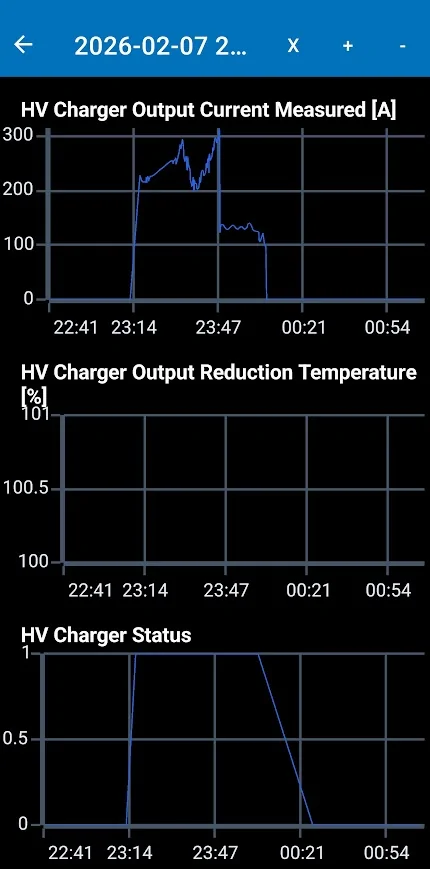

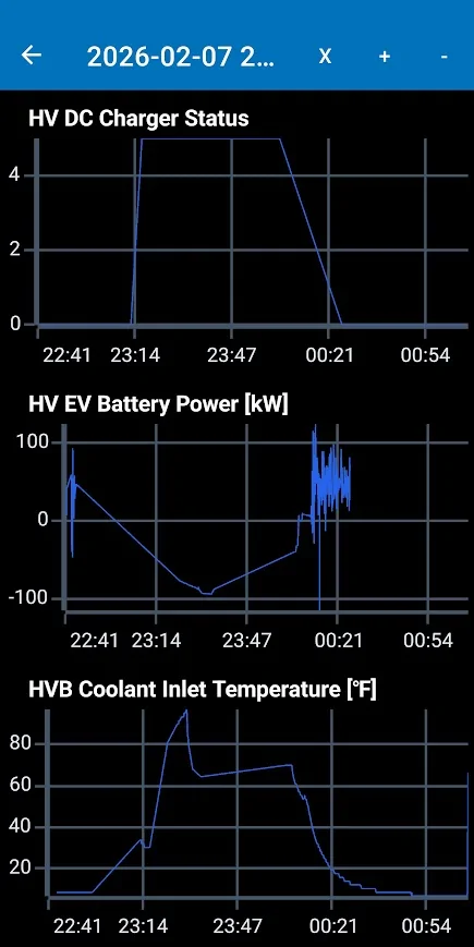

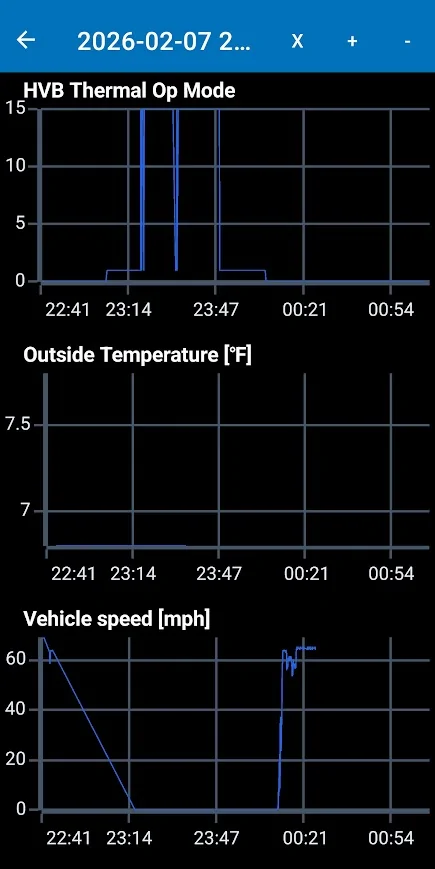

This log file starts with my drive from Dracut Mass to Reading Mass Ionna DCFC.
While enroute I tinkered with maps, destinations to charger and operation of cabin heating while driving, no cycling of the HVB heating mode happened until I parked the truck and plugged into the DCFC station at 6 degrees F
You see the operation mode switching between 1 and 15 based on my playing the HVAC controls.
Mode 1 appears to be the recovery method, scavenging heat from power electronics and motor heat exchanger, mode 15 appears after plugging in and switching off cabin HVAC or on with demand temperature set to very low.

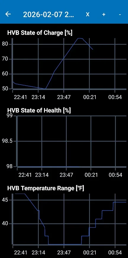

SOC, SOH & HVB Temp during that time frame, note 45 degrees retained from early afternoon level departure timed battery conditioning before the road trip started.

Coolant temps didn't start to rise until plugged in, note the scavenging mode while I was still driving. Positive energy is driving mode, negative energy is parked & charging mode.

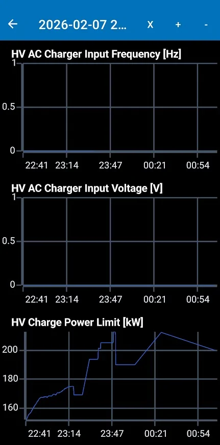

Charger status and limitation values
Ford F-150 Lightning 2022s Preconditioning on way to fast charger - Data Samples 1780952327671-8z
