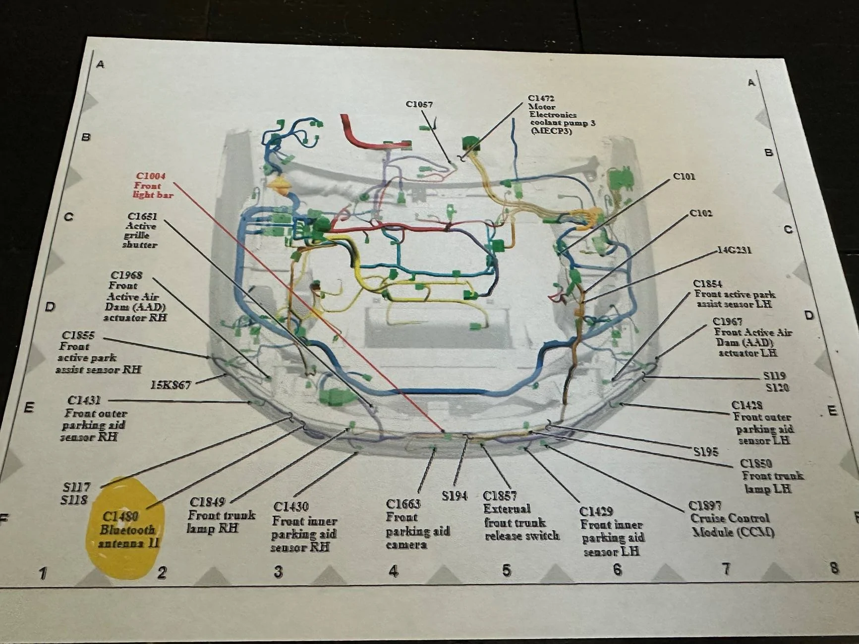

Hello Everyone,
I’m new here or to any forum for that matter. I am looking for a connector pinout for the Bluetooth antenna that is in the front bumper on my lightning. It was in an accident and it was sheared off. According to the dealer the park assist, auto park, BlueCruise will not function without it. I have codes that pop up (parking assist unavailable, pre-collision assist unavailable)I can’t find anything about on the internet and I just have these three wires hanging loose. I think I found the antenna
Antenna Bluetooth Module
Ford
Product ID: LU5Z-14G618-A
I just need to find the connector and/or a pinout. I was able to find this page from another member on this forum but that is all I can find.
Any help would be appreciated. Thanks in advance

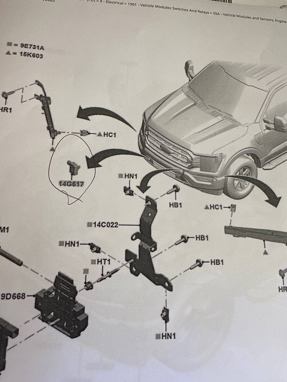

I looked at my copy of the general service manual, it only shows the harness and placement of parts, but not individual wire / pin outs of the connector to the device(s)
What are the color of the wires hanging loose?
There should be ground, power and signal to the can-bus is my guess, black/red/???? or some variation of this scheme.
Subscribing to motorcraft service portal and secure a short time license would give you time to peruse online service & wiring guides that will have more specific details.
