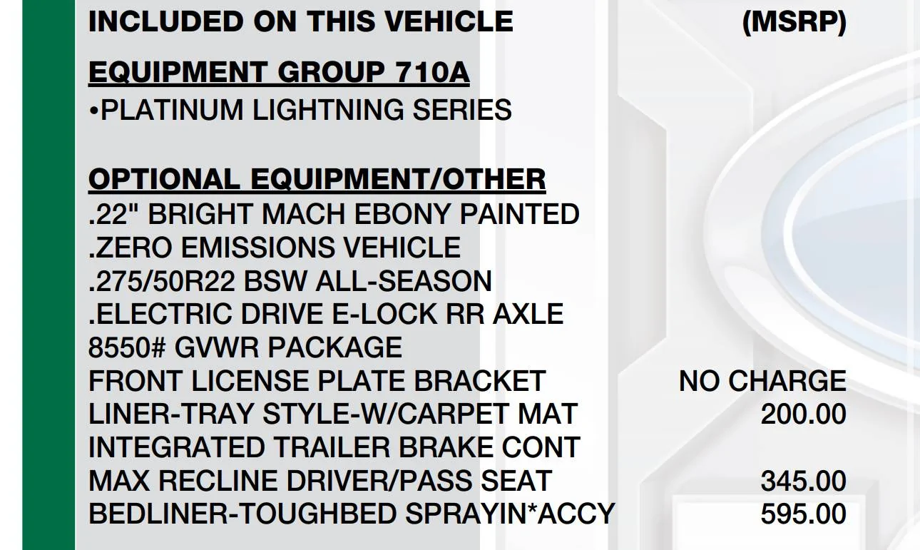

Thank you for the feedback. Really hard to find the Max Recline so may need to settle for the massage only portion. I didn't buy a Platinum a year ago as I preferred the 20" wheels of the Lariat and I thought the incremental price was crazy. Do you find the ride pretty smooth on the 22"'s?
My understanding was that you won't find max recline *and* massage in the same '22 but it sounds like that information may not be correct based on some of the responses here.
When I purchased this in 22, I was concerned about that as well. However since the multi-contoured seats come standard, I was able to add max-recline as an option.
This truck is like a unicorn in some ways, and if I sell it in a few years, I don’t think the dealership/next person will know what they have nor will I get a special deal since some of the things are not offered or available anymore.

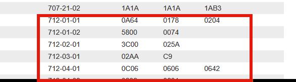

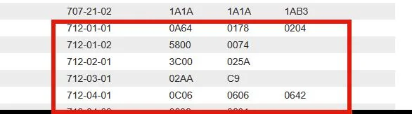

To determine if a truck has massaging seats if you know the VIN:
1) Go to the the Motorcraft AsBuilt site: www.motorcraftservice.com/AsBuilt/
2) Enter the VIN, solve the captcha and Submit
3) Scroll through the data and see if there is data for 712-xx-xx.
712 is the module ID for the Driver Multi-Contour Seat Module. It only exists for trucks that have massaging seats.
Example for VIN 1FT6W1EV4NWG08644:
Ford F-150 Lightning 2024 Lariat to 2022 Platinum?  Madness or no? 1747701255419-e7

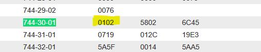

You can similarly determine if it has Max Recline. Scroll further through the data and find 744-30-01 (Driver Seat Module - Sleeper Seat Enabled):
0002-5802-6C44 No max recline
0102-5802-6C45 Has max recline
Ford F-150 Lightning 2024 Lariat to 2022 Platinum?  Madness or no? 1747701614731-3a
FYI the Driver Seat Module only exists on Lariat and above (memory seats).
