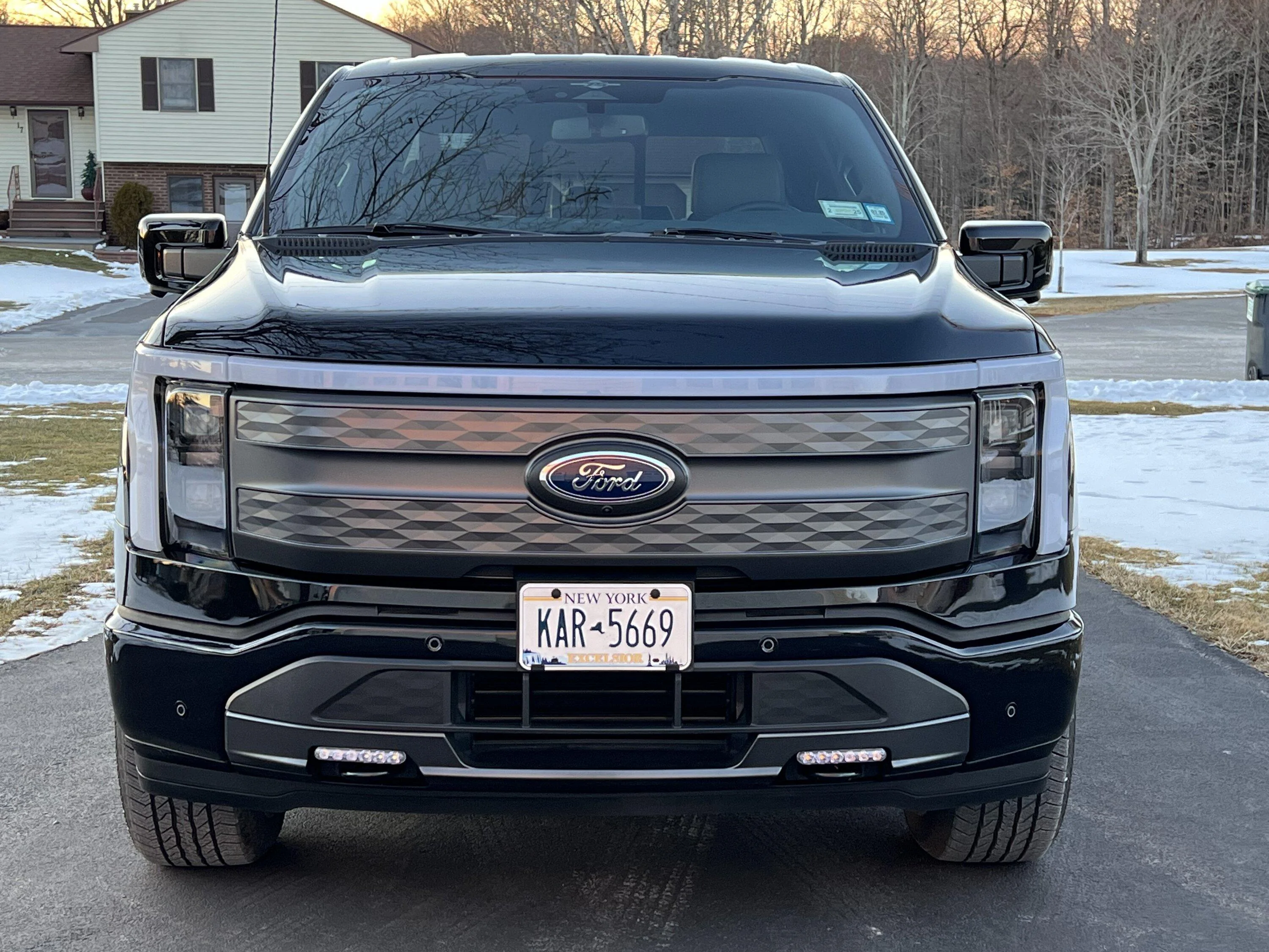

There is a 0.1% chance that $14 fake brand chinesium lights on Amazon will be useful in fog, or in really any other condition. There's no way to say that without sounding rude. It's just reality. Those lights don't belong on anything more substantial than a lawn mower. If you want light that is useful and has a real beam pattern, it will cost real money.
I went with Diode Dynamics 2" amber lights. They fit great in the air intake. Only temporarily wired up since I ran out of time. Hoping to get it permanently wired up this weekend and will post a thread about it. They are actually very very useful in fog and rain. And frankly are very nice in normal nice weather at night.

I'm in the process of wiring these DRL's/fogs that I just installed above the recovery hooks. I wanted to stay away from mounting them in the area of airflow. I know that with small lights in the airflow area most likely will not create any problems but if the truck goes into the dealership with an overheating problem and the lights are mounted there good reason for them to say that's the cause and bye bye warranty. Just my opinion.
I like the positioning of these. I was reading the reviews and people were complaining about the brackets, do you have any concerns about the lights popping off the brackets? I would love to see a pic of these lit up...
