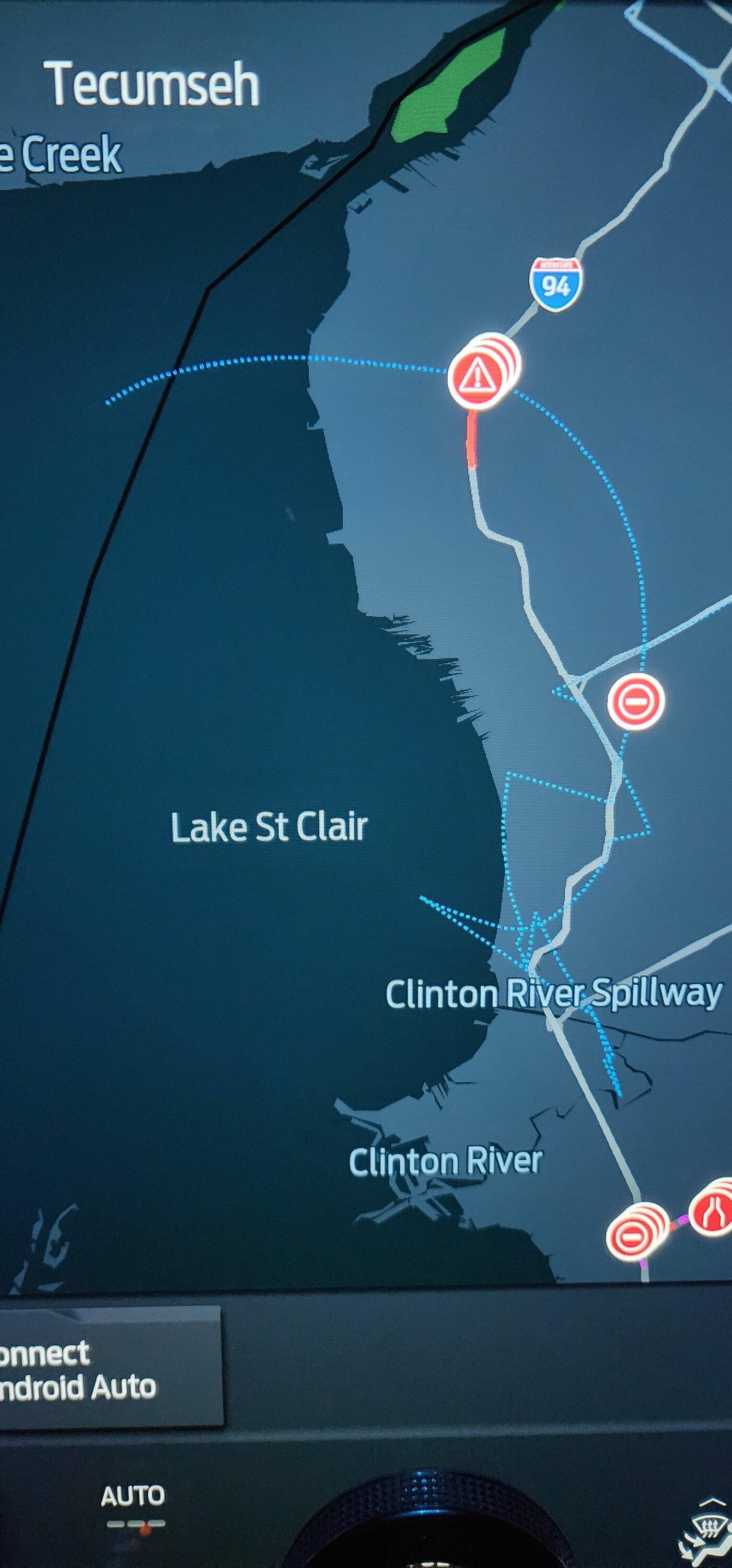

Anyone else have this problem ?
Not sure if it's a software issue, but you'd think the truck would complain if no GPS signal is found.
I drove about 900 miles last week on 3.5.2 and the GPS was fine.
Since then the truck has been in the garage since Saturday (could potentially have lost signal as a result).
The truck updated to 3.5.4 while parked in the garage.
Took it for a 40mile (20 there, 20 back) drive today and during the whole drive the GPS (on Android auto) was erratic jumping between roads etc. On the dash the speed limit showed 5mph and at times blank even though I was driving on a 70mph interstate.
Driving home tonight it was even worse, built-in Nav had erratic behavior initially and then eventually gave up and seem to rely only on gyro perhaps...
But at least Ford beat Tesla to an amphibious car :D driving into Lake St Clair (according to the nav, but in reality I was on I-94 the whole time)

Both are screwed up for me.
The screenshot is OEM / sync Navigation.
