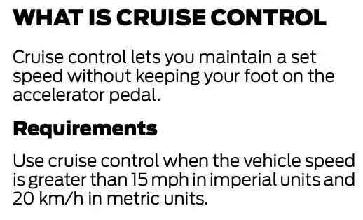

When you turn on Cruise Control it should not activate under 15 mph.
However, pushing the Resume button may have a lower mph threshold.
When I am done using Cruise Control I try to remember to turn it off to avoid accidentally touching the Resume button.
From the manual p279:
Ford F-150 Lightning Accelerating on braking? Screenshot 2024-12-01 at 5.11.40 PM
