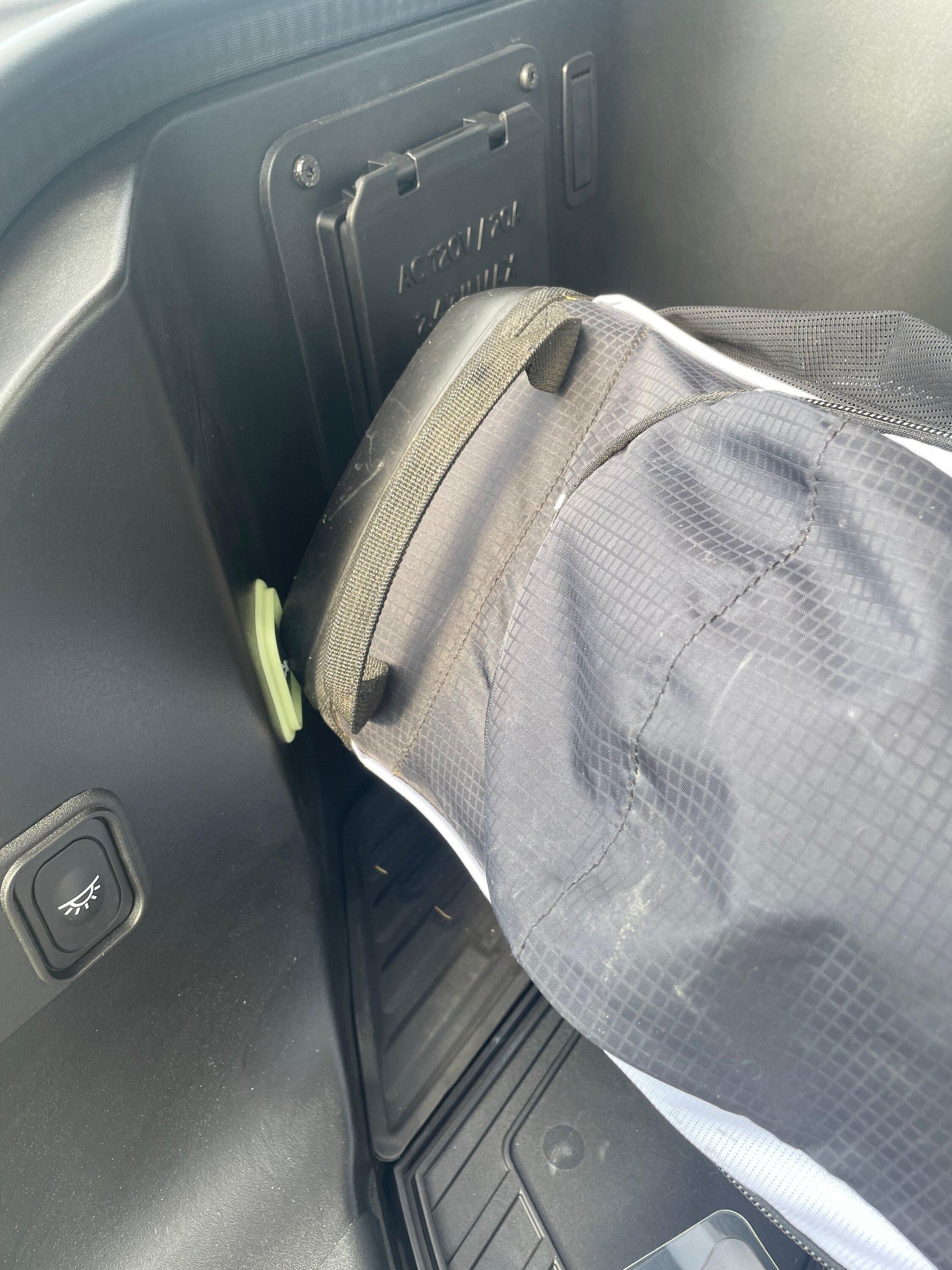

I get the need to analyze this, but it isn’t the first time it’s been documented as happening (https://www.f150lightningforum.com/...frunk-release-activated-on-the-highway.11107/) and won’t be the last. IMHO, it is an occurrence that Ford didn’t anticipate given the hard plastic raised ring designed around the button that they probably thought would protect it from such activations.
Well, I’d say a re-engineered solution is warranted?
The funny thing is they literally tried to reinvent something that has been around for REAR trunks for decades. The solution there was something that can be PULLED, not pushed.
There are a ton on things that can accidentally PUSH that button like luggage and the standard test for trunk size, which is fitting two golf bags. When you think of it, just about anything tall enough to reach that button could potentially push it.

This happened to me twice on Saturday with my golf clubs. I kind of pushed it closed, then pressed the button a bunch of times until it opened.
The button placement just seems bad.
This picture says 1000 words and I'm assuming there will be some sort of recall to put a cover there... just like the power jacks. Other than that it would need to be something twisted or pulled, not pushed.
