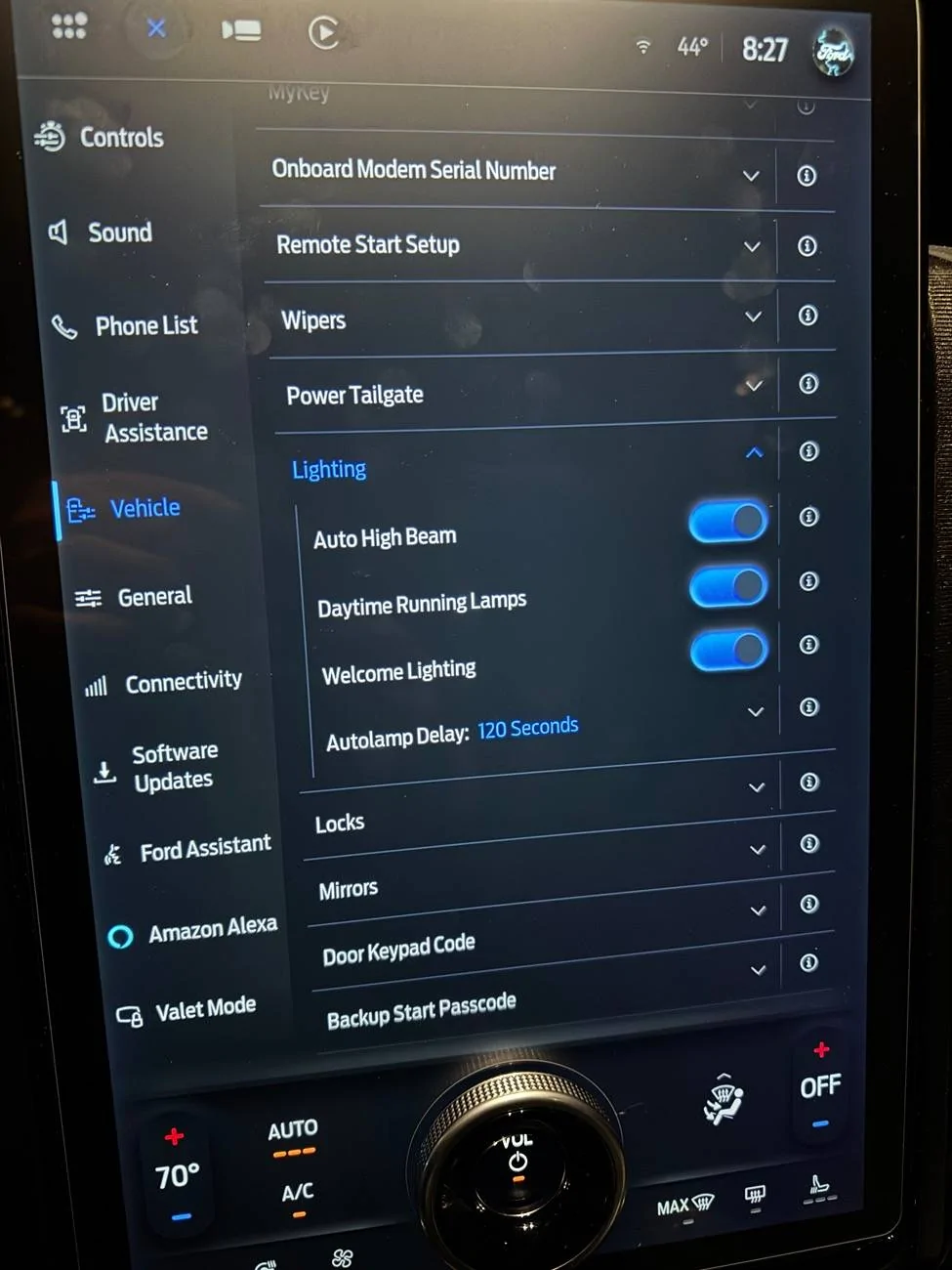

Hi all - new here but been lurking for a bit - bought my ‘23 Lightning Platinum in October, and have been one of the lucky ones where updates started rolling in about 10 days after I purchased the truck. My Lighting menu had the Glare Free toggle from the beginning, and I turned that on. Most recently, got the 10.1.0 update, then 6 days later I got 10.1.1. I noticed that Glare Free is gone from the Lighting menu, but now I have Auto High Beam (which is in the same position as where Glare Free was). Did Ford rename this feature? I ask because I still have the wig-wag headlight animation when I start my truck, I have the green A indicator for the lights, and I still have the adaptive headlight functionality. As far as I can tell, when I approach reflective signs on the highway, they seem to dim a bit, but I also could be imagining things.
Ford F-150 Lightning After 10.1.1 update - Glare Free renamed to Auto High Beam? IMG_3133

No, I bought it new with 26 miles on it - it did have Glare Free where Auto High Beams is located, but at some point, that changed. I’m wondering if anyone else who has not used Forscan and had Glare Free is seeing the same thing.

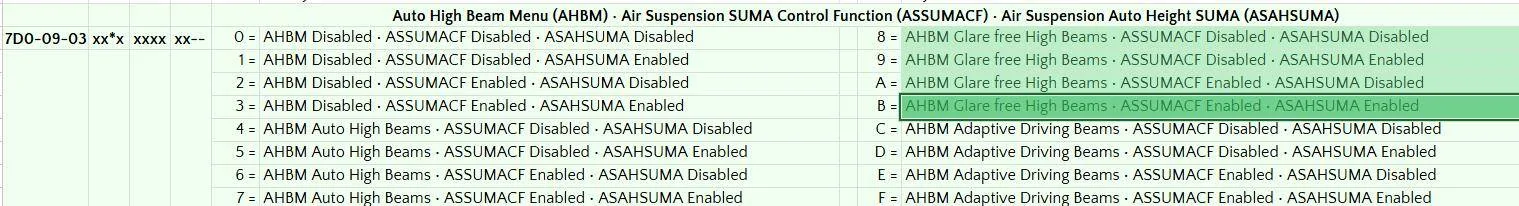

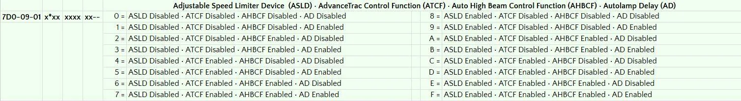

I don't have a good explanation as to why glare free was enabled in your truck without you doing it, but OTA 10.1.0 that comes right before 10.1.1 is an APIM update that could have restored the setting in the touchscreen from glare-free to auto high beams. You would need to re-enable the toggle for it with FORScan.
