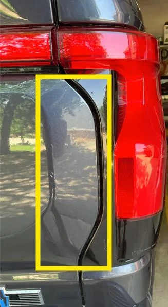

Since you mentioned the light bar I assume you have a lariat or platinum trim? If so the lights are not the standard to ICE. If you open our tail gate you will see additional rear lights on the assembly that are hidden unless tail gate is down. Since the lariat and upmodels reverse lights are typically contained in the tailgate light bar.
The oracle lights look nice but I think it will leave a large gap in the housing if you switch to these. Due to the 'hidden reverse lights'
3,249
4,730
The sides of the Lariat and Plat tailgate are not straight but have a trapezoidal swedge that sticks out and will crush a regular F150 tail light. It’s the part that covers up the reverse lights when the tailgate is up. You need the specific Lightning Lariat light that has the recessed reverse light.
