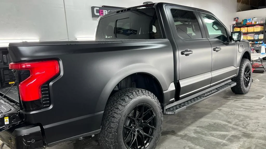

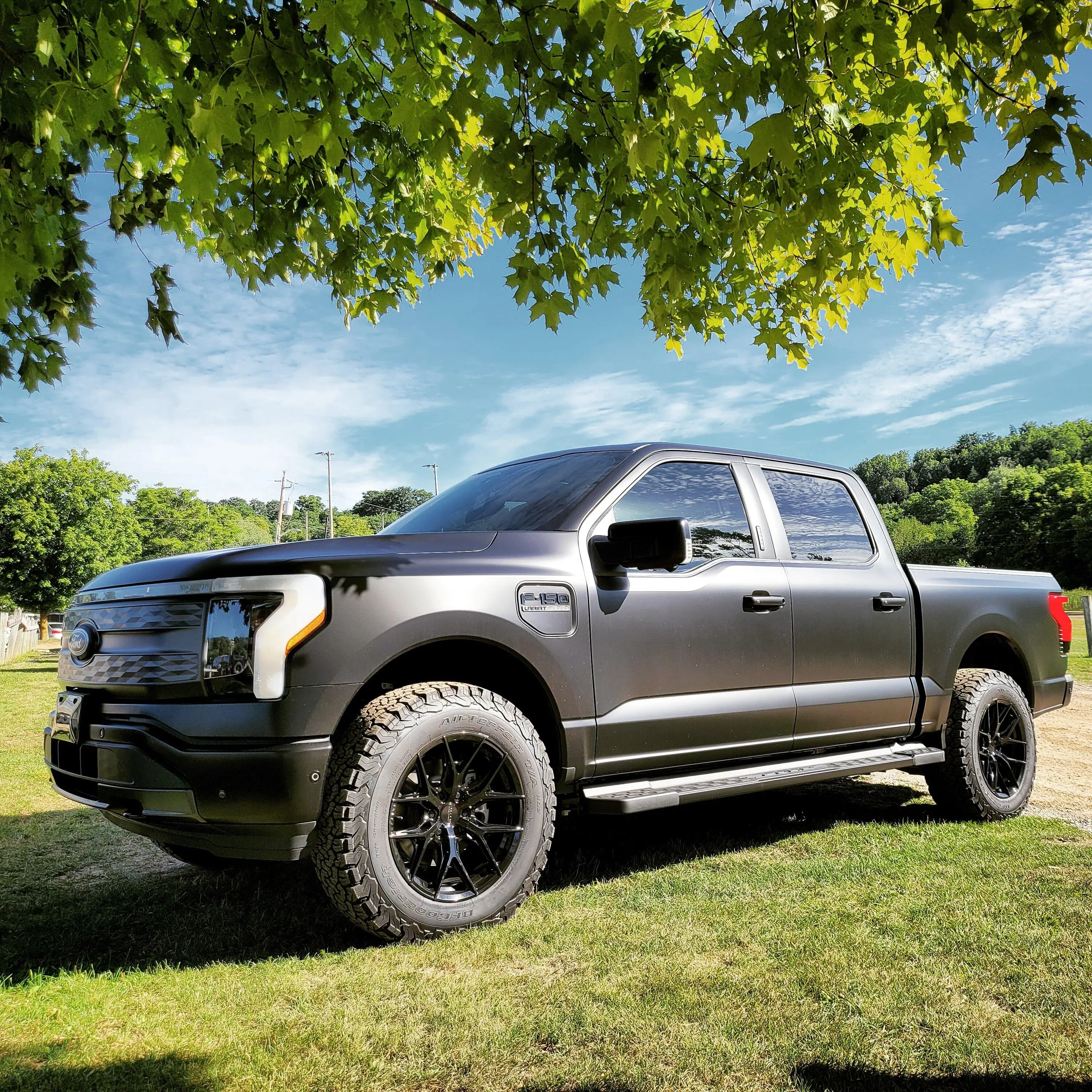

Based on initial research, the Fox shocks were supposed to raise the front 2 inches, but I'm thinking the weight of the Lightning didn't allow that to happen. They are adjustable, but I didn't want to mess around with them, as it comes with the ideal preload setting from Fox out of the box.
Without the full 2 inch lift, I was rubbing on the rim & tire setup I had got. I really wanted the look/size of the 285/65/20 tires, so I opted to go back to OEM suspension with the 2" ReadyLift kit.

I really didn't want to go with a low profile wider tire, as I was trying to minimize the rolling resistance. So I decided to go back to the front OEM suspension and add a lift.
ReadyLift 2" Leveling Kit (66-2120) installed

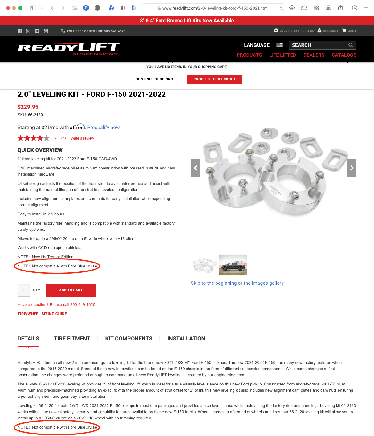

The Readylift website says the 66-2120 kit is "Not compatible with Ford BlueCruise." Is that information accurate and does it affect the Lightning?
We are assuming it’s a liability thing. They want to cover their asses. It’s been used and tested by members here with blue cruise.
BlueCruise has been phenomenal to use! No issues whatsoever with the functionality after the lift!
I also believe it's a liability disclaimer to cover their ass.
