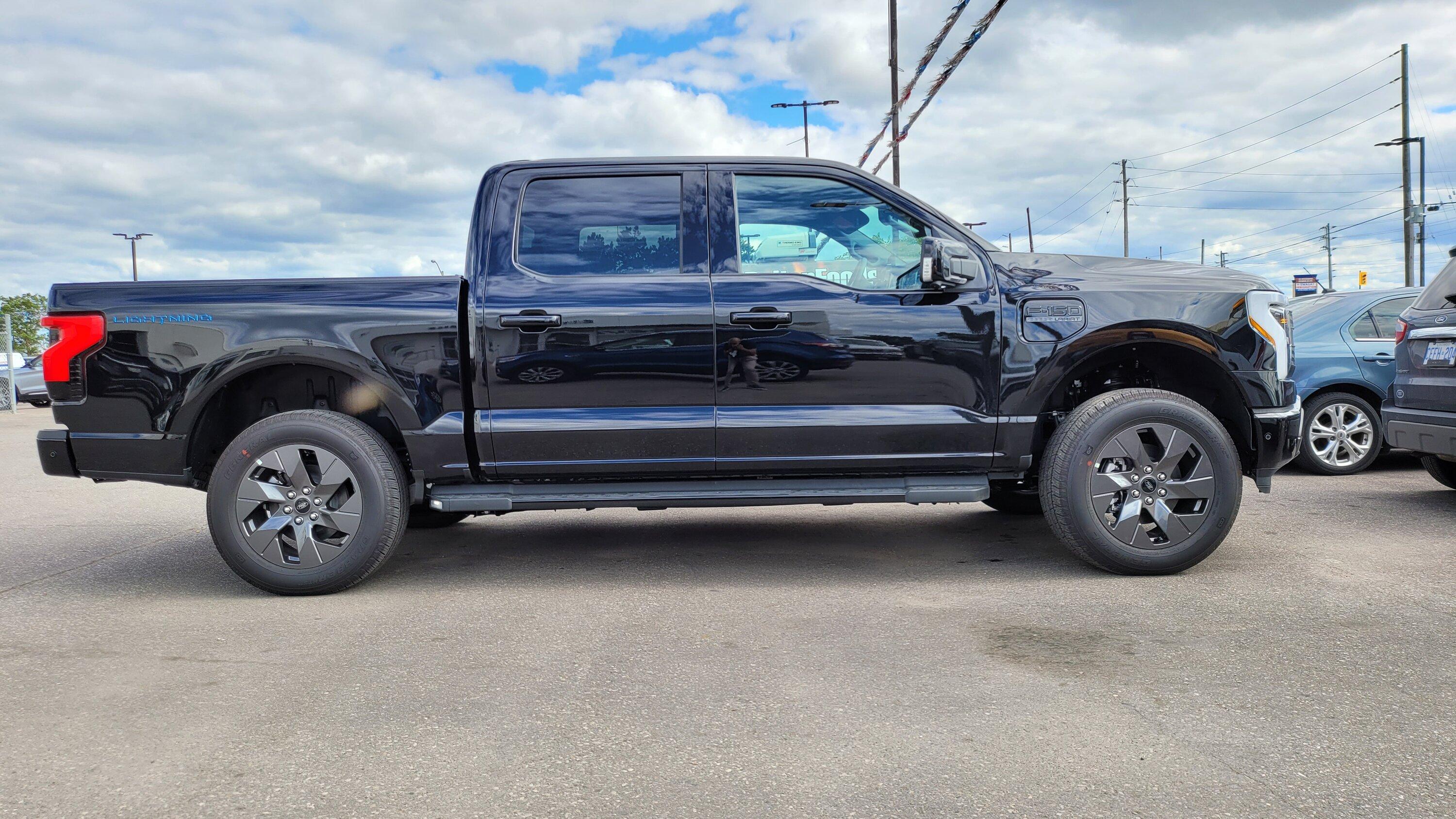

Howdy Y'all! (no we don't actually talk like that) haha
Like many of you, I reserved my Lightning the moment the show started, and I was fortunate enough be given the opportunity by FoMoCo to pay over $100K CAD for a truck! (what a time to be alive)
Mods were planned and ordered well in advance of the truck, so without further ado, here's my journey so far!
Fresh off the boat
Front plate drilled in (after I requested it wasn't smh)
Line-X (thanks Marcus from Line-X Mississauga for squeezing me in the same day I picked up the truck!)
Rydonair 7" Antenna

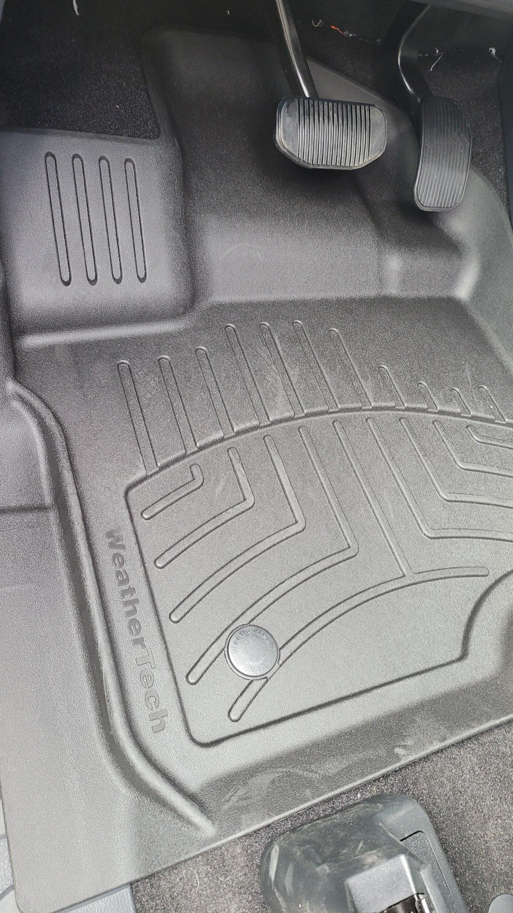

WaetherTech Floor Liner HP (Part Number: 44697-1-6IM)
Centre Console Organizer

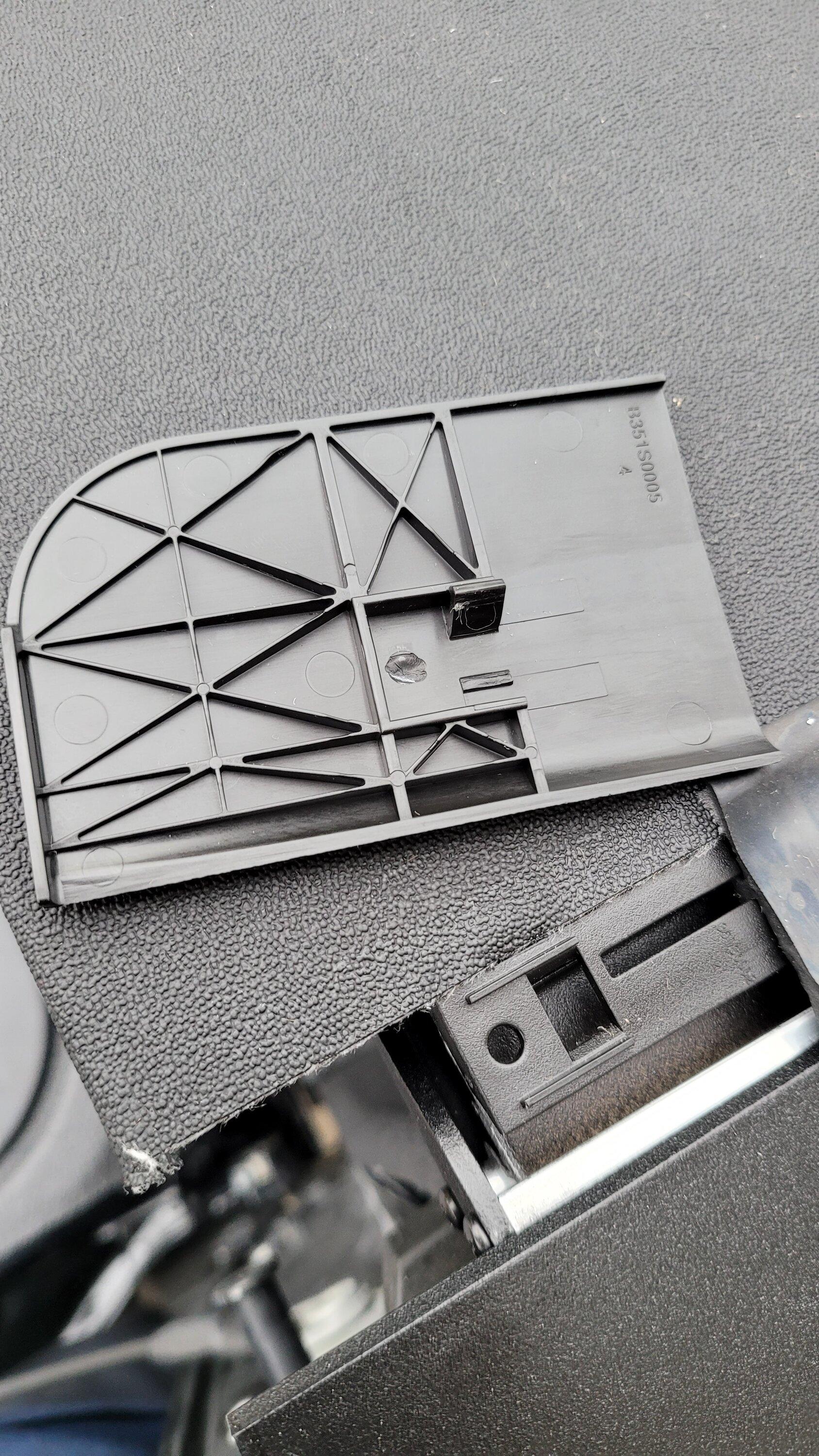

BAK Revolver X4s - 80339 (Clips are as horrible as everyone says they are. 1 came broken out of the box!)

Is there a way to fix the broken clip? Can they ship you a new one?
Sorry I missed this!
I spoke to a local approved retailer, and they said clips could be ordered from them directly. The shop said they would order me a few, so hopefully they come through!
Really hate how it looks with the broken clip - plus water can easily get into the bed ?

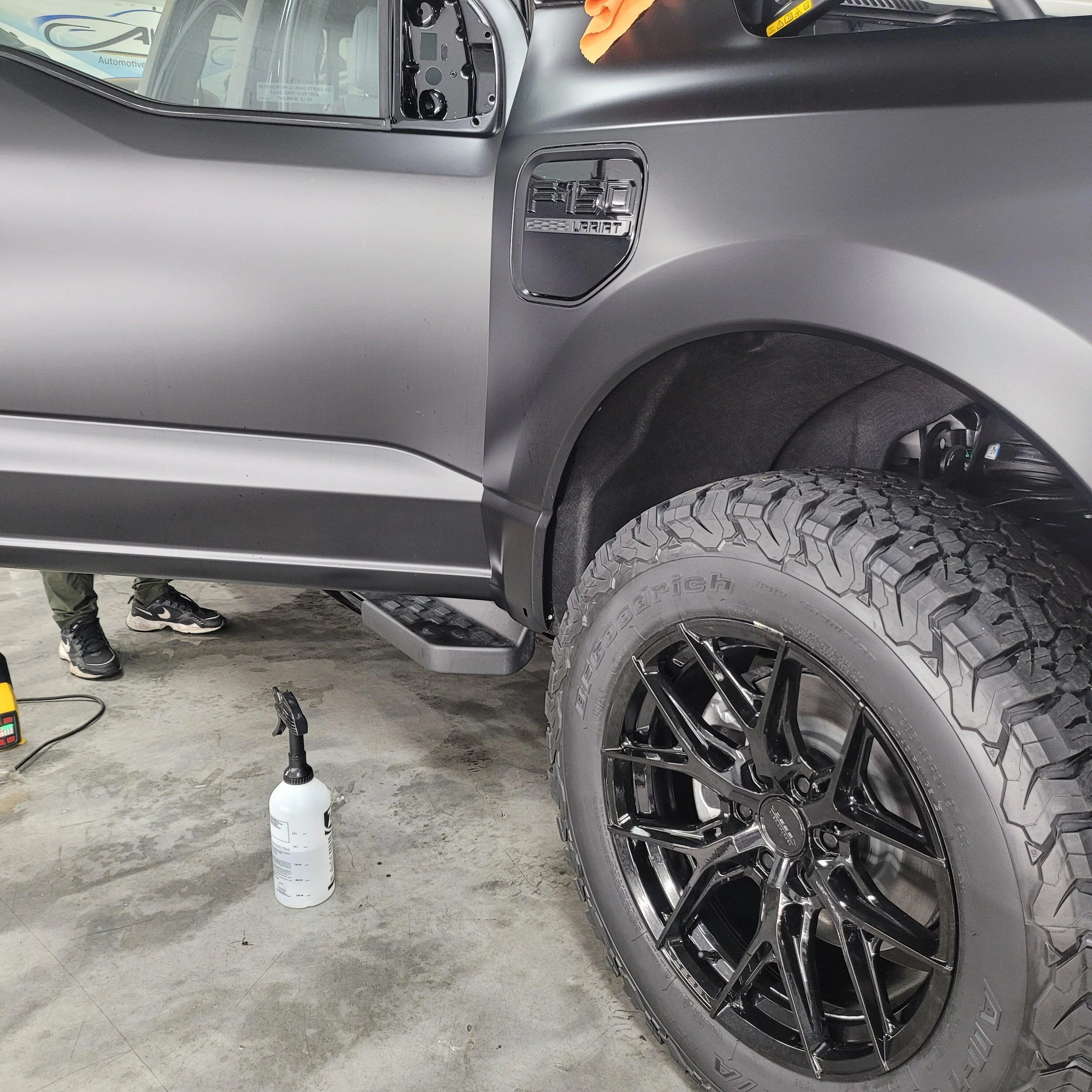

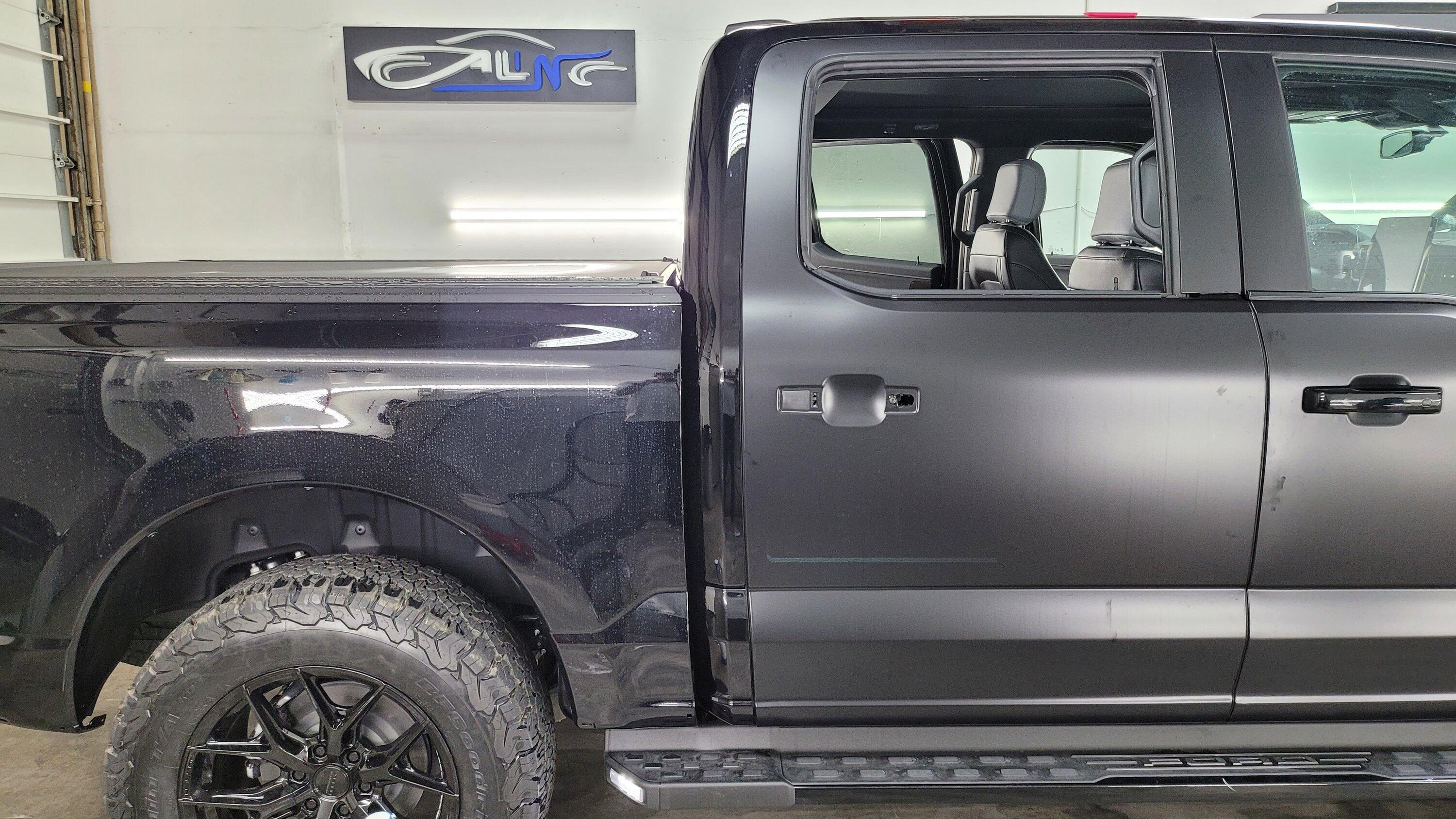

Got some updated pics from my detailer. Hoping to pick it up over the weekend!
Ford F-150 Lightning Agate Black Metallic - Fox Shocks, 2" Lift, 20" Vossen, 285/65/20 BFG KO2, Xpel Stealth PPF, etc 20220802_145100
You can really see the difference here that the xpel stealth ppf makes!

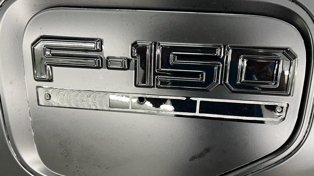

PSA - model designation on the passenger side fuel/gas cover is stuck on with tape AND clips. So if you want to debadge it, you'll have 3 holes to deal with! ?

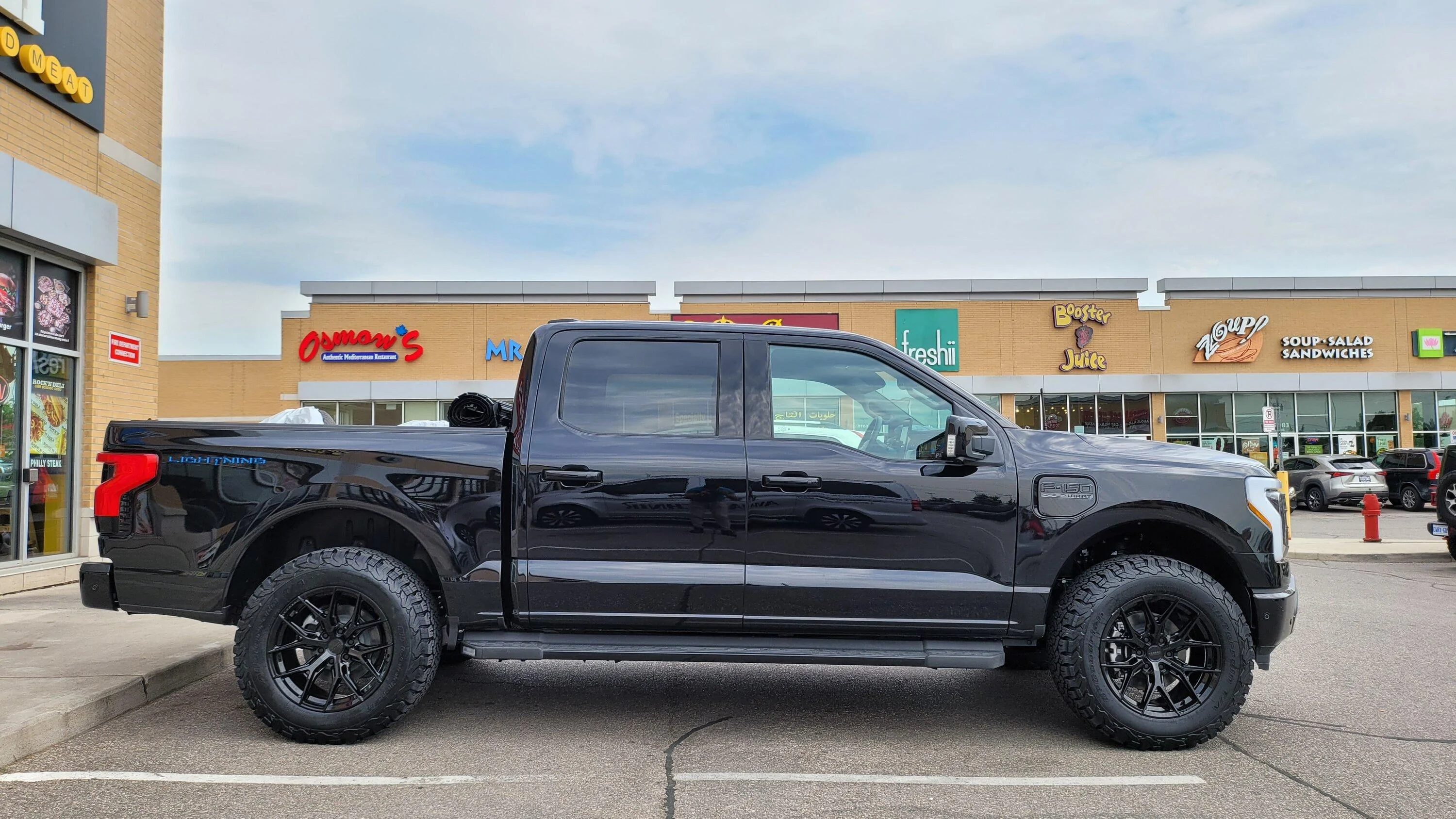

I really didn't want to go with a low profile wider tire, as I was trying to minimize the rolling resistance. So I decided to go back to the front OEM suspension and add a lift.
ReadyLift 2" Leveling Kit (66-2120) installed
Vossen's wrapped in 285/65/20 BFG KO2
A big thanks to Brent and his team at Factory Tire in Etobicoke. They let me test fit the tires, and were ready to take them back if they didn't fit!
If anyone's wondering, this setup clears the crash bar without any issue, and only a slight rub at full lock on the rear liner. Boaty feeling is back, but a small price to pay to make these rims & tires fit!
Just to double check, you pulled the Fox shocks back off and are running the OEM suspension with the readylift spacers?
Any idea if you can run the Fox socks with the readylift kit for the best of both worlds??

This is correct!
The shop said they couldn't get them to line up and work with each other, which is very unfortunate as that was initially my plan.

Thior, I didn't fully grasp why you took off the fox and went to spacers. Did the fox shocks cause you to use an offset and tire size you didn't want to use? I want to get the fox shocks but want to know what's better? I'll probably go for a normal lifted truck with 33 to 34 ish all terrain tires on a 18 or 20 inch wheel.
Based on initial research, the Fox shocks were supposed to raise the front 2 inches, but I'm thinking the weight of the Lightning didn't allow that to happen. They are adjustable, but I didn't want to mess around with them, as it comes with the ideal preload setting from Fox out of the box.
Without the full 2 inch lift, I was rubbing on the rim & tire setup I had got. I really wanted the look/size of the 285/65/20 tires, so I opted to go back to OEM suspension with the 2" ReadyLift kit.
