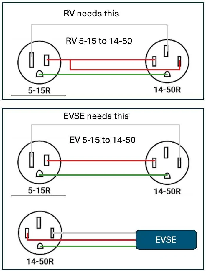

Any thoughts on why this is not working?
I have AMPROAD iFlow P9 EV Charger Level 2 & 1 seen here, and a RVGUARD 50 Amp to 110 Volt RV Adapter NEMA 5-15P to NEMA 14-50R seen here. I'm connecting 14-50P to 14-50R. Should work, right? Yet I have no power on the Amproad screen.
I don't have a 240 volt receptacle to test if the Amproad is the problem.
I don't have a separate electrical device with a 240v plug to test if the RVGuard is the problem.
To be fair the RVGuard says "For RV use only." But should it still work?
Any thoughts? Thanks.

No, it won’t work. It puts the 120V hot wire to both 240V hot slots. Your EVSE sees net zero volts line-to-line.

I think the advertised 120/240v is a mistake on this unit: in other countries this might be correct, but this is really a 240v EVSE module, and cannot perform with only 120v, no matter what adapter you might use.
When you see a NEMA 14-50 MALE plug, you know that you have a 240v EVSE, unless it ALSO comes with a 120v MALE plug of it's own, like our FordMobileCharger. Trying to 'trick' or adapt the 240v EVSE into using 120v power won't work.

I don't think the problem is your Amproad, it's your adapter.
I have that EVSE and had a similar problem at RV Campsites charging it.
You have to buy an adapter specific to EV. For example this: https://a.co/d/fdEQyAd won't work. This one will: https://a.co/d/dkPS4wJ . (Guess how I know...?)
For your 5-15 issue, I bought this adapter (also specified for EV): https://a.co/d/3ietqwH and have had no issues. I've put probably around 400kWh into my truck with that combination of 5-15 adapter and cable.
^^^ This is your problem. You need the 5-15P to 14-50R adapter specifically for EVs not RVs. They are wired differently and cannot be exchanged.
