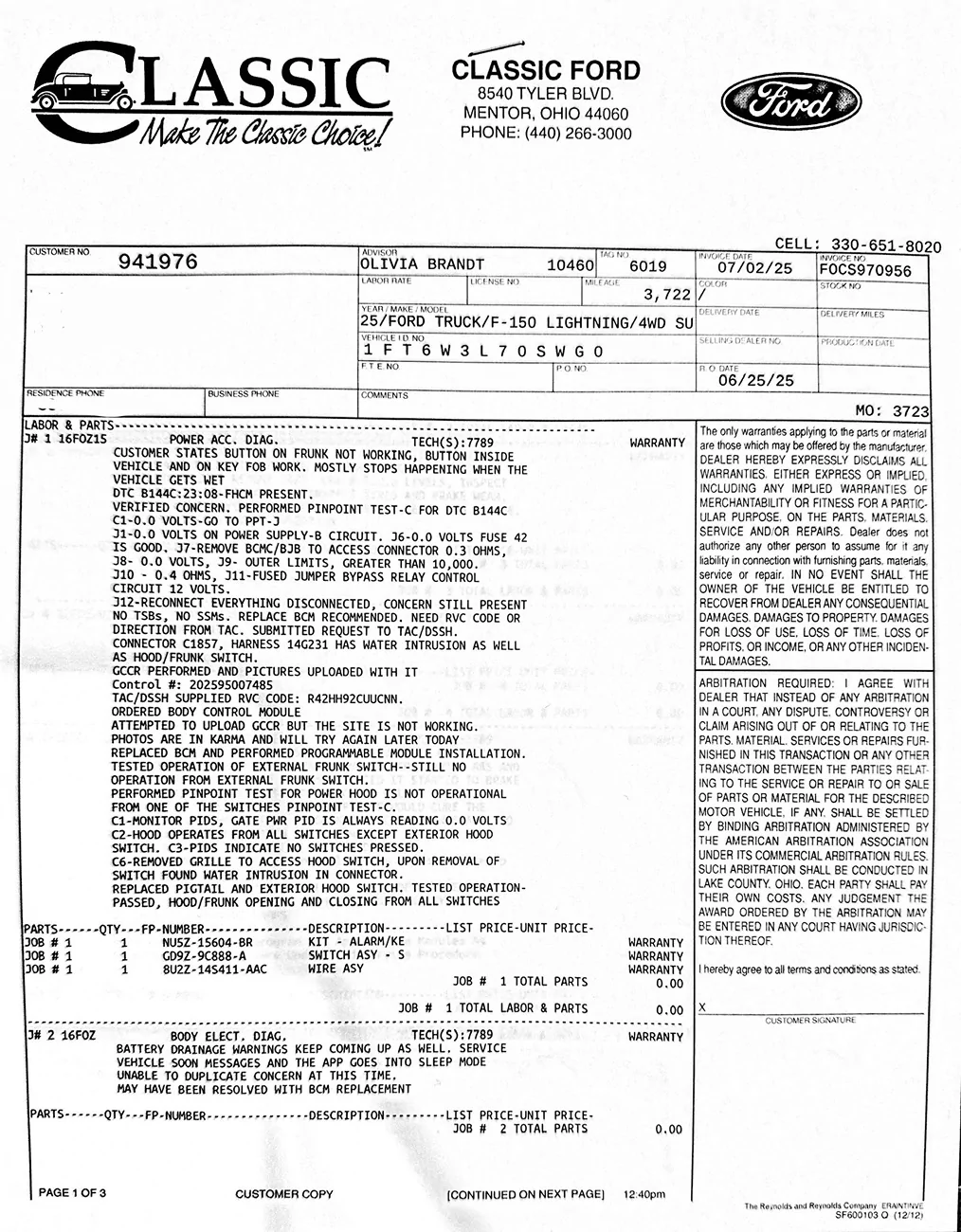

I have this issue combined with high rate of discharge from my 12v battery. Turns out water got in the button and was causing a shot. It was replaced under warranty
Ford F-150 Lightning Anyone else having issues with the Frunk button? IMG_7591

Very useful information! Thank you!
After replacing it, do you get it to work every single time??
It looks like this is a common issue, hoping they do a recall about it.

I’ve had zero issues since. Not sure how common it is though. I’d say, if there hasn’t been a recall for the shifter, there’s definitely not gonna be a recall for the button.🤣
