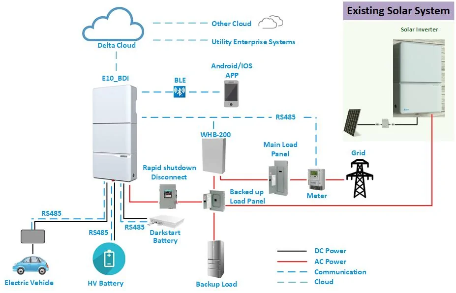

@tearitupsports seemed to imply in the following post: https://www.f150lightningforum.com/...uit-home-integration-system.21562/post-458792 that the Delta inverter can feed solar power to the truck through the DC ports in the FCSP charger head used in backup power transfer. I'm a dummy compared to him, but I was wondering, especially based on comments by @Maquis in this thread, whether that's a "safe" thing to do?
Yes, the Ford HIS is fully bi-directional and that functionality is fully supported. I will attach an image from the manual below, but the inverter can go DC->AC from the truck and AC->DC to the truck while in off-grid mode. I have tested this for hours, and the M-professional app even shows animated power flow going into the truck when I have excess solar. While not advertised by Ford, it is fully supported by Delta. My setup is just like the picture below.
That being said, it is the only system that will work right now with the Lightning because as others pointed out, there is no standard officially ratified yet. People can't even agree if the home backup should be DC (external inverter) or AC (internal vehicle inverter).
For reference, the GM Energy system for the Silverado and their other vehicles is the exact same Delta hardware as the Ford system. The difference between the two systems is the vehicle itself and the charger and how they interface. The GM seems to be much better.
The next gen Ford home system is being built by a very reputable inverter brand and will have whole system support. Unfortunately it is being designed around NACS and wont work with our current trucks. Hopefully they will figure out a way to make a current truck interface or something.
I guess the part that I don't get is that if grid power is out, then isn't backup transfer power from the truck on? Then the idea must be, since the truck contacts are closed to have current flow from the truck's HVB battery, but the current demand in the backup load isn't that great, and the solar panels are providing excess AC power to the Delta BDI, the Delta inverter will be able to make so much DC power from the solar AC conversion that that DC power will flow out of the inverter into the truck. And since the truck can accept up to 150 kW from DCFC, there would be little danger of providing too much DC power from the Delta inverter via solar.
tearitupsports
Russell
Jun 1, 2024
376
362
Houston, TX
That is correct. When I did my tests it was in the morning and my excess solar was about 1.5kW. Not much more than level 1 charging.
