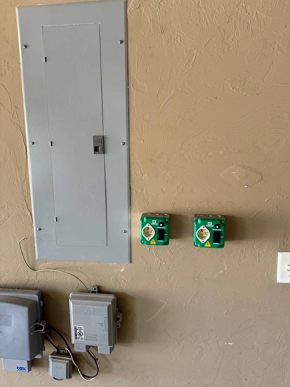

I added two 120V neutral switching transfer switches (I don’t have the bed 240V). I paid $300 to have the pair installed, and $700 EVSE install.
One powers my NG furnace, and the second does the master bedroom + living room TV + fridge via extension cord
https://ezgeneratorswitch.com/

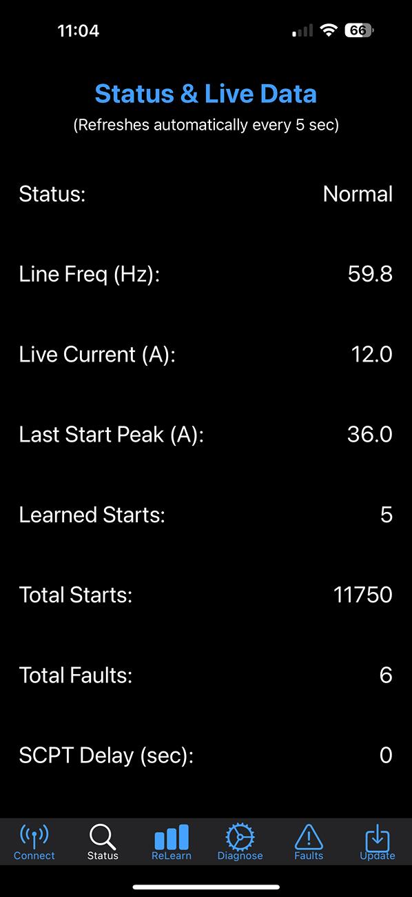

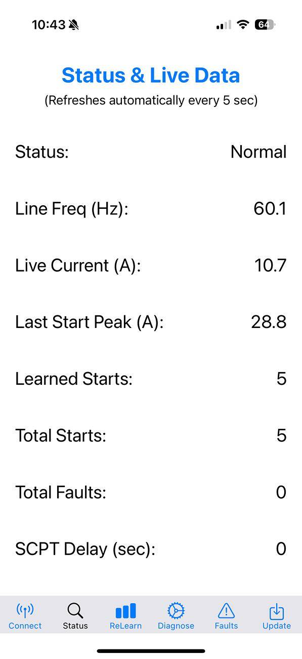

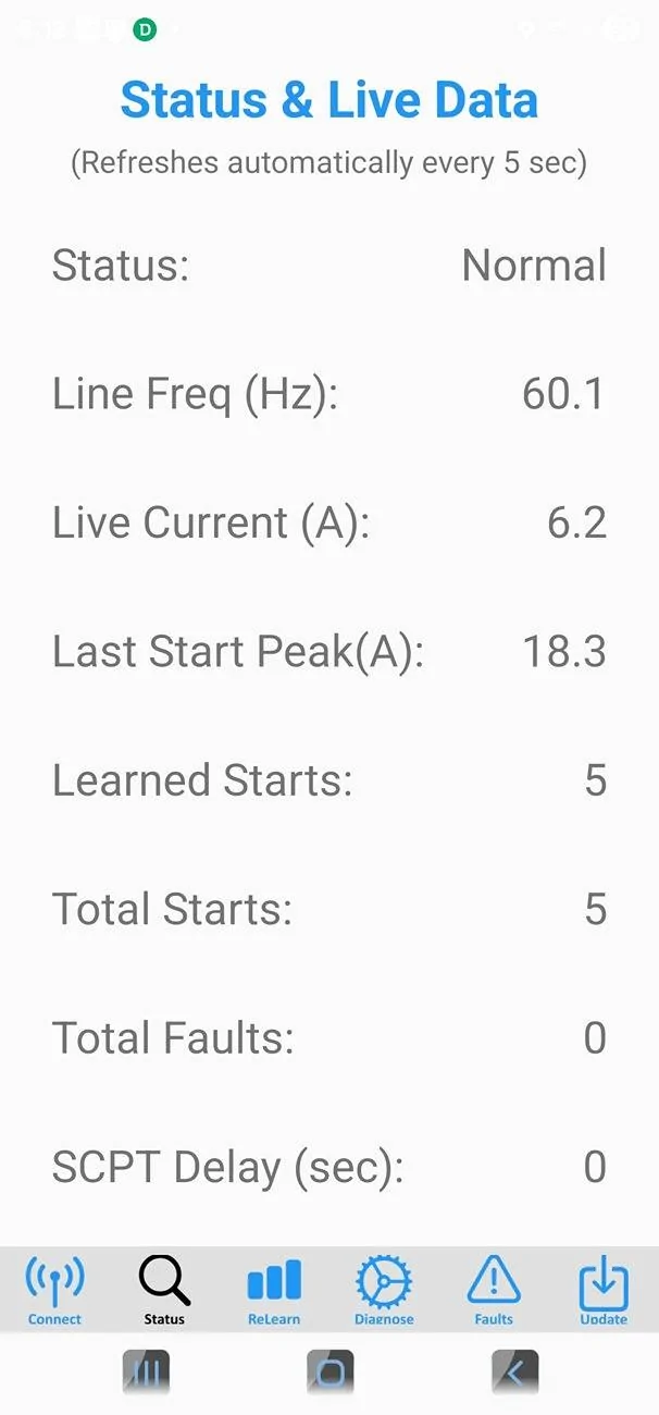

I just installed the Micro-Air Flex SoftStart unit onto my AC compressor and it works like a charm! It took about 30 minutes, and 25 minutes was finding a place to put the unit and securing it.
Thanks. $400 well spent. :clap:
Oh, I forgot to mention...
During the after-installation backup test, the Lightning ran the whole house AND the AC, flawlessly! I turned the AC on several times during a 15 minute test while plugged into the Lightning. It ran both refrigerators, I had many lights on, 2 TVs, router and everything that usually runs on a typical day at my home, and had zero issues. I can't wait for another power outage! :) ???
3,761
4,832
I have a 5 ton unit with a LRA of 185A. It has now dropped to 30A and I can run it with my PointGuard system as part of the whole home backup.

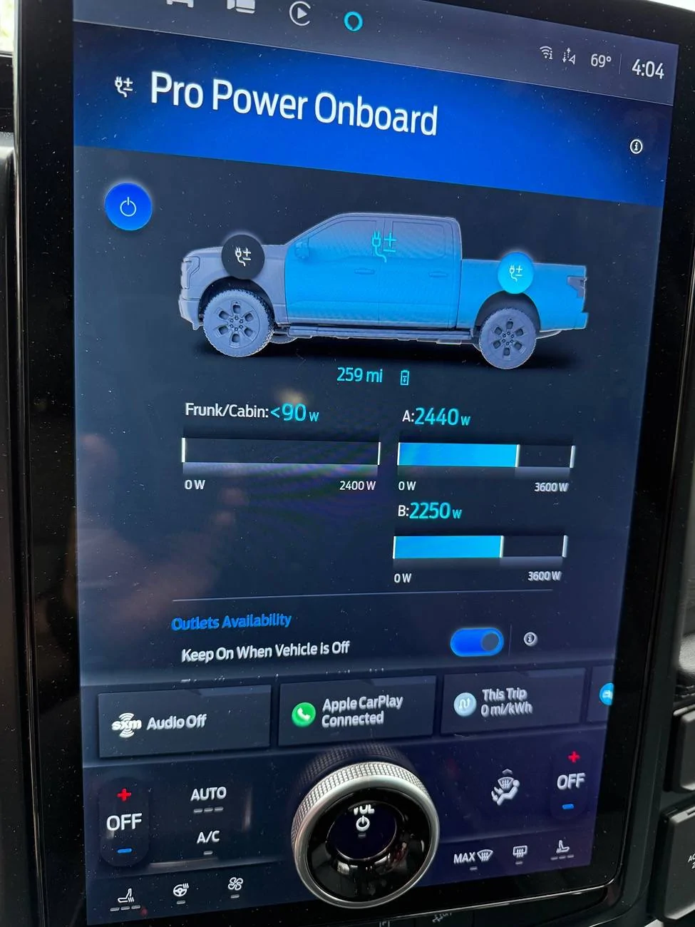

Hey folks!! It took me a while to get my home power situation figured out, but yesterday, I was able to use Option E - hooking the Pro Power Onboard to a generator inlet. I thought it might be useful to share that experience, so here goes!
We are having solar installed, so it was a good time to address using the Lightning. I had already decided against SunRun because I already have an EV charger (non-Ford) and I already had 14 solar panels.
What we added is another dozen or so panels, but this time with a Tesla Gateway and two PowerWall batteries. All of that was in the range of double what SunRun would've cost, but i would only have gotten the Ford integration. Anyway, decided to go with a more typical solar system and use the Lightning as a backup to the backup.
So, what we had done was very, very simple. A generator inlet leads to a breaker in the main panel. That breaker has an interlock so that the main must be shut off to use the generator inlet. Bought a 25-ft generator cord, which goes from the Lightning to the inlet.
Immediately got the ground fault when all this was hooked up. But, in other threads on this forum, it was suggested to remove the ground pin. My electrician thought about that for a few minutes and decided it was safe and reasonable. That made everything work!
I was able to watch the Pro Power screen and see the wattage draw in realtime as we switched things on in the main panel.
Frankly, I do not know if it is code compliant, but, my electrician felt it was perfectly safe. He even pointed out that the Tesla Gateway works the same way, in that it has no earth ground and relies upon the main panel to provide a ground. He reasoned that the Lightning is acting as the Tesla Gateway when I use it.
Do note, this is not an automated solution. I will have to flip breakers to use the truck and I may have to turn off the Tesla Gateway. We are awaiting the inspector before I can really jump in and play with it.

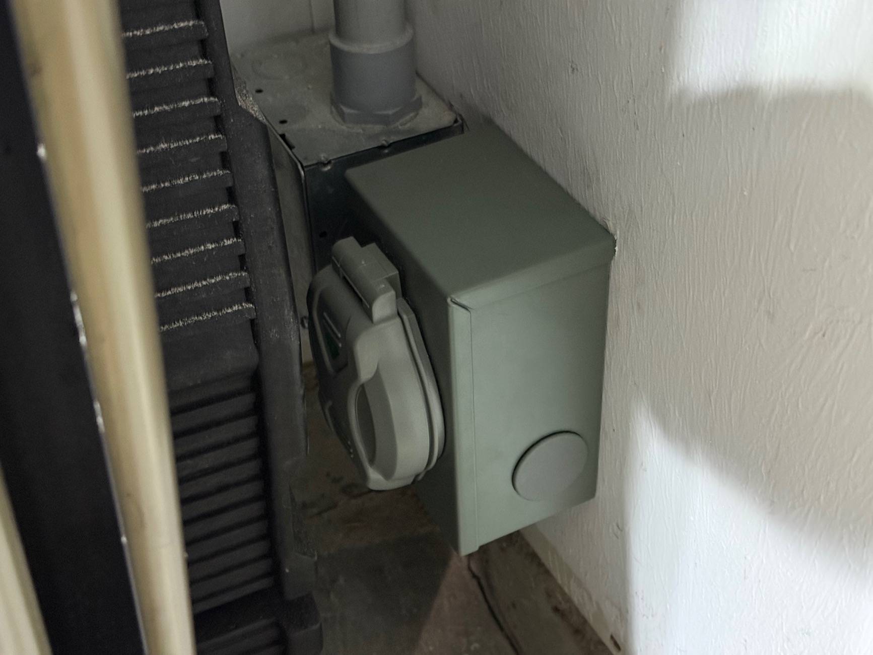

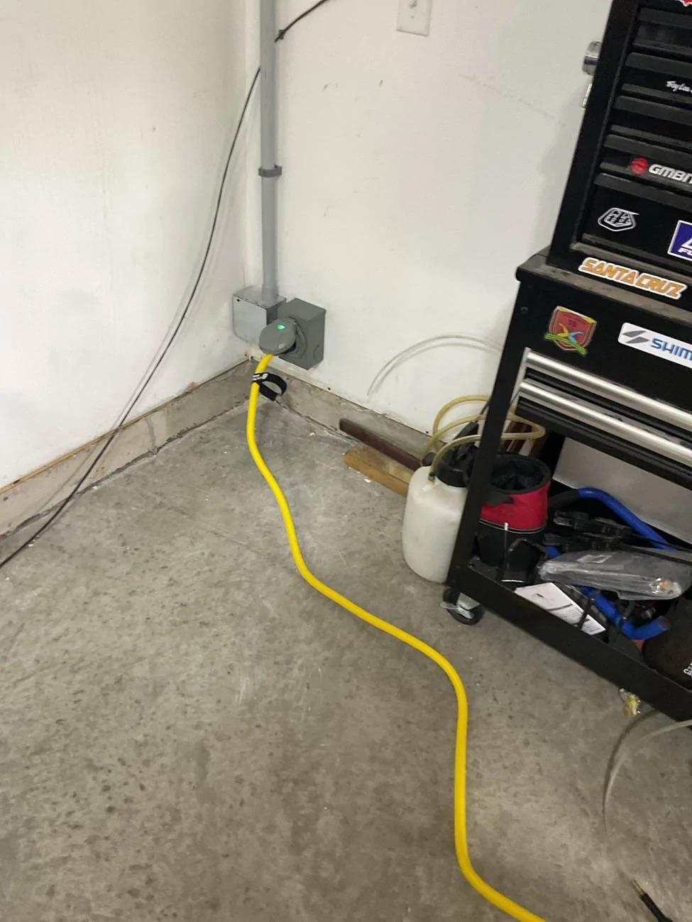

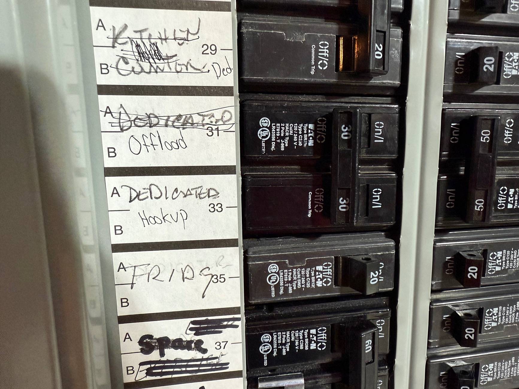

Chose option E and had it installed today. Works like a dream!
