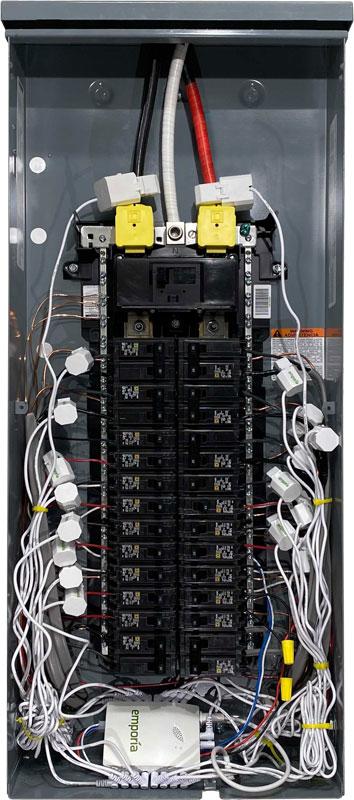

ha, yes, and then try adding an Emporia energy monitor if you really want a second serving of spaghetti!
https://www.emporiaenergy.com/how-the-vue-energy-monitor-works
Heard about them from sisters lifetime friend who started the CO company. Got one of these with idea I'd monitor things for a few months to see real usage but time flies and we'll have to make decision without. Installers probably won't appreciate all that extra wiring while they are moving circuits, ;) so I'll wait until they are done. Have a 10% off coupon owner gave me if you are interested - DIYSOLAR
They also have AC plugs that can be put in anywhere that communicate with box so you can more granular pin down phantom usage and plot on the same app. Samples every minute I believe. With the gigantic increase in electricity costs recently it really pays to understand where the waste is.
If anyone is looking at buying one of these, I think they are far more useful than something like the Sense, which in theory sounds great but in practice sounds like it really fails/struggles at identifying the loads. I went with the iotawatt, which looks like it is going to be similar to the monitor mentioned above where you put CTs on each circuit you want to monitor.

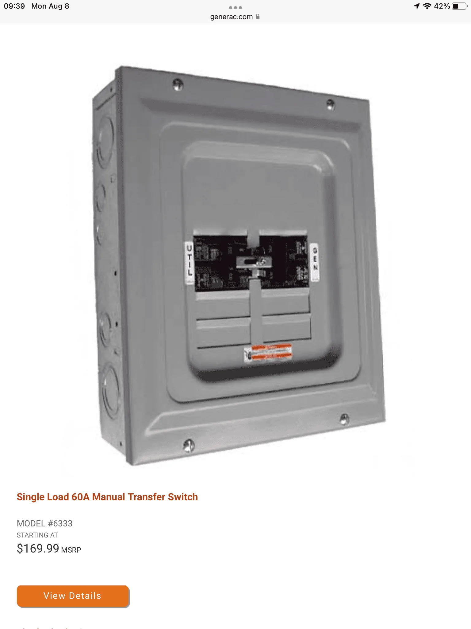

Well, that me….average ??….and may explain why my current generator hasn’t been an issue, no integral GFIC on its 240V. So, my understanding is the truck’s GFIC is what may be the hang up….and, begs a follow up questio: Is there a reasonable ans safe solution for a temp supply from the truck without having to install a Generac or other brand manual transfer switch?
https://www.generac.com/generaccorp...all-guidelines-6333_6334.pdf?ext=.pdf#page=11
Ford F-150 Lightning Backup Power A8AB4195-9013-4DE1-98FD-61844EB56D4B
4,434
5,959
Either a transfer switch or breaker interlock kit is required by the NEC to make it physically impossible for you to backfeed the grid.
