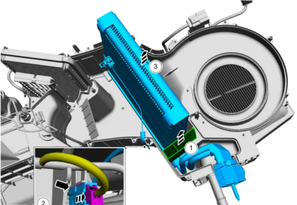

If you're looking at evaporator cool cleaning, I've been pondering using HVAC evaporator coil cleaners to clean the Lightning's coils. If you and I are talking about the same thing, the evaporator coils are easily seen from the front vents. My plan was to take some of that foamy spray can evaporator coil cleaner and spray it up onto the evaporator coil.

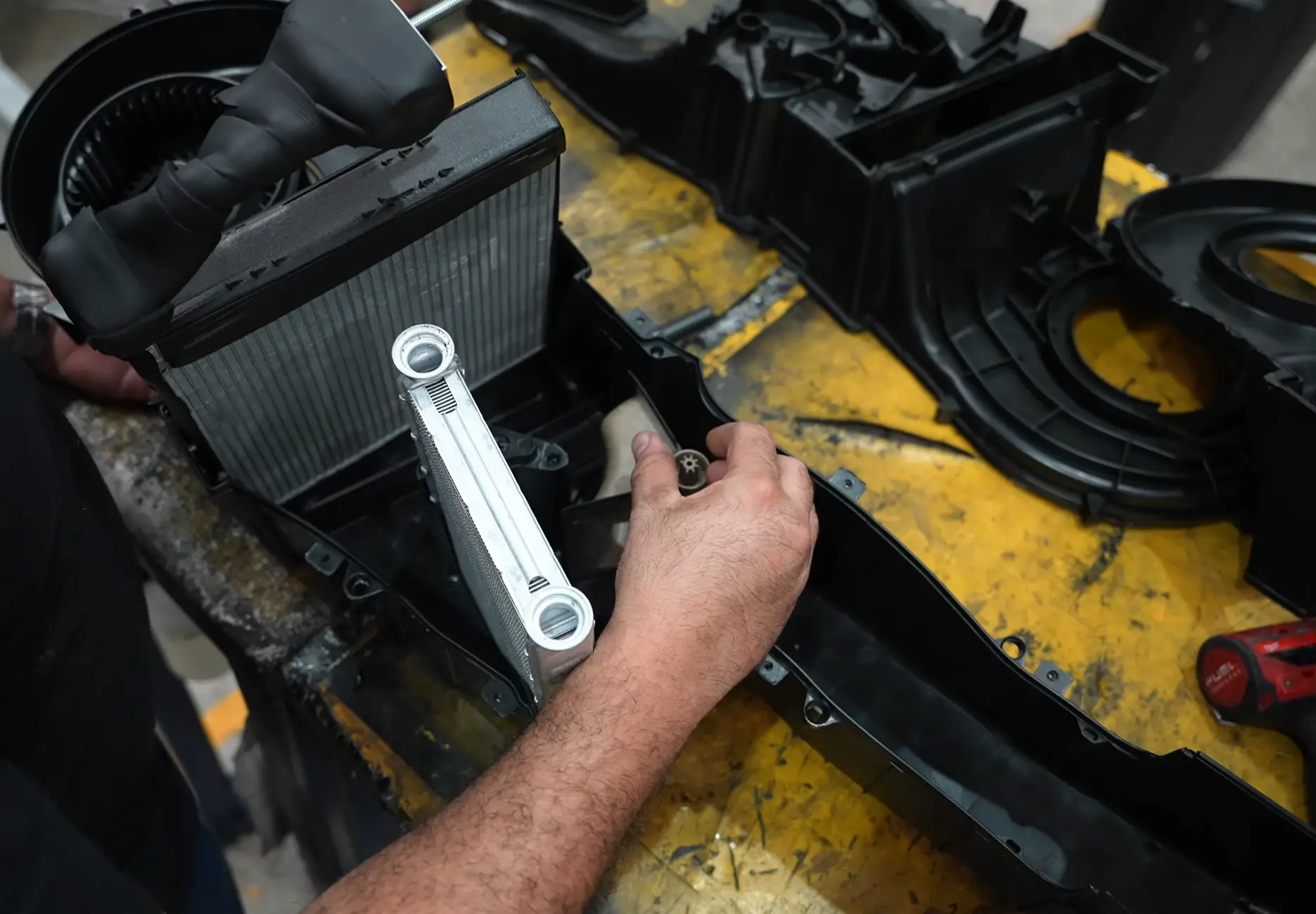

Lightning Blower, Evap Coil, Heater Coil - HVAC system in RHD Ford F-150 Lightning Explained
Looks like a mirror of our LHD. Looks easy to get some kind of buildup.
LHD Evap Coil
You have helped me understand the nature of the beast. Great information and great YouTube video that explains in detail how the HVAC works in a Lightning.
I tried to use a borescope to see the evaporator through the filter slot and squirrel-cage fan, but the tolerances were too tight. The blend doors get in the way wen you try to go through the dash vents. I guess I could turn on the A/C, and maybe get through the blend doors. I don't want to get my borescope hung.
