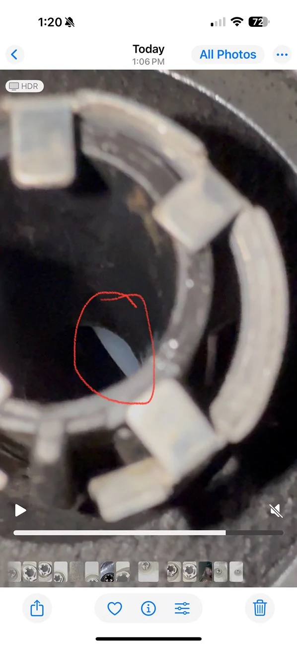

I need some help.
I was doing my quarterly Kool It spray in the AC drain and the footlong hose disconnected from the bottle and shot up into the drain.
I tried sucking it out with a shop vac. I tried making a hook on the end of a footlong piece of wire. It looks like the hose is caught on a ledge about one inch side the drain. See photo.
Any ideas on a way to get the hose out?

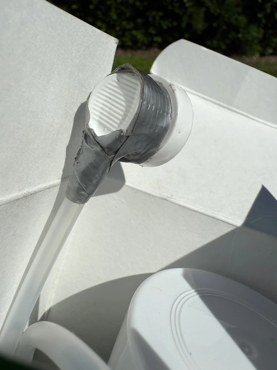

Nevermind. I was able to get it out with a hook I made out of an irrigation flag wire. Now I will duct tape the hose to the lid going forward.
