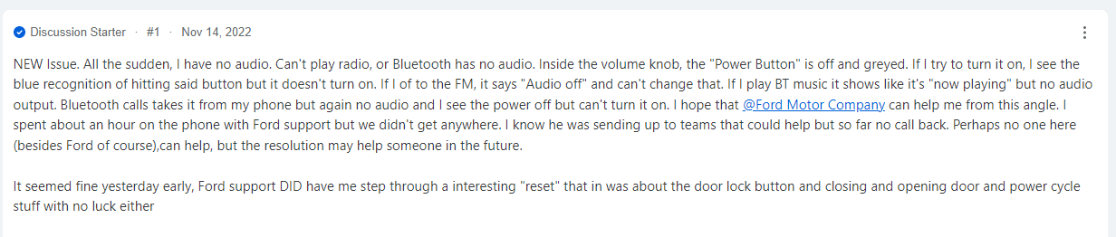

Searched here but didn't find anything, however did find a thread on another Lightning forum which describes my exact issue. Randomly the other day the "audio system" won't turn on AT ALL. I press the power button in the center of the on-screen dial, it radiates blue to acknowledge my touch, and then nothing. No sound at all. No radio, no bluetooth, no Android Auto. I've tried doing the Sync reset (volume down/right seek for 10 seconds), pulled fuses 28 and 32, called Ford and they had me do an open door/lock the locks "reset" of some kind, AND tried to do a FULL reset by pulling the negative lead off the 12v battery - none of which have helped. In combination with this audio-won't-turn-on issue, I also noticed my the onboard Nav/GPS is WAY off, like not even in the same state. And then I noticed today after the 12v battery reset, the on screen time/clock is wrong, even though I double checked the "auto clock update" setting is in fact on.
Anyone else?

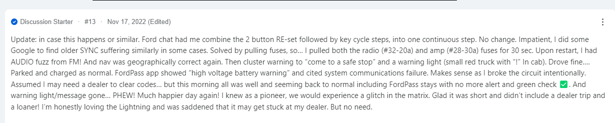

EDIT: despite the similarity to that other post, turns out my issue was the wife spilling coffee on the dash behind the screen... enough to leak down behind and fry the Audio Control Module...

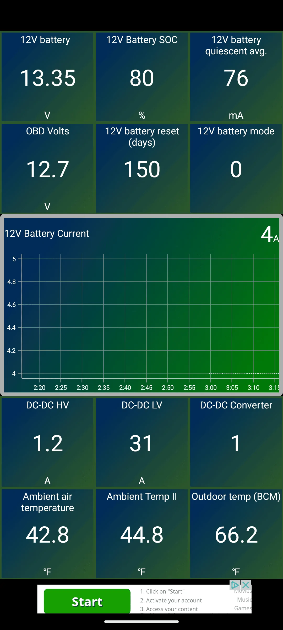

12v battery appears to be reporting OK, however I haven't verified with a voltage meter.

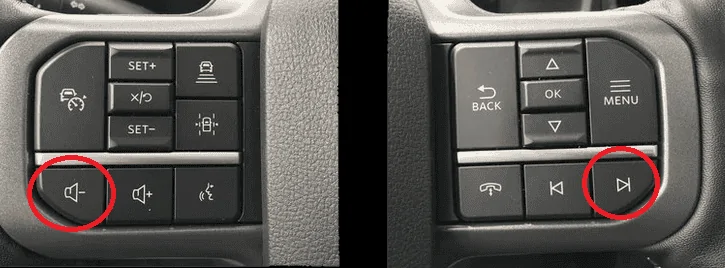

Any updates on this thread? My wife just got out of our Lightning and the radio won't turn off. It's stuck on and the clock is frozen to when she turned the car off. She's tried everything to get it fixed. I'm at work and can't do anything about it right now.
2,619
3,697
Did she try a Sync reboot?
With the truck on, hold the Volume Down and Next Track buttons at the same time on the steering wheel until Sync reboots. These are the two buttons on far left and right.
I found the above reboot process online and sent it to her. She did it and it did resolve the problem. Very odd, but good to know this is an F-150 issue and not unique to the Lightning.
