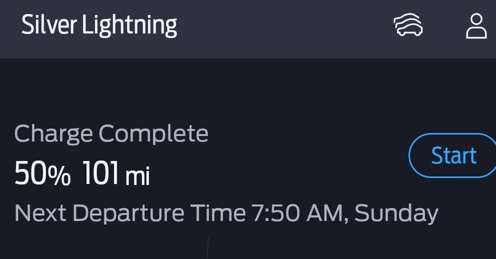

For the hell of it, I scheduled a regular departure time session last night for this mornings local trips, mostly did this because I intend to restore the entire weeks worth of drive energy this afternoon when we're done traveling.
The actual get out of the house time is 8am
I programmed a 7:50 departure time knowing that it kicks into cabin prep five minutes prior and normally runs a full 15 minutes based on my 15 minute remote start specifications (you have choices for 5, 10 or 15 minutes, set and forget)
The pack SOC was at 50% after the end of yesterdays driving, my forced limit was 50% no charging needed or occured, nothing happened last evening when I plugged in, sensed the current SOC and clicked to standby. (I have not time constraints)

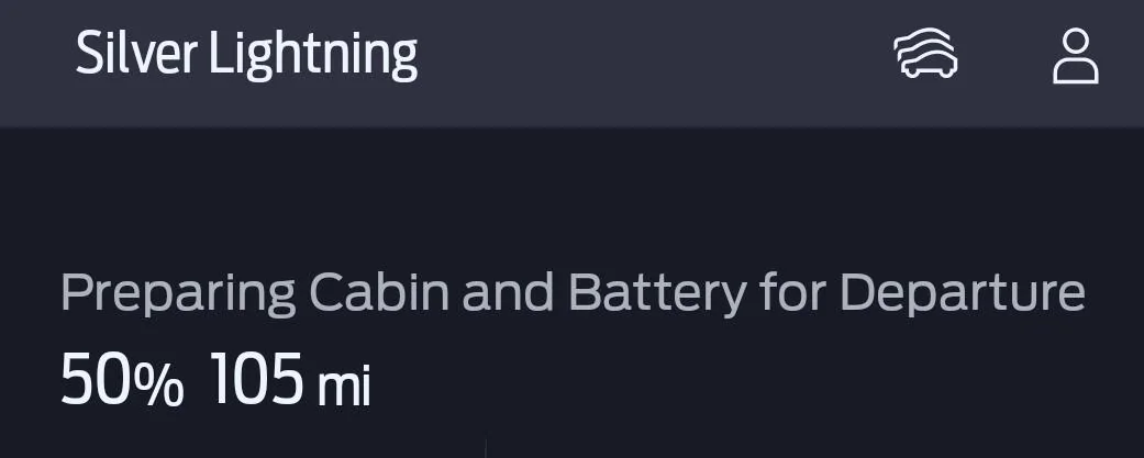

This morning the trucks BMS decide it was cold enough that it needed to start the battery prep phase at 6:59, note that only battery prep is actually occuring, this snapshot was at 7:09, warming is improving estimated miles to go
Ford F-150 Lightning Battery level after setting a departure time 1736733560798-yy

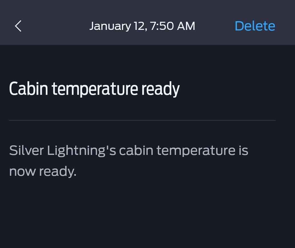

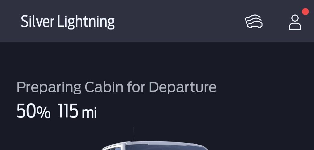

At 0745 the cabin prep has started, HVB has reached optimum efficiency, the notification says it's ready after only 5 minutes cabin prep, but I'm letting it run until 8:00
Ford F-150 Lightning Battery level after setting a departure time 1736734101874-fu
Ford F-150 Lightning Battery level after setting a departure time 1736734068164-kx

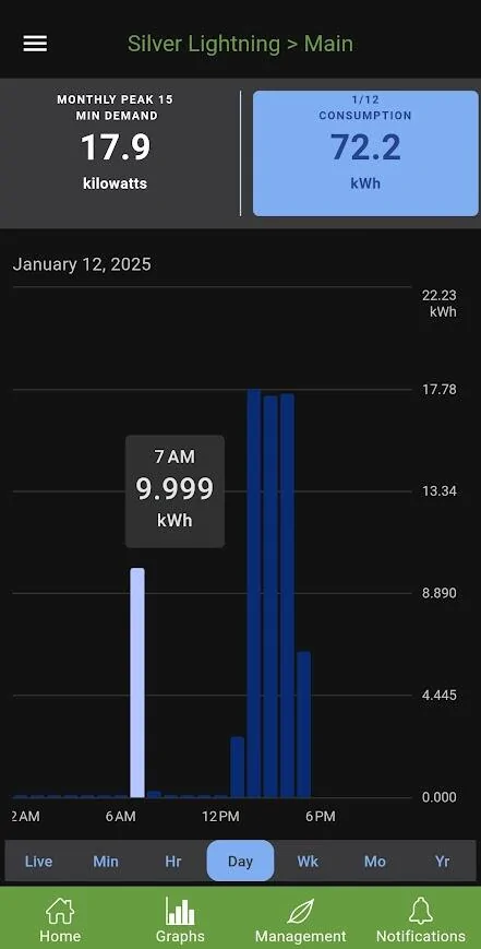

This is what Emporia recorded for energy flow, take note that the SOC hasn't gone up for the 64 minutes the session was running, the estimated range has improved to 115 miles. I used 8 kWh to warm the battery and about 2 kWh to warm the cabin.
Ford F-150 Lightning Battery level after setting a departure time 1736733720353-cw

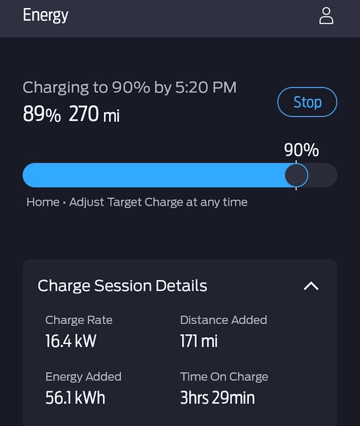

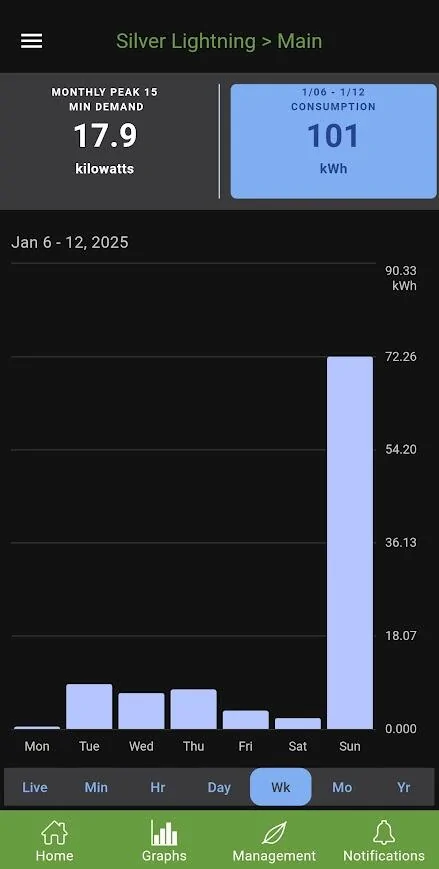

This is the evening charging session and recap of the days energy consumption.
Ford F-150 Lightning Battery level after setting a departure time 1736734314223-eq
Ford F-150 Lightning Battery level after setting a departure time 1736734346754-m7
Ford F-150 Lightning Battery level after setting a departure time 1736734365783-he
Recap of the entire weeks energy consumption, spontaneous battery conditioning, on the plug morning remote start, and todays activities. It was an expensive week for only 65 miles of local driving. $35.68 or 54.9 cents a mile with an effective total energy MPK of 0.6 !!

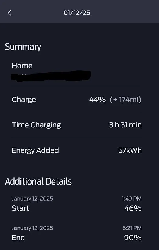

The benefit of this mornings battery preparation is that the bulk weekly charging was not impeded by a cold battery needed pre-charge conditioning, the latent heat from the morning was still in the pack, this afternoon wasn't brutally cold. The end of drive day SOC was 46%, the goal was 90%, the active charging session on Fordpass showed 56.6 kWh before it disappeared, the record rounded it to 57 kWh, noted above. The FCSP log and Emporia log were w/i 2%, conversion losses was 9%
