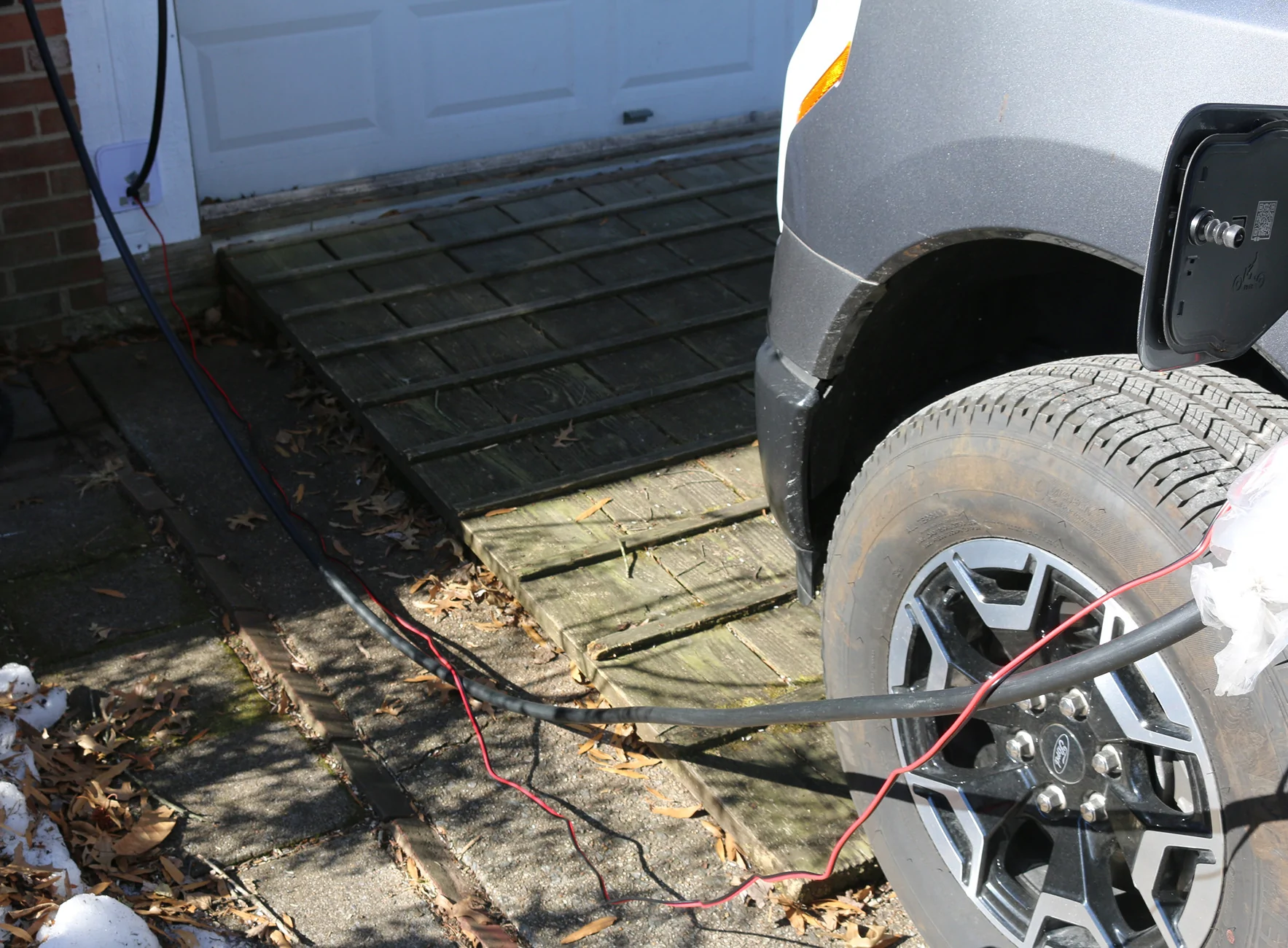

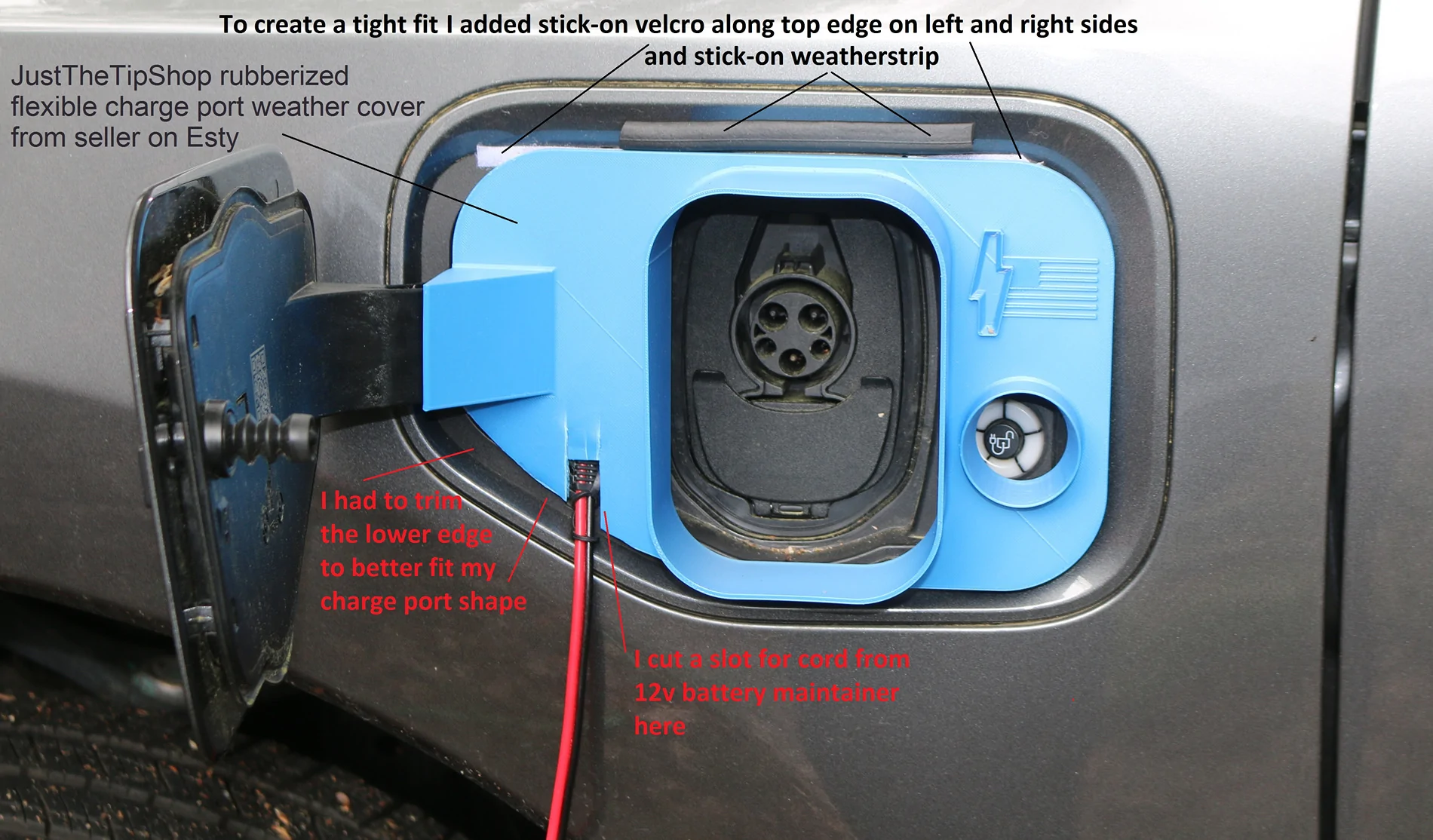

Yes, many of us have. Search the forum to see one of the several threads here about putting trickle charger/maintainers on the battery and how to make it easier by adding a charger wire:
https://www.f150lightningforum.com/forum/threads/charging-12v-battery.16979/
Here is what I did - an SAE plug at the charge port, on a fused wire to the battery compartment.

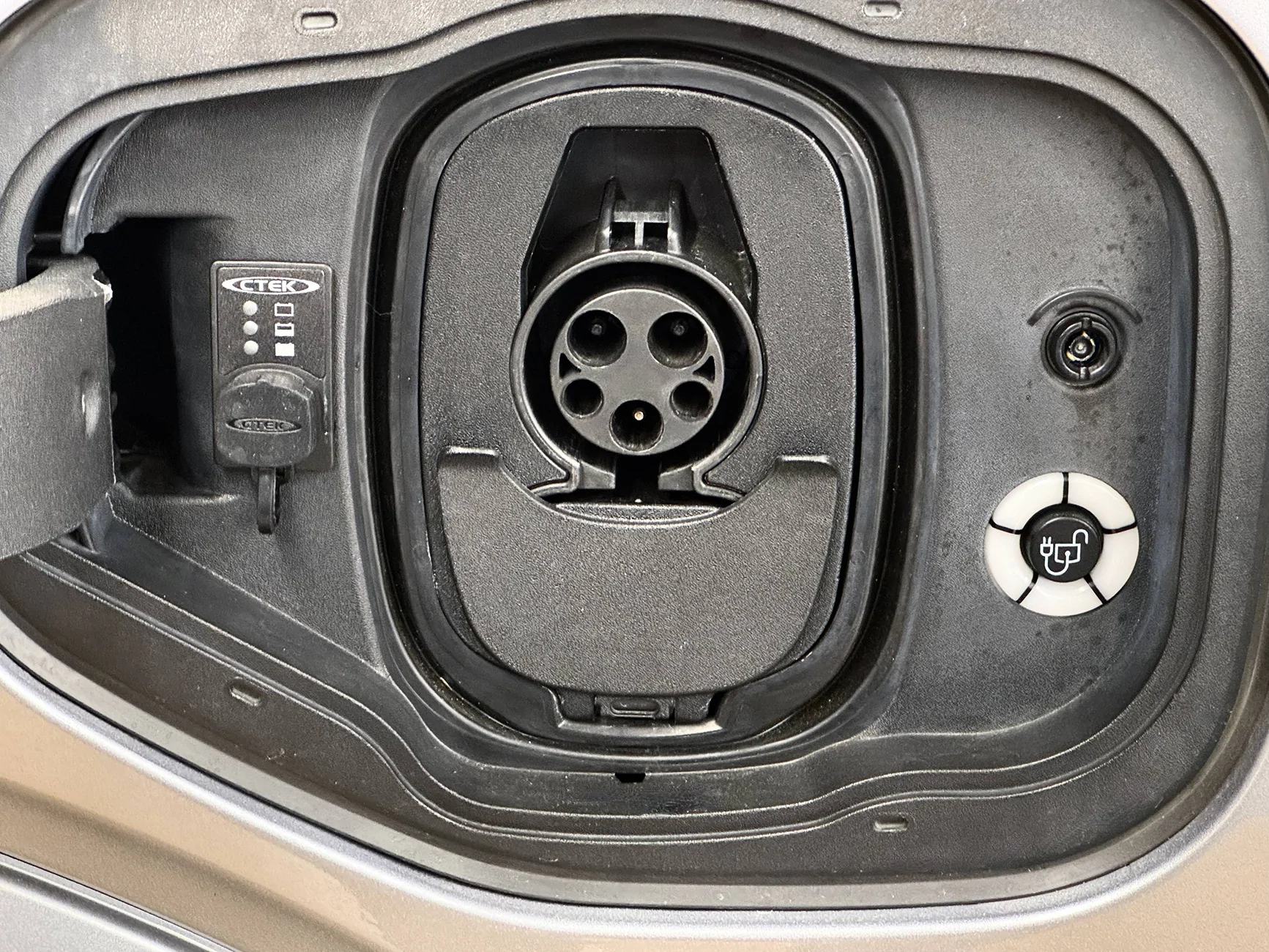

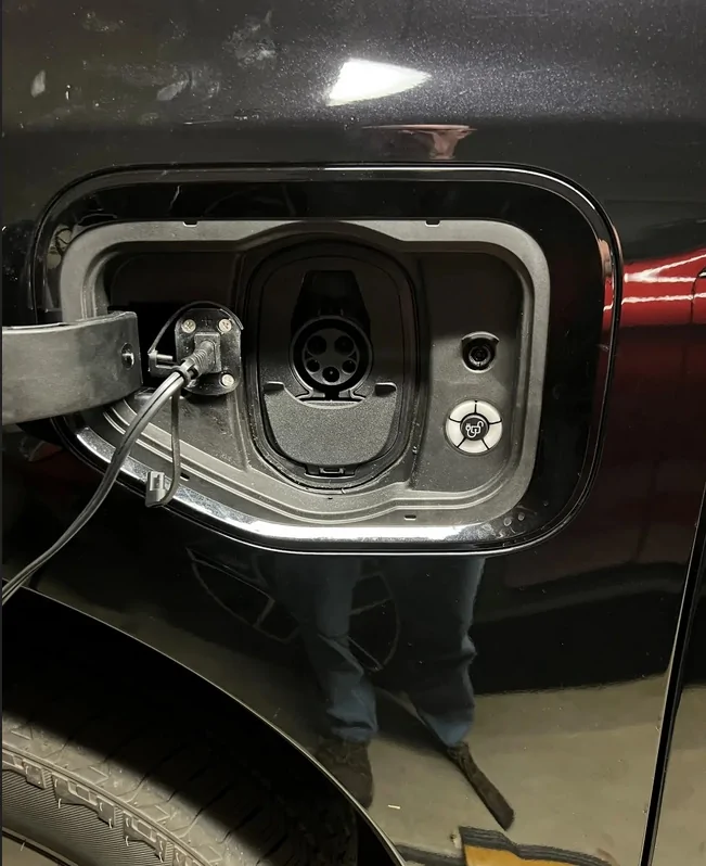

There is a guy on the MME forum who did that. He mounted it right in the charge port area.
