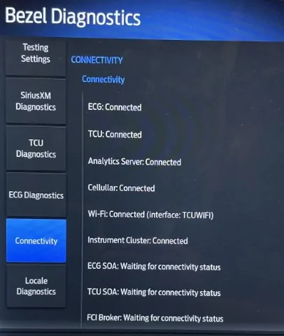

There is a Diagnostics Menu you can activate that shows all sorts of info on several of your modules including screen tests, cellular/WiFi connectivity, etc. This has been mentioned a couple of times here - one person used it to compare AM/FM signal reception of stubby vs. whip. I think it could be useful for those not getting updates if it shows you connected to cellular or not.

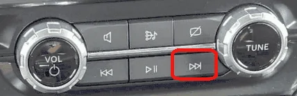

For the 12" Sync 4 screen, press and hold Steering Wheel Next track + Radio Controls Next Track at the same time for about 6 seconds, then release.

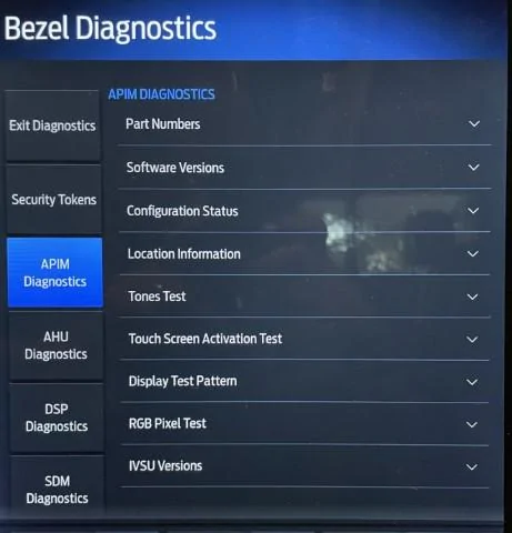

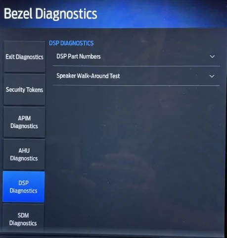

Note that your audio must be on (radio source works for sure). Here are a few of the screens:

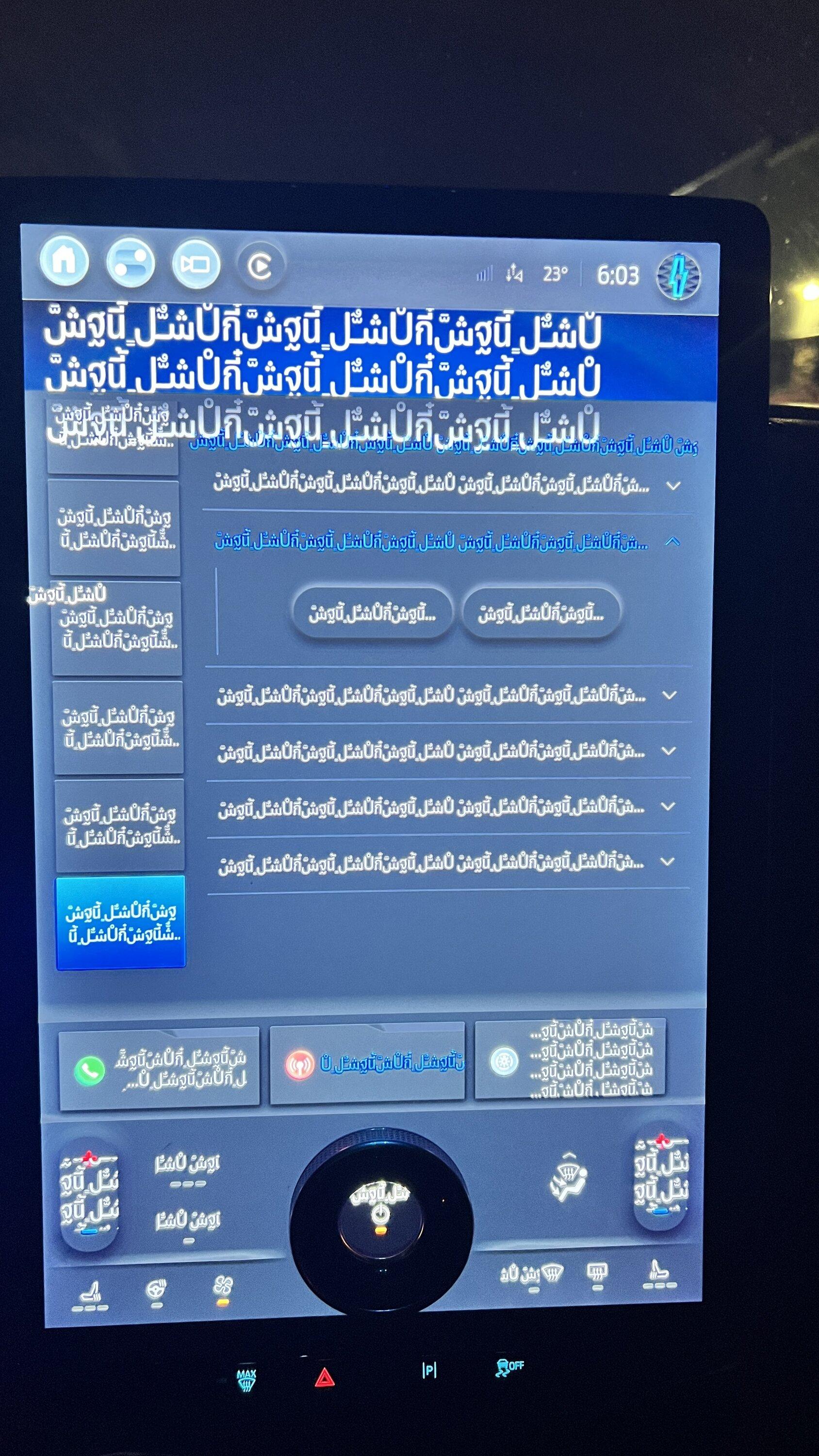

Has anyone tried the Front Height Test under the Local Diagnostic menu? Interesting results….

I think you meant Font Height, not Front Height. :) What was the screen before that - that showed the different Locale tests?

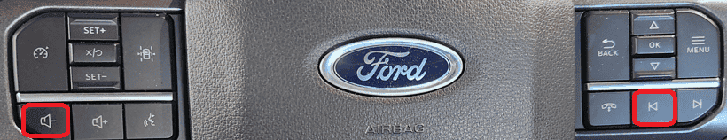

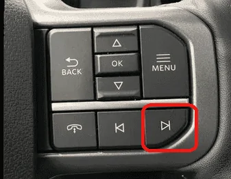

This did not work for me. The Vol (-) button is obvious, and I also pressed the |< (a vertical line with a triangle to the right of that line) button on the opposite side of the steering wheel. Nothing happened (well, the radio volume decreased and the radio channels changed). I then pressed the Vol(-) and >| button and it appears the system rebooted. The screen went blank and then showed the start up graphics (swirling blue graphics).

The buttons you have circled are correct. You have to press and hold both for several seconds. (more than 6 I think). I remember in the past it hasn't worked but when I tried again it does. Timing seems key.
That's super interesting. I wouldn't think Ford sells many trucks in Arabic speaking countries but maybe?
There's a huge Arabic population in Dearborn, maybe an Easter egg from an Arabic speaking engineer?

UPDATE 240704: Yes, for my 2022 XLT 312a 12" center screen, press steering wheel arrow advance right and audio button fast forward at same time for ~10 seconds. Starts with speaker test, then shows Bezel Diagnostics menu.
Link to a bunch of the screens, mostly APIM Configuration Status:
https://photos.app.goo.gl/jYMN1WM45U1f8WqU7
Update 250617: Bezel Diagnostics APIM Configuration Status 100 eight line screens in video form:
https://photos.app.goo.gl/VikdRVCauqhsepNJ6
I'd bet money that it's something way simpler. These characters are examples of the extremes of the highest and lowest. Which would be beneficial for a font height test. The QA team at my work puts in all sorts of characters to break our application. Emojis, Chinese, Persian, etc.
Those characters are also decently wide. Compared to the character "M" at least which, a long time ago, was used as a relative measurement to define sizing. Check out the differences:
شْ M
M شْ
They're just good characters for stress testing is all.
I don't think that is the Arabic alphabet. It looks like one of the Southeast Asian alphabets (Thai maybe?)
