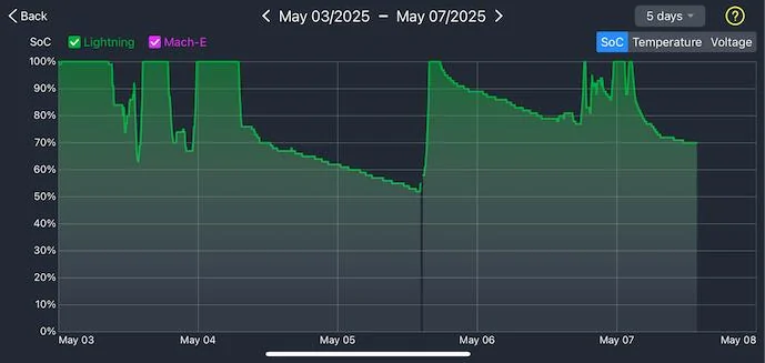

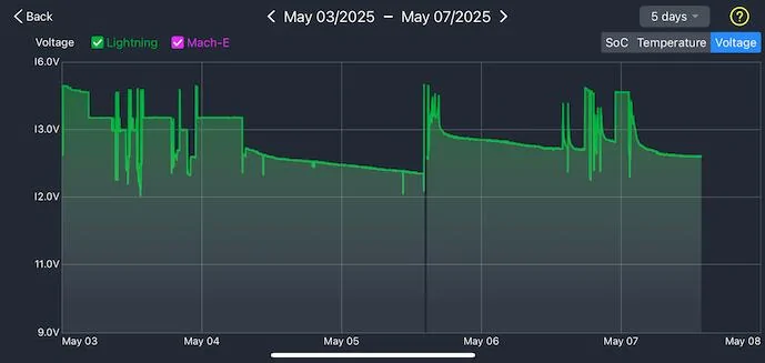

I use a passive monitor on the battery that collects voltage and SOC data every minute and allows me to graph it. The passive monitor leaves the truck to manage its modules as it normally would rather than use an OBD2 type monitor which keeps modules live longer than normal.
This is my last 5 days.
The voltage data is accurate and gives a very accurate trend showing exact drive/charge cycles. The 15-volt spikes are Truck ON and/or driving events. HBV charge cycles are around 13.5 volts on the LVB. You can even see the negative blips in voltage when the truck lights up one of the modules probably due to a door/frunk open event or me just walking by with my phone. It could also just be the truck checking on itself.
Ford F-150 Lightning Bigger front battery? 1746640799488-ps
The SOC data is only calculated based on the voltage, so it isn't 100% accurate but shows the trends very well.
Ford F-150 Lightning Bigger front battery? 1746640838076-ug
You can see the charge cycle early May 4th overnight with the quick drop once the charge cycle has ended and the slower decline in voltage and calculated SOC over the next day before I drove again on end of day May 5th. I plugged in my 5 amp battery maintainer after the drive on May 5th and again on May 6th so the dip is much less significant on those days.
Remember, my LVB is weak so the trends on a healthy battery would be less dramatic.

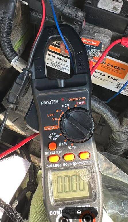

The passive logger doesn't pull anything measurable on my 1/100th DC Hall effect ammeter.
Ford F-150 Lightning Bigger front battery? 1746650928761-z7
It might pull a few milliamps when I connect to the Bluetooth to pull the data, but for the most part, it is negligible. I have one on the wife's MME too, and her drain profile is way lighter since she drives 6+ days per week and has fewer modules. Incidentally, the MME tray can fit an H4 with no modifications, although she is still on the original H3 for 34 months now.
I think my drain profile looks excessive because of the weak battery. When the LVB was new, it would take a week for the same discharge. It is probably operating < 50% capacity at the moment. I'm curious if there is a PID for that.
Definitely interested in the PIDs if you can pass them along. I am fully OBD2 enabled with CarScanner and Forscan and even have a J2534 passthru for FDRS, although I only activate the subscription when I want to do updates without waiting for OTA.
