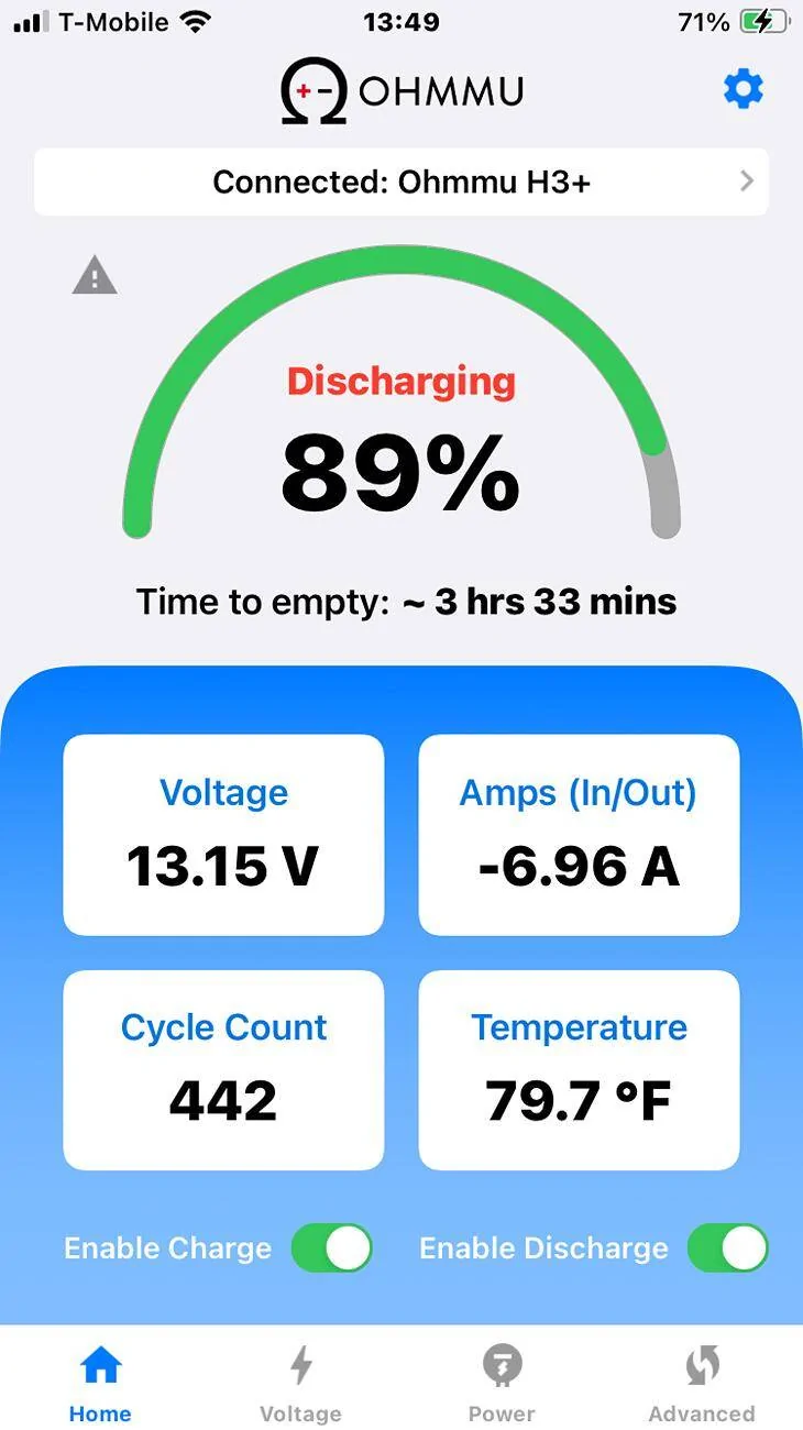

I eliminated my LVB issues 2 years ago with the Ohmmu H3+. 19 lbs lighter and worry free. 54k miles and counting.
The Ohmmu website currently shows 2 batteries for the Lightning ... a Sodium battery and a Lithium battery. I assume you are using the Lithium battery. I read where the Ohmmu app displays 12 volt SOC. Out of curiosity, what SOC do you usually find the battery is at?
Yes I have the lithium battery and SOC is typically around 90%. Wife just got home from a short trip and this a screenshot from the app.
Ford F-150 Lightning Bigger front battery? IMG_1610
