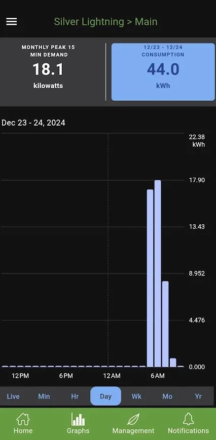

Additional observation from this morning that could impact how shore power is used:
I've been scheduling my charging daily since the freezing weather started the past few weeks to get a firmer idea of how much overhead warming is occuring vs. weekly charging, so far it's proving to be more costly than necessary given my weekly drive routine. YMMV especially high mileage drivers.

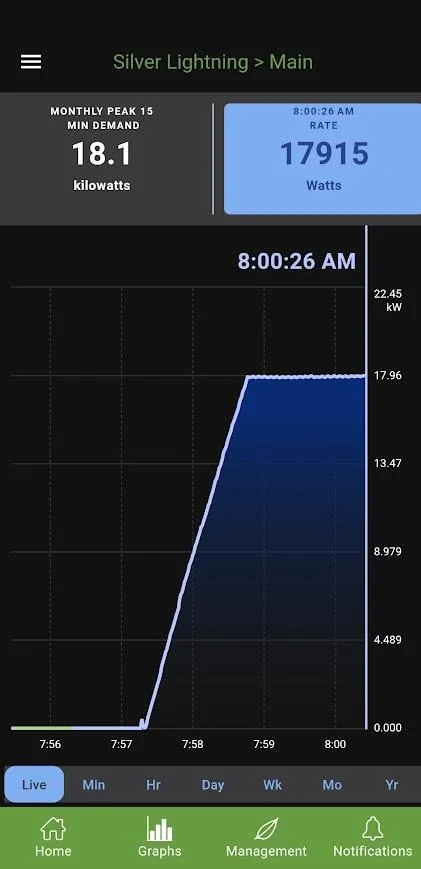

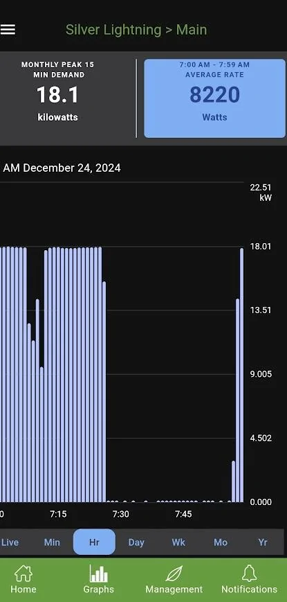

After yesterday's' driving around I had depleted the the SOC from 90% to 74%, plugged in last night with a home based charging rule to begin charging at 5am and bring the SOC back to 90%, with no morning departure time programmed, I intended to use remote climate start ~15 minutes prior to leave time at 8am
6:30 am this morning I was looking at Fordpass active charging session data, it's looking normal, Fordpass projected 90% by 7:35 am, I looked at my Emporia log, it's also normal, logging several more kWh than Fordpass which is par for the course, recall that it only reports net energy to the battery.
7:27 am, Fordpass notified me with an alert that charging had completed, as per the most recent version 5.9.0 it's suspends the display of the details about the active charge session because the goal has been met, you'll only see the final details again from the history log AFTER you unplug.
I recently discovered that if you click the [START] charging button, that the data panel will reappear, I did that and pulled the stats for my spreadsheet, then immediately clicked [STOP] charging.
7:45 am I click the [FAN] icon to start the climate controls, truck started and warming commenced.
I look at the charging session data panel which is still displayed, but the kWh deposited does not change, well that s been the case since the SOC goal was already met, in older versions of FP this counter would continue to accrue kWh.
I look at the Emporia log, I'm NOT seeing any additional energy flowing to the truck, apparently interrupting the programmatic routines with a START/STOP button cause the OBCC to block any additional energy transfer, even for modest amounts to balance charge & draw from using the climate conditioning.
7:57 am, I see the SOC has dropped to 89%, so I clicked the [START] charging button, energy begins flowing, I let it run until we unplugged a minute or two after 8 am.
Lesson learned, DO NOT interfere with the programmed routine and supplemental energy will flow as long as your time frame limits allow energy to flow, tamper with the stop button and any remote start or departure timed conditioning will be interrupted and the battery will be drawn upon for warming routines.
Ford F-150 Lightning Cabin warming 1735050175969-b6
Ford F-150 Lightning Cabin warming 1735050194954-u

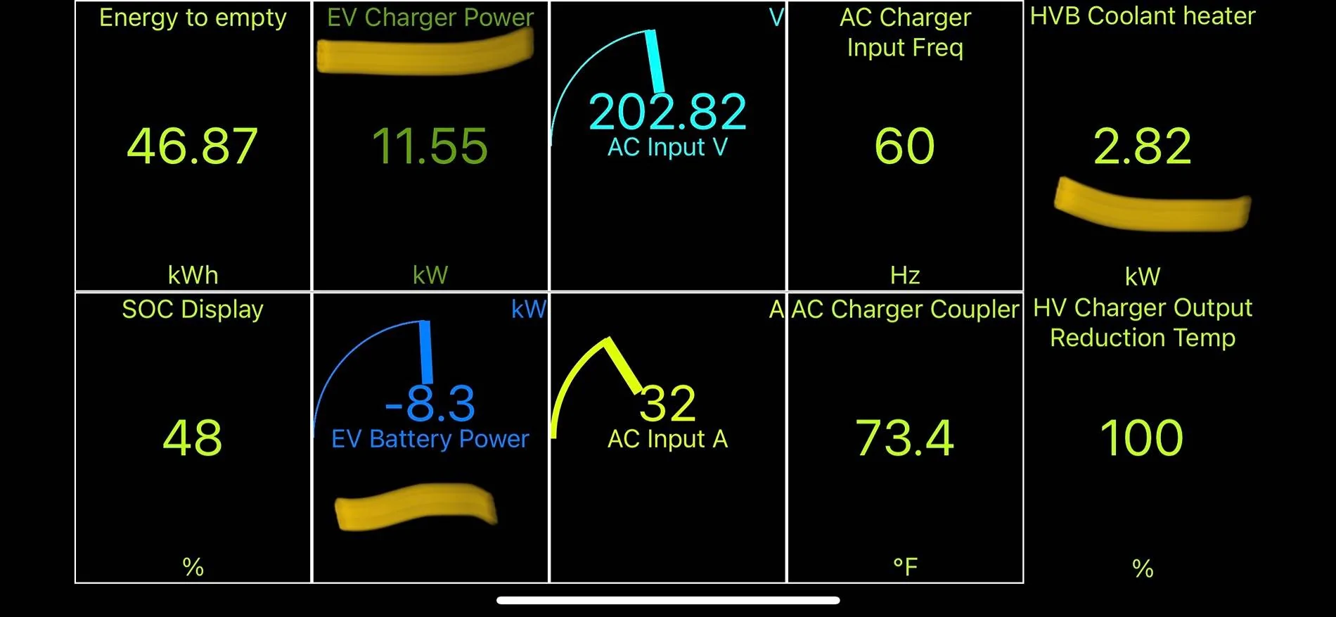

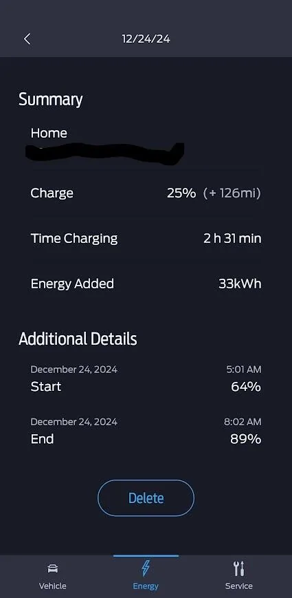

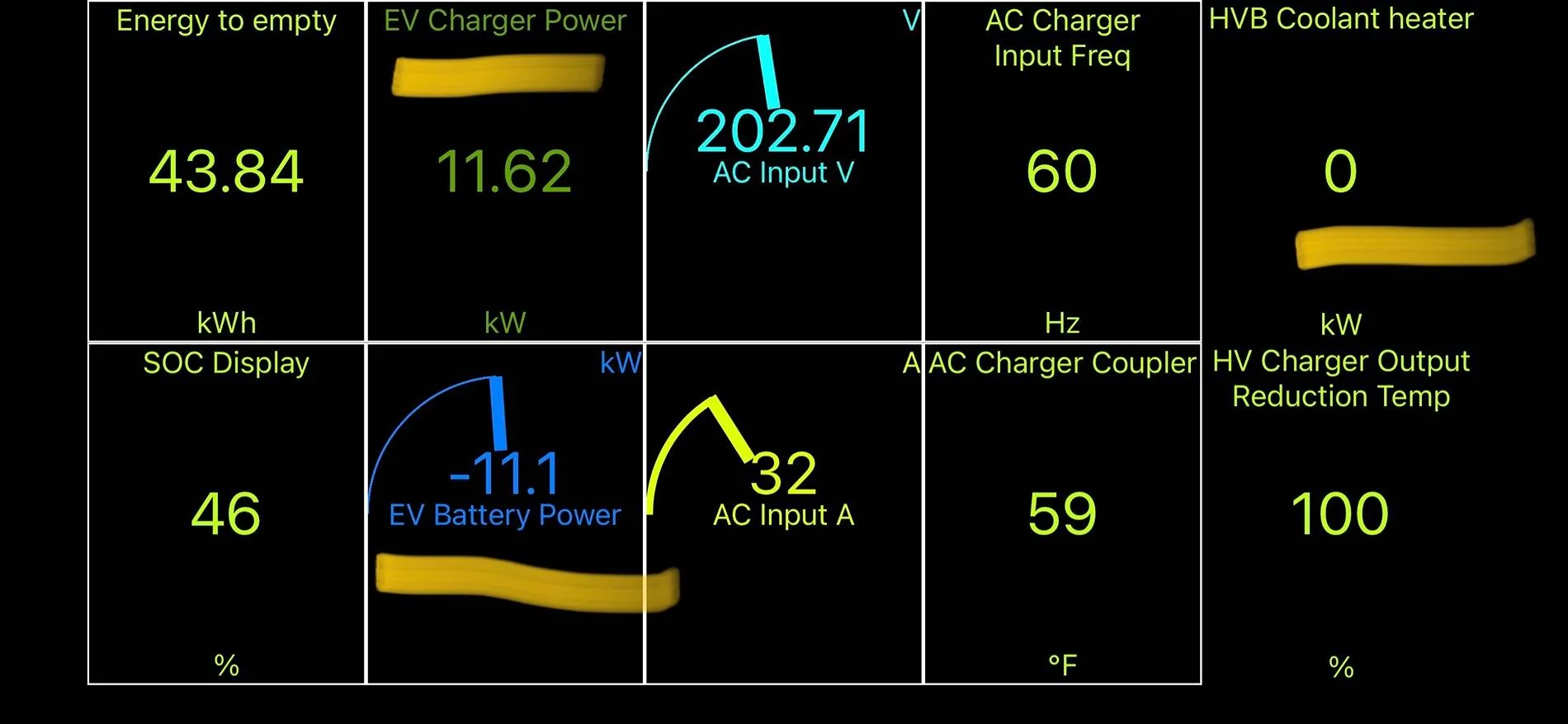

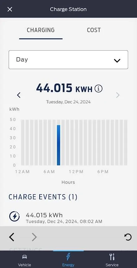

Here is the post event logs:, traction energy 33 kWh, gross energy 44 kWh, losses 25% due to battery & cabin warming plus AC/DC conversion.
