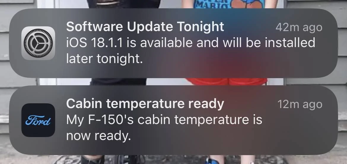

The last two days now my app says preparing cabin it even alerts me when the cabin is ready, but first thing I noticed weird is usually when the heater is running the lights are on which it hasn’t been also I get out there and it’s cold and nothing‘s running. I’ve checked all of the settings for departure times in the app and if I manually start it within the app, it kicks right on. Weirdness

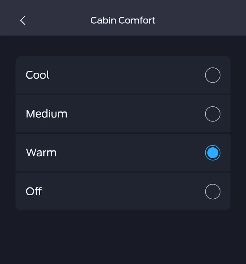

Might be a ghost message from the server from a prior scheduled event.
Do you have a departure event with a setting to OFF??
What is the departure time value and what was the time you observed the situation?
Eventually the truck will go back to sleep after about 10 or so minutes past the scheduled departure time.
Ford F-150 Lightning Preparing cabin 1732719832694-sd

I only have two departure events. Both of them are on, both of them with the temperature is 75° with seats and steering wheel heat, both to prepare cabin off plug although it was on 110. I do have warm selected in the settings as well like your picture.
The set time is for 7:50 in the morning when I leave to take the kids to school and we went out there at 7:51 and it was an ice cube
i’ve been using this feature for weeks now this is new

How soon after that notification are you going out? It does not stay running very long after the set departure time. I think may only stay on for the set 15min run time? It's not like Tesla that would stay running and toasty warm for an hour.
Um…see above.
