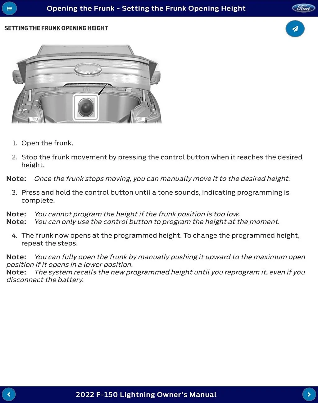

You can customize the opening stop point, the owners manual has the procedure, but it's a set and forget process.

If you haven’t already go to Ford.com and create an account with your vin, you can find everything you need to know about your Lightning.
Ford F-150 Lightning Can I open the frunk partially? IMG_1080
? I had no idea. My 6' 0" forehead hitting directly on the damn corners of the faux grille may get a reprieve?!?!?

In my garage I have a shelf over the front of the truck and the frunk will just barely tap the shelf when opened all the way. I set it to stop about an inch short of full open.
