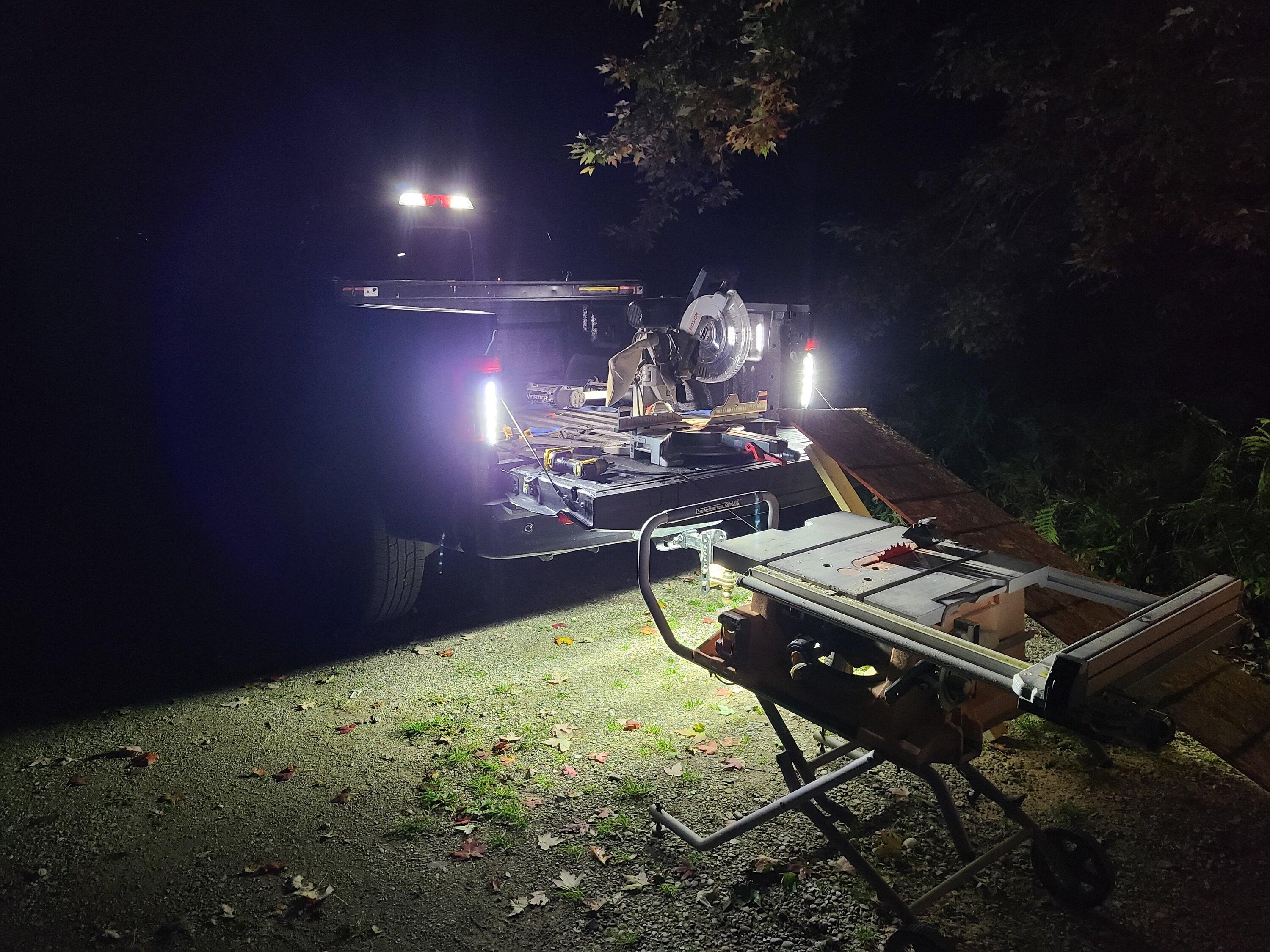

Any update?
I've used a Makita 10" miter saw a few times on the bed outlets now without issue.
