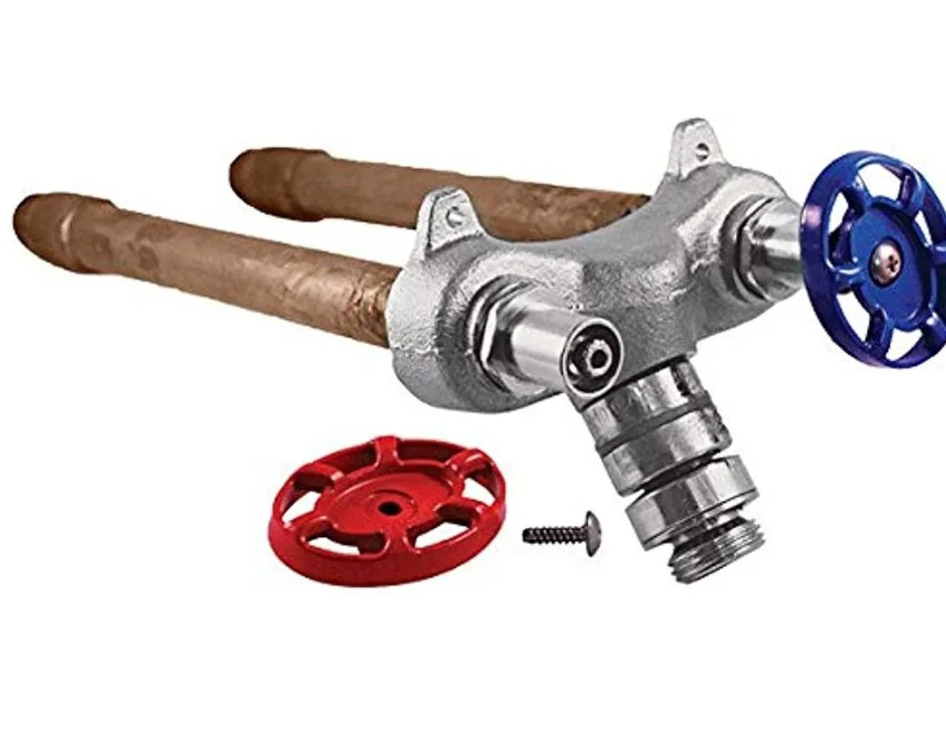

Hey Neighbor, WI here. I have installed a freeze proof hose connect that has hot and cold water, so I can have warmish water.
See pic:

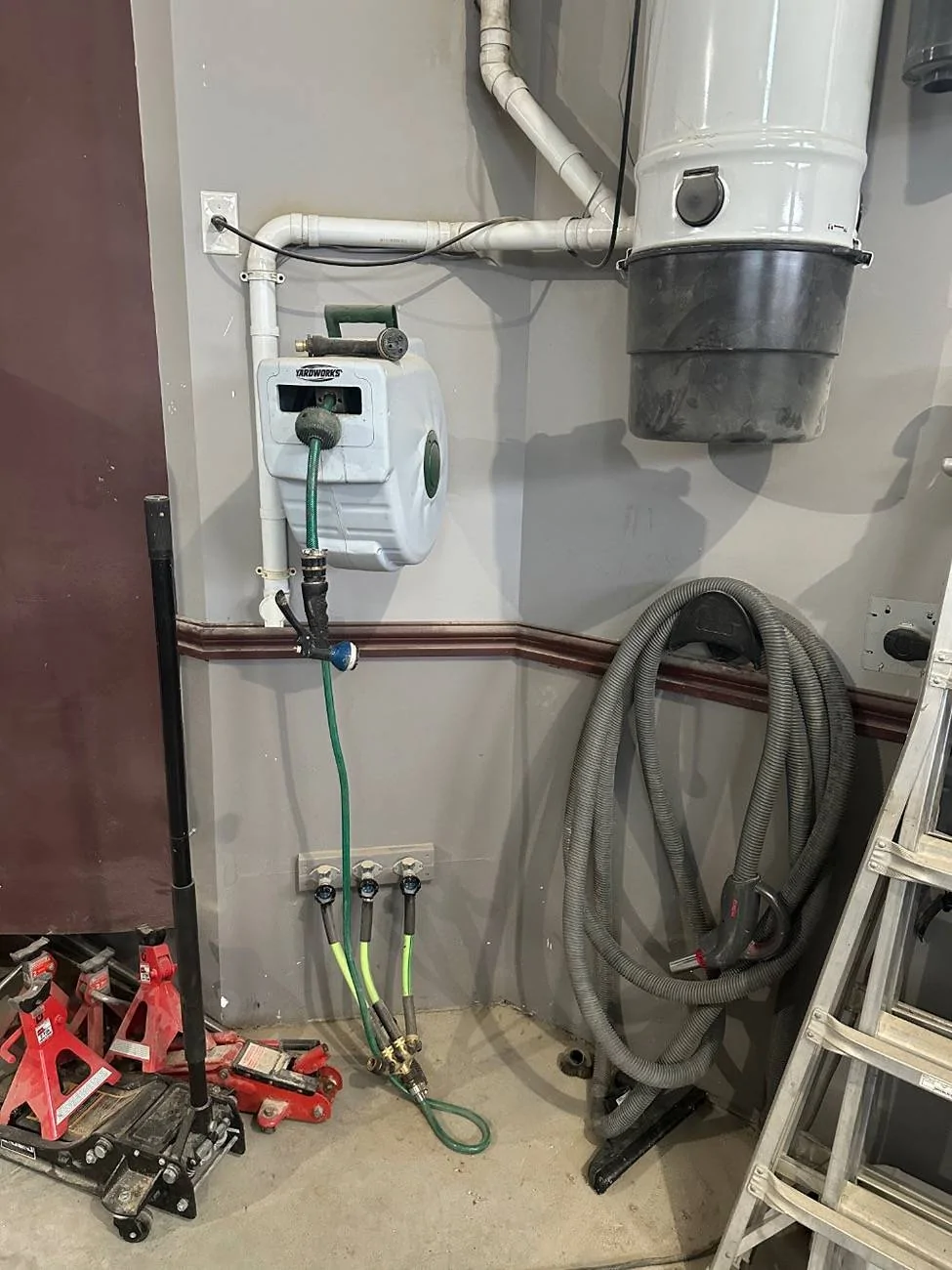

I live in one of the most northern major cities, Edmonton. If you go back even a decade, it never dipped below freezing all winter long. Now we get cold spells at -15F for a week but most of the time in hovers around 15F to 40F. So we do get quite a few days above freezing.
Our homes up here use what's called frost free hose bibs. The faucet has a real long canister behind it that protrudes into the warm house. They are usually positioned at the height of the floor joist so they go in there and nobody sees them. I don't know all the technicalities of how they work exactly but the premise is that this canister has a second tube inside of it. When you shut off the water, the air inside that second canister and gravity forces all water inside them to drain out. No water, means nothing to freeze. So there is no maintenance or winter draining to these. The only rule is, you can't leave a hose attached to it when it goes below freezing. You can attach a hose and use it in freezing weather but you must immediately detach it so it can drain itself. Due to our past extreme weather, we've had these in our building code for decades and they work great. I've taken mine to another level though. I have 3 spigots in my garage. Hot and Cold Soft water, and cold tap water. The soft water prevents mineral deposit spots after rinsing. Since my garage is heated, I can keep a hose attached all the time and sometimes I just wash my truck inside my garage.
Ford F-150 Lightning Carwash Light Show IMG_5570
