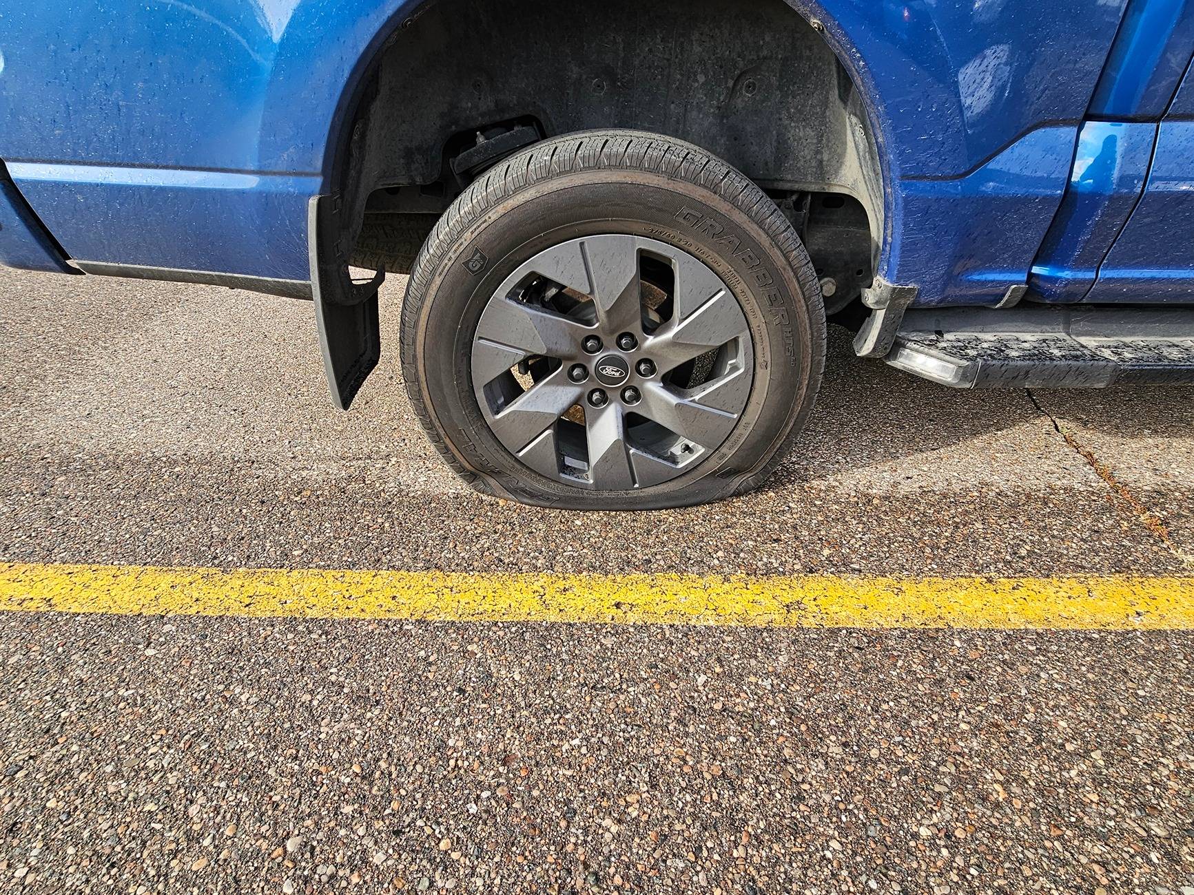

Changing a flat tire, could not use the included jack

Used mine today. August 22 Platinum model. Back left wheel. On flat concrete. Knowing the history of the Jack I let my wife run the Jack. On proper lift point. . Jack started bending, handle started bowing, hook began to twist and could not get the tire off the ground even after I tried to finish the job. Helpful newly retired Army Veteran stopped and had a cheap 2 ton floor jack we put under shock mount and finished the job. Maybe Ford changed jacks at some point. I went and bought a compact 4 ton and put it behind the seat. The OEM jack is on the metal recycle pile. It’s a POS.

I tried using mine a few weeks ago to change out the back passenger tire on flat, level concrete. Before the tire was off the ground the top portion of the jack was leaning far to one side even with the base flat on the ground. Looked super sketchy so I abandoned that effort.
This afternoon I met up with another Lightning owner to swap wheels. We tried using the jack that came with his truck and the same thing happened. Fortunately, the guy brought a large bottle jack and it worked perfectly.
Two different Lightnings, two different OEM-supplied jacks, both on flat, paved ground with the e-brake on, but both were so sketchy to use that I do not trust them.

I ended up with a flat on my way home from work last week. I first attempted to use the included emergency jack, but I could not get it to lift the truck. It just kept moving on the ground rather than lifting.
Two different roadside assistance drivers only had floor jacks that could lift up to about 18" (which is standard), and they wanted to jack the control arms on the inside of the rear wheels. I refused and was adamant that they use the prescribed jack points on the side of the vehicle (the frame). The standard 18" lift height jack probably could have lifted it enough to get the flat tire off, but it would not have lifted it high enough to get the spare on.
I ended up having it towed home on a flatbed, and the next morning I bought a 3.5 ton jack that can lift up to 23" (~$300 at AutoZone). That was sufficient to get the spare on, and I'm getting a new set of tires today.
Due to this, for future road trips I am going to bring the 23" jack, tire inflator, and impact driver.
Just an FYI for anyone in a similar position. I may have missed it, but I didn't find anything in the manual about how much lift height is required, and most roadside assistance drivers will not have a jack that can lift that high.
