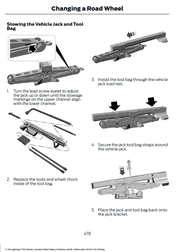

Does anyone have a good website or video for how to neatly repackage the jack kit after using?
I had to use mine this week in a rush and did not carefully pay attention to how things were packaged up.
The manual is not too detailed about the repacking process, here is a snapshot
Ford F-150 Lightning WARNING RE Flat Tire Replacement 1680819018189
