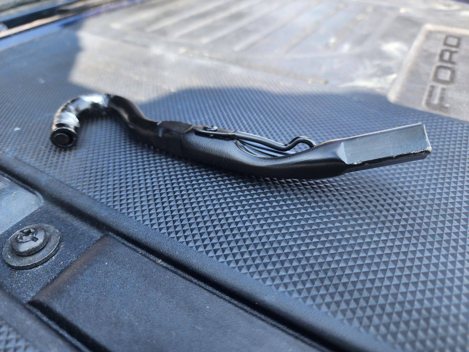

My wife had to change out a flat tire and managed to twist this part of the jack.
No, she is not super human.
Anyone else able to twist this thing?
Thanx,
Jeff
Same thing happened to me. That jack is completely useless, as soon as pressure started building the same component pictured above twisted like a pretzel. I emailed Ford- no reply. Thank god for road side assistance, although I had to wait for over an hour.
