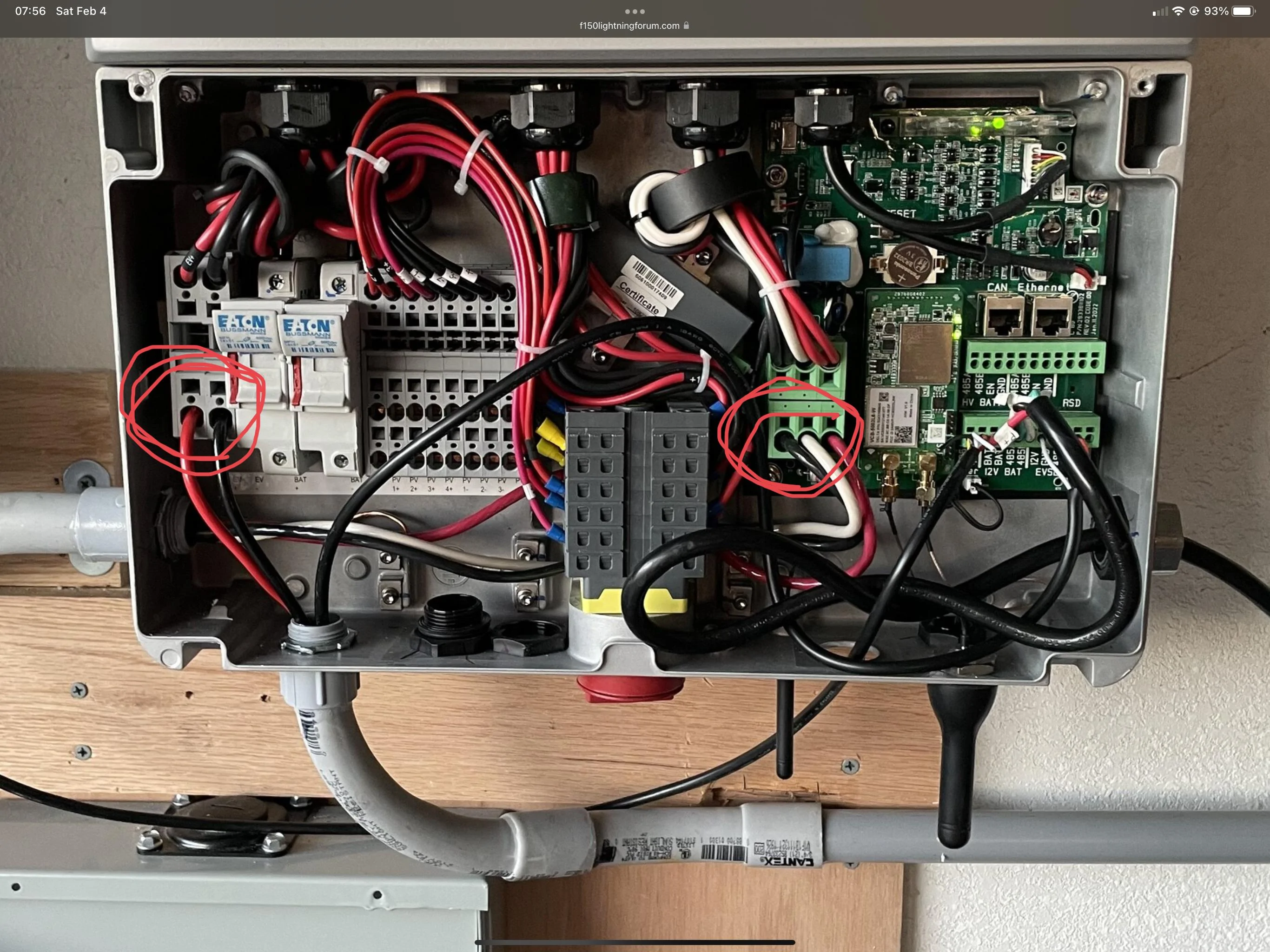

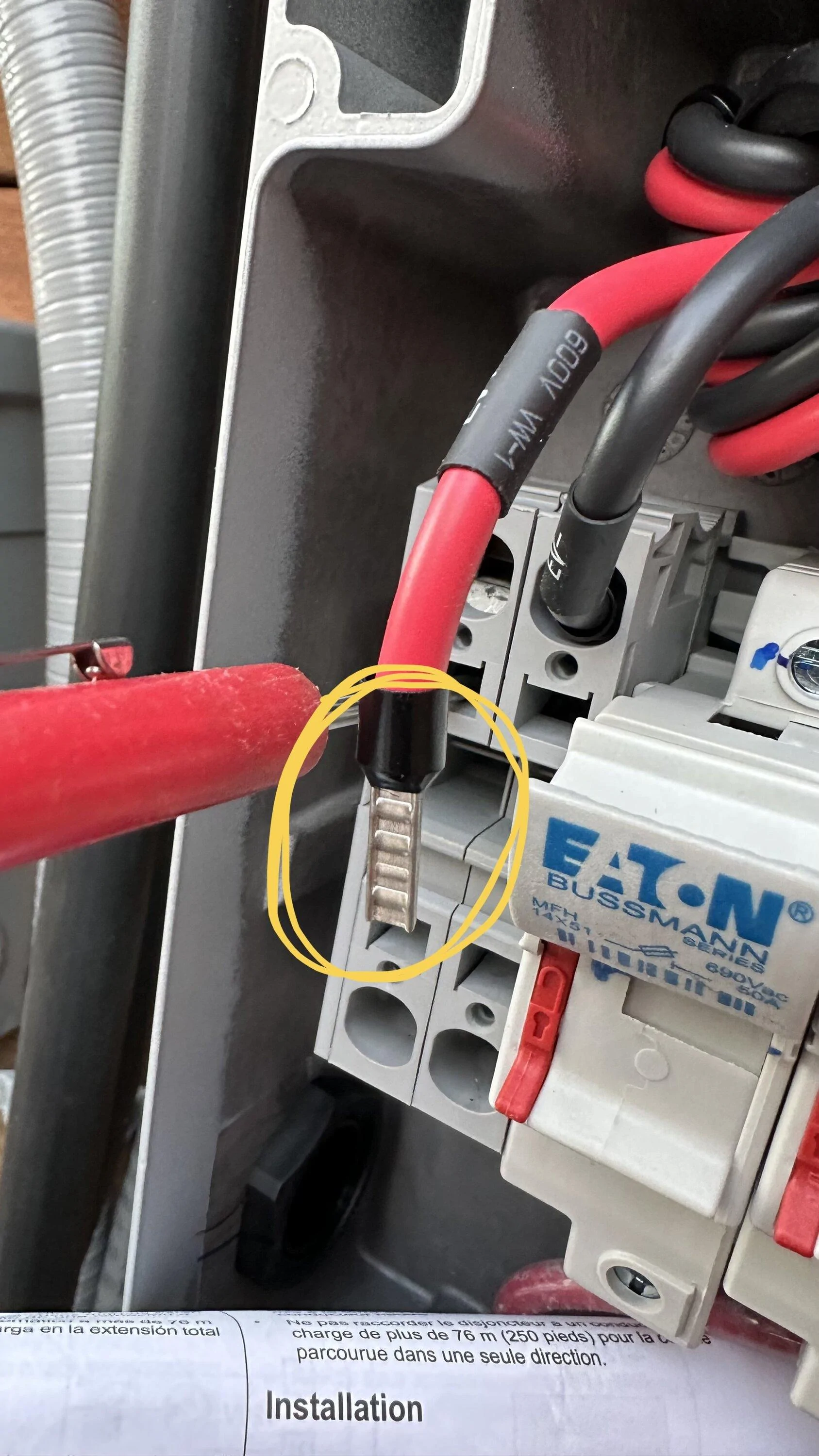

How did you do your dc connections in the inverter. Did you use crimp connectors like the existing connections? If so, can you share type and source.
do I need ground wire in the dc conduit ?
Ford F-150 Lightning Charge Station Pro and Home Integration System self-install 177158FB-1241-492A-8463-9962BCEFCEFE
Ford F-150 Lightning Charge Station Pro and Home Integration System self-install BA1EF0D5-2F1E-47C4-BC6E-67F8437543F6

Update for the group. Got it working tonight! I'll post pics for others trying to figure it out in a few days. Bottom line, my electrician had a couple things wrong in the FCSP. A ground had been run from the inverter but not actually connected, and two comm wires had been used instead of the 14 AWG wire for the "backup battery IN" connection.

nice. Im missing the little green plugs for the cat wires. Do you remember if your charger had all these installed?
