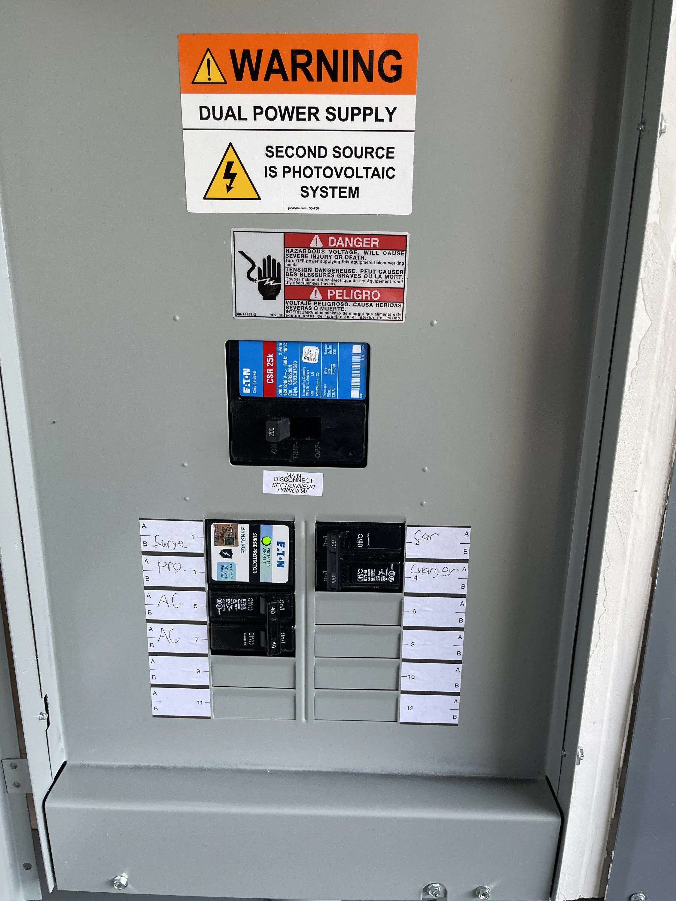

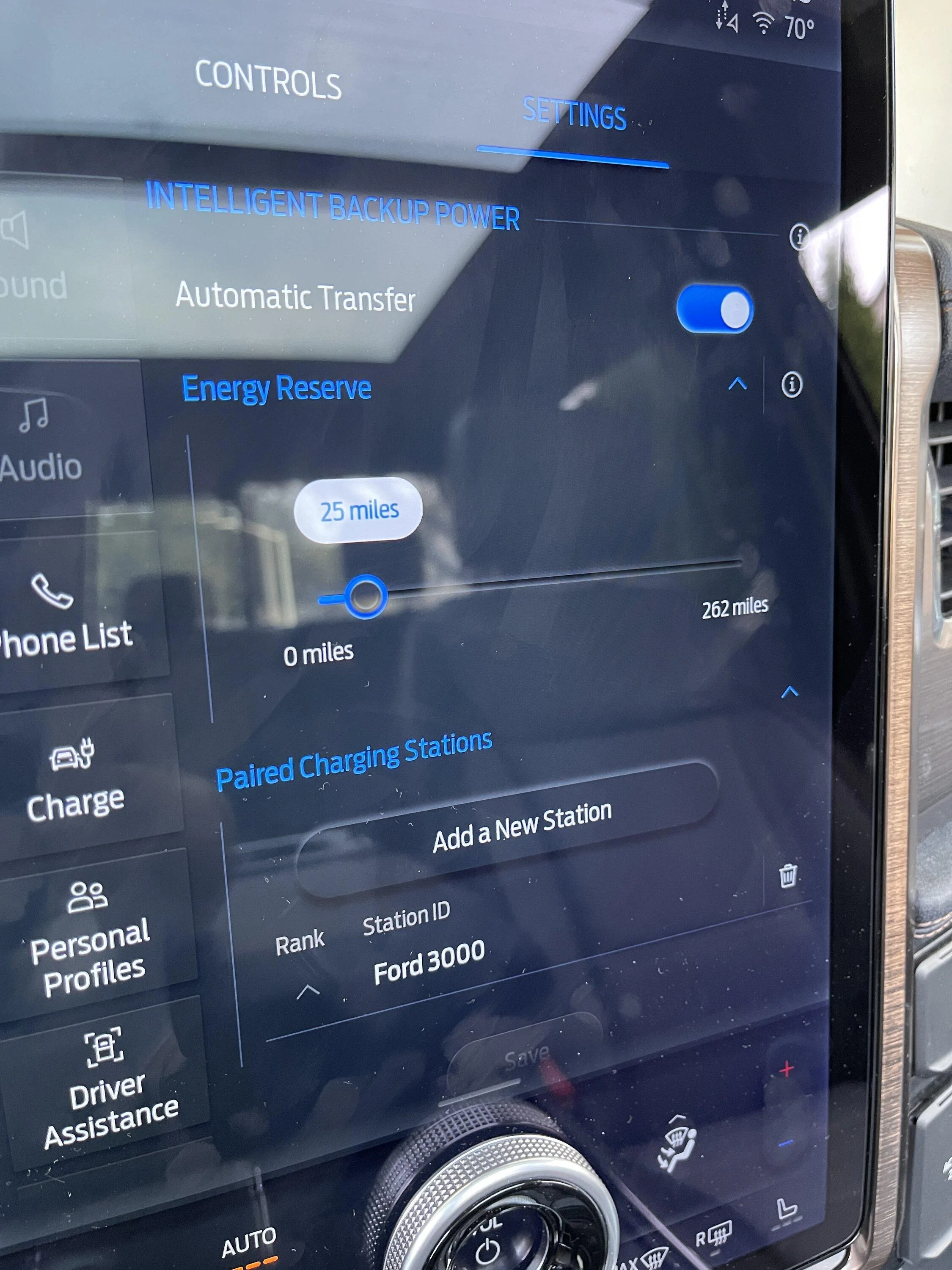

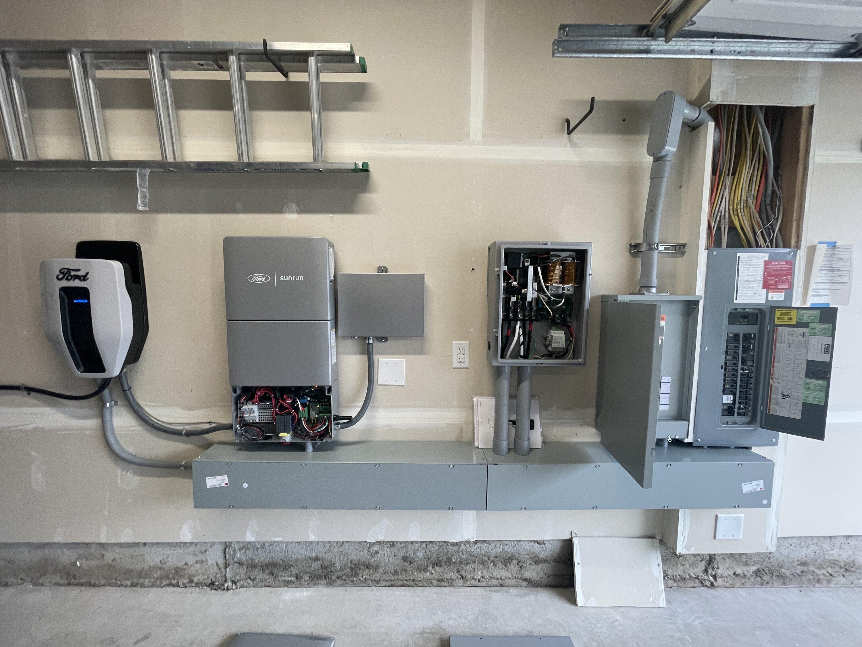

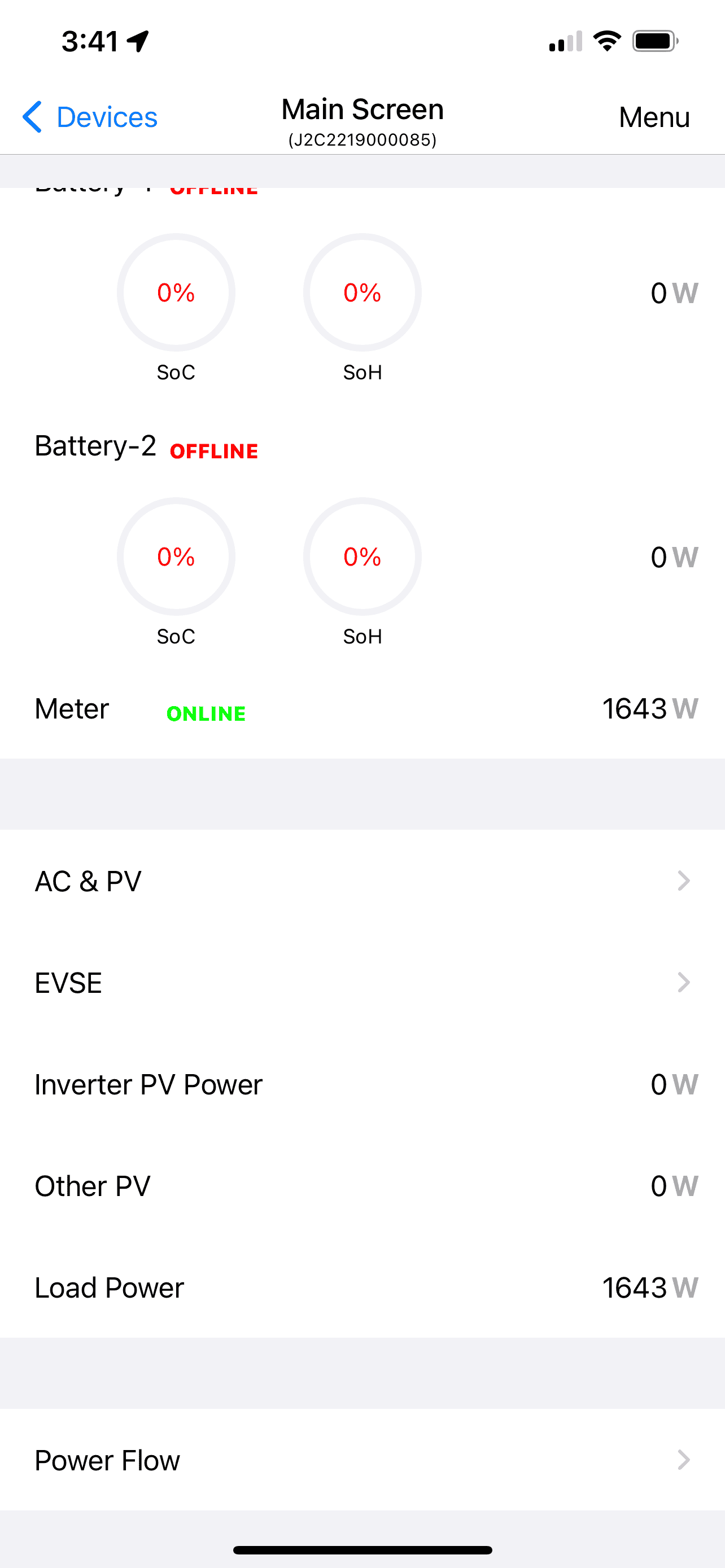

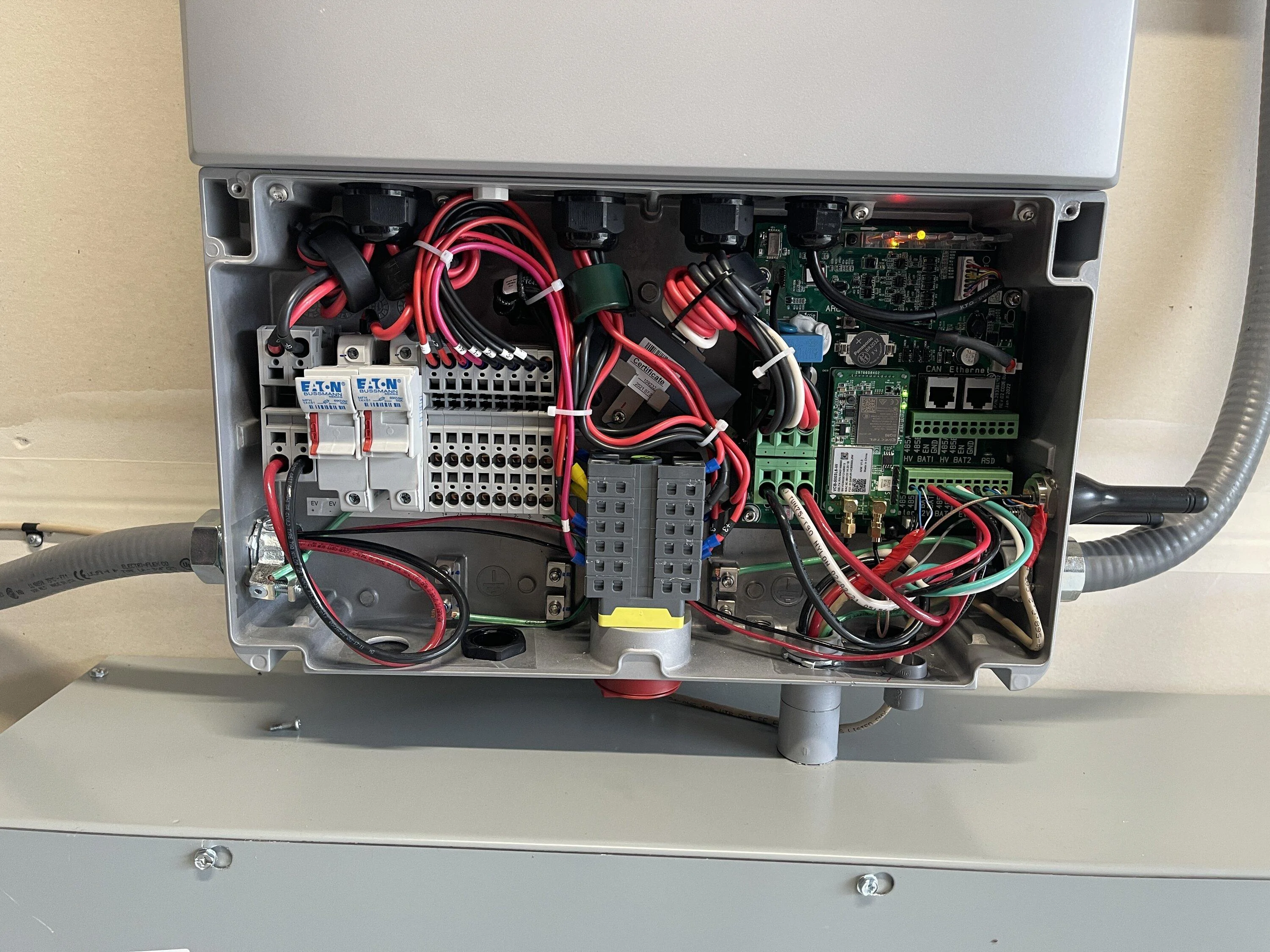

Follow up on some details…
Ford F-150 Lightning Charge Station Pro and Home Integration System self-install F3AB6A62-3800-4B35-80DF-2C4EB254CCB6
Ford F-150 Lightning Charge Station Pro and Home Integration System self-install C4D7283F-A8E8-4098-82BF-8BF073F02BC3
Ford F-150 Lightning Charge Station Pro and Home Integration System self-install F67F1DB4-DD06-47AC-932D-72965D896292
Ford F-150 Lightning Charge Station Pro and Home Integration System self-install 1AA873F7-C47A-4828-BCCF-028AF63111AF
Ford F-150 Lightning Charge Station Pro and Home Integration System self-install A58B6B85-DC30-4152-A2A9-D88803F63529
Ford F-150 Lightning Charge Station Pro and Home Integration System self-install 544BE787-C72B-4977-9E56-0ED5C5F09F30
Ford F-150 Lightning Charge Station Pro and Home Integration System self-install 90F6745D-0DD8-481B-8AD6-55ABABF749DA
Ford F-150 Lightning Charge Station Pro and Home Integration System self-install E945AD1F-8B4C-48F2-ABFB-64AED3E88D5B
Ford F-150 Lightning Charge Station Pro and Home Integration System self-install EFCBE4F5-5C37-4D29-8BDB-7E8BD1C58173
Ford F-150 Lightning Charge Station Pro and Home Integration System self-install F4BABC7E-589A-4A46-818D-AA6AEE9E76C8

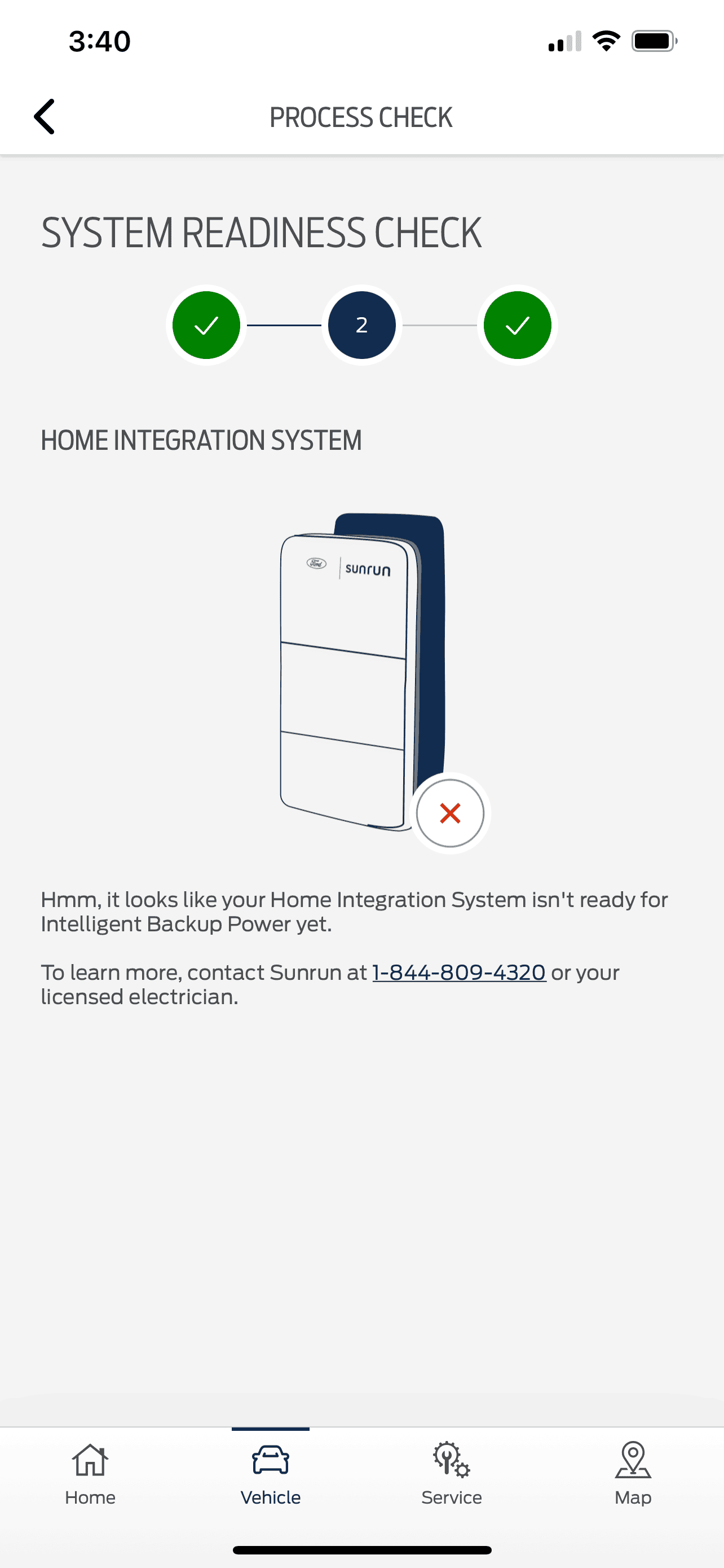

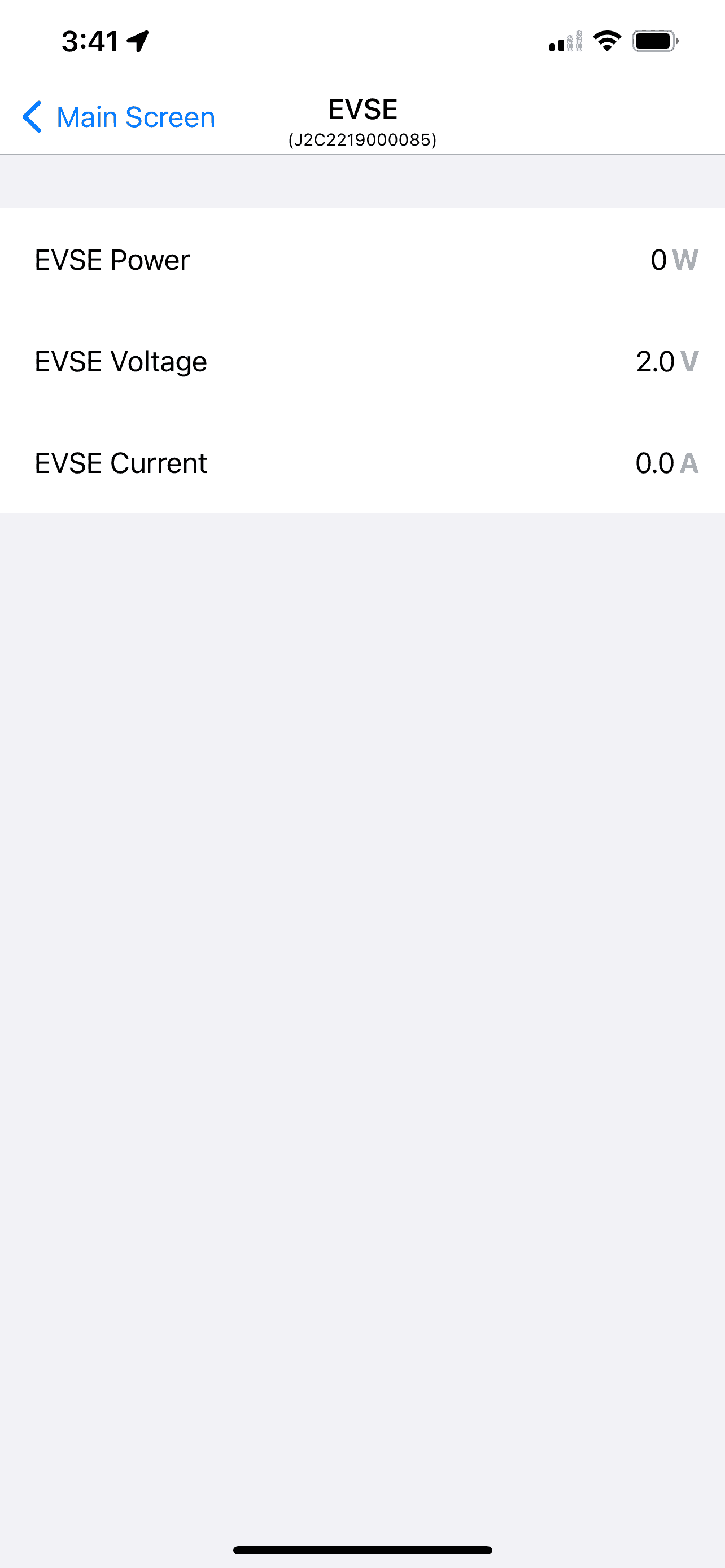

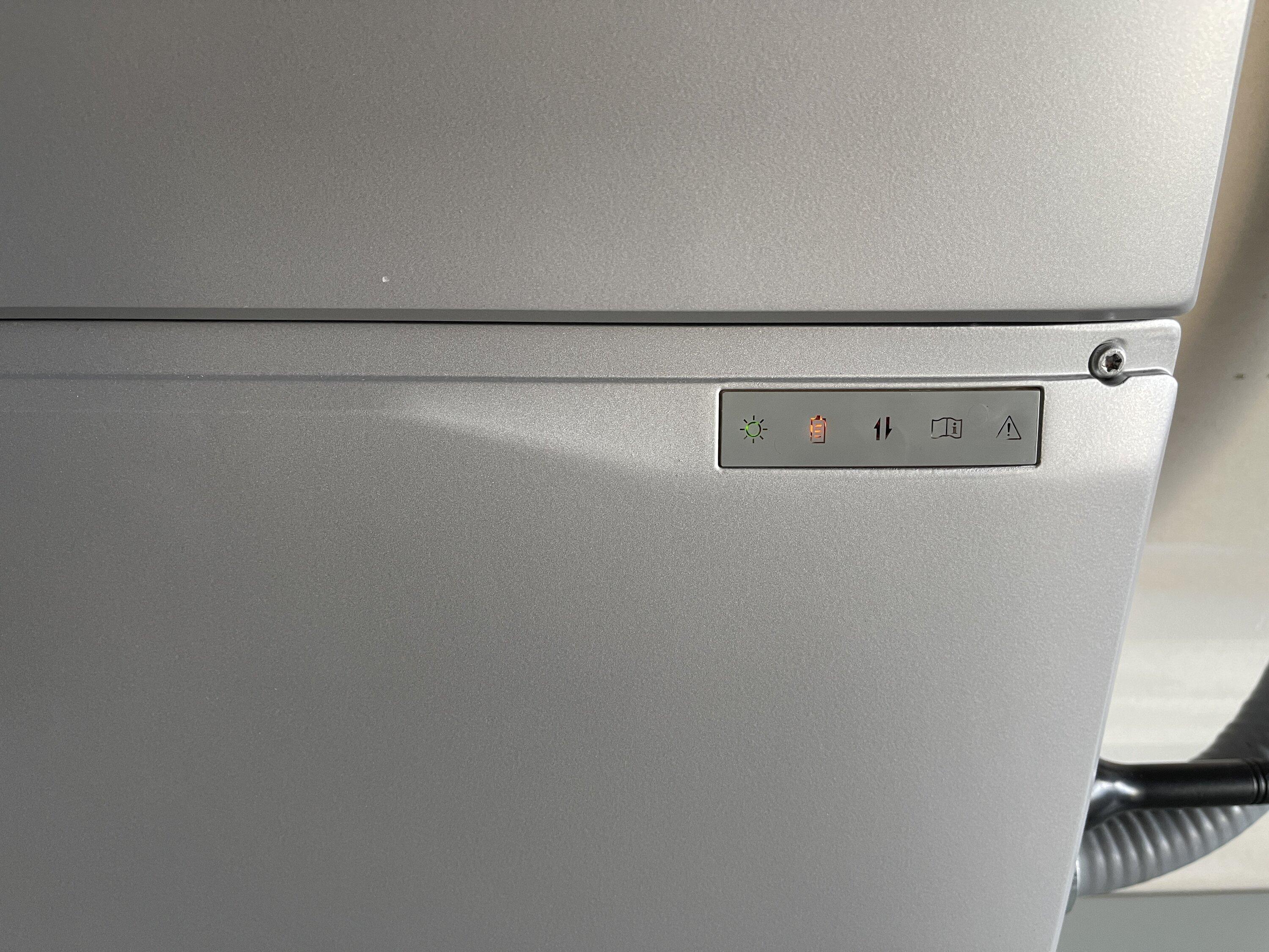

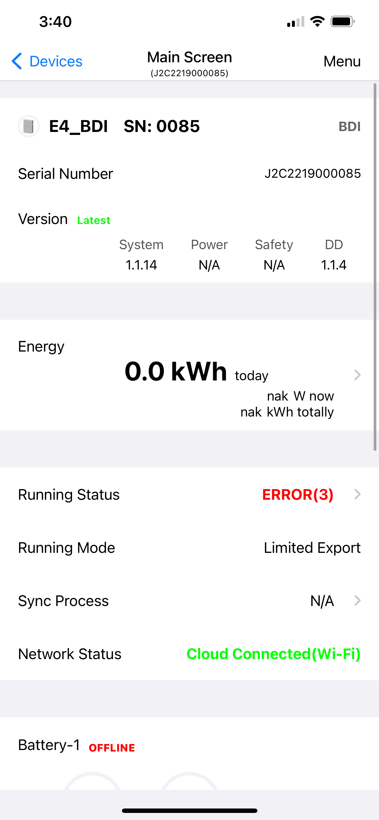

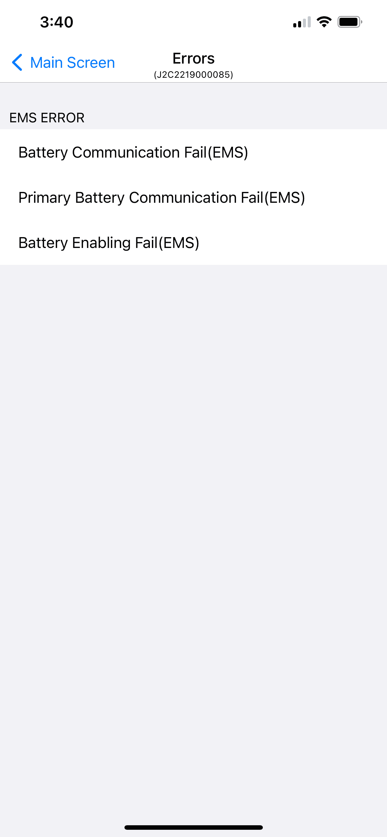

Yeah, I am more looking for "WHO" to talk to more than anything... I.e. I know this is not a PUD or electrician thing since the system has been permitted and everything is ready to go. The only two parties that are left are SunRun and Ford (or maybe Delta) as to WHO could answer this. Since its the FordPass app, SunRun is saying its Ford. Ford denies any responsibility for this (like you are inferring)... But ultimately, its Fords and SunRuns name n the box that has the issue. And since SunRun does not care enough to have anyone on this forum, I thought I would throw @Ford Motor Company in the post at the very least. On to twitter....

Twitter has been somewhat fruitful. Levine responded to contact SunRun. SunRun responded with a DM request asking for my electricians info. Progress??? Probably not but hey... Something.

Well, apparently what is happening from a SunRun field tech who has been awesome is that for SunRun managed states, there is process gap. Fordpass has to verify with its partners that the equipment has been installed and signed off by utilities before allowing the app to use it. This data flows through SunRun to Ford. For us out of those states, we can either contact Ford or ask SunRun to input the data and register the equipment so that it flows through the process normally. So while it has not happened yet, there is some progress. If I can get good information on how to do this for others, I will post it. FYI @Wombat
