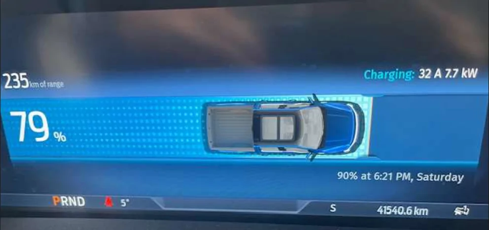

I put the truck destination charger connected to a 10k generator - took a pic for anyone interested.
View attachment IMG_7588.pdf Using the generator display and checking with a meter the output is a bit higher at 33A 241v.
after running this for half an hour I checked all the cords and plugs - all cool to the touch.

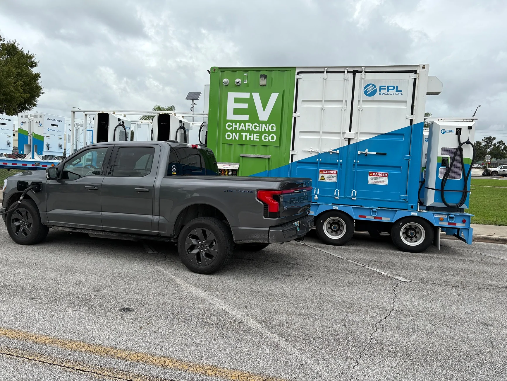

I'm in hurricane land, but the nice thing is that FPL (local electric company) goes out with a portable charger whenever there is a hurricane, so I use my truck for a house backup with the plans of using FPL to charge the truck if there still isn't power to my house after a few days.
To confirm OP's post, yes you can charge your truck with a small generator. It will be slow, but it will work. Just realize it might not be the best plan unless you really think you'll be isolated for many weeks.
We Charged our Lightning at a FPL Mobile charger right after Hurricane Milton. We evacuated to our inland Rural cabin and FPL set up the mobile charging trailer in Okeechobee. We charged on the way home. All gas stations were out of gas. It was strange that having an EV eliminated the 1/2 mile long lines at the few gas stations that had gas. Picture below is us charging at the FPL mobile trailer.
