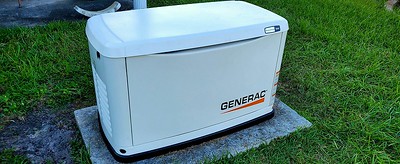

Got it covered. 18k Runs the whole house, starts within 5 secs of grid failure. With the FCSP on the home, it's handled as well. No plan to ever need a small unit although I do have one I keep in the garage in case the big one fails (happened before).
Ford F-150 Lightning Charging Lightning from a generator 54873661764_f12b6a9cee_w
