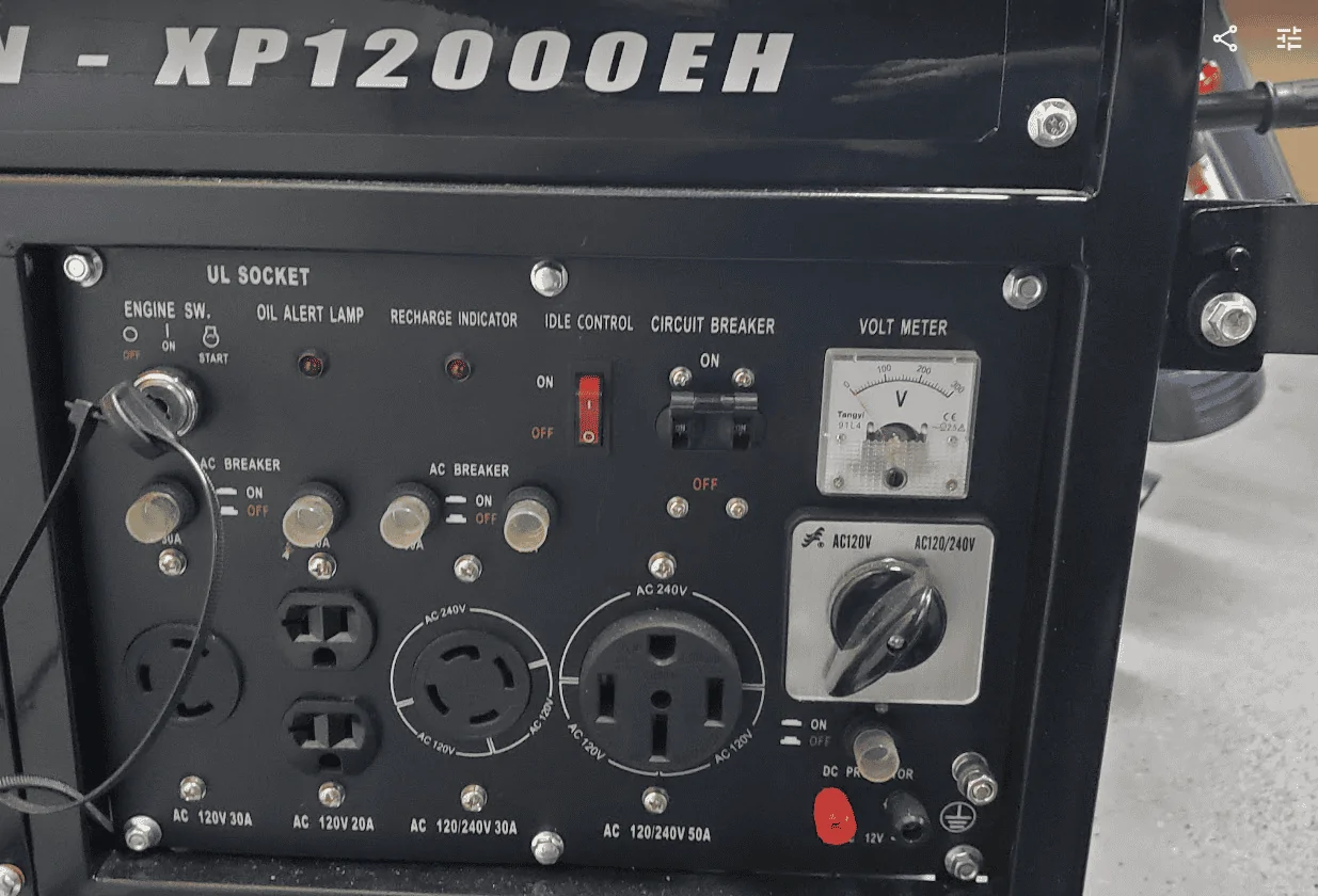

Has anyone been able to charge their Lightning from a generator. I was trying to hook up my mobile charge station up to a 10kw DuroMax generator to see if I can charge my truck instead of driving 30mins to a DCFC and leaving the house without power.
I tried both with and without the ProPower Onboard turned on, so I know it wasn’t that, but every time I hooked up the charger it just had an amber light and the truck said it couldn’t identify charger.

Yes and neither worked, but I was able to use other things plugged into the outlets.
My guess is either the power is just too dirty or the ground caused it problems.

Very well could be the ground.
On side note couple years ago when I used my Duromax to power the house, the generator frequency was off by a few hertz preventing my APC UPS from switching from backup mode to grid mode, once I got it right at 60hz the switch over occured.
Don't know if this could be an issue with the FMC functionality.

If the duramax has a floating neutral then any respectable EVSE will throw a ground fault and you won't be able to charge. Some of the cheapo Chinese white label EVSEs are more lenient with safety and would possibly work in that situation.
The EVSE wants to see a voltage across the hot and ground before it starts charging. The ground and neutral are bonded in your home so there's no problem using the EVSE when plugged into the wall. Most generators don't have a bonded neutral and ground so the EVSE will throw an error.
You need to buy a or make bonding plug like this to bond the ground and neutral. As always, hacks like this are done at your own risk (especially when recommended by a random internet person).

I may try making a bonding plug just to see if that’s the issue later today after I head to an EA FC this afternoon to get back up to 90%.

Tried the bonding plug and it did work for a few minutes then turned amber. I’m thinking the output is just too dirty/low voltage to run it.
I’ll look at the generator specs and see if I can adjust it.

The voltage shouldn’t be a problem - you can feed the 240V plug with 120 and it will charge. I’m going with “dirty.”

Try turning off the automatic idle control switch to off if your generator has one.
