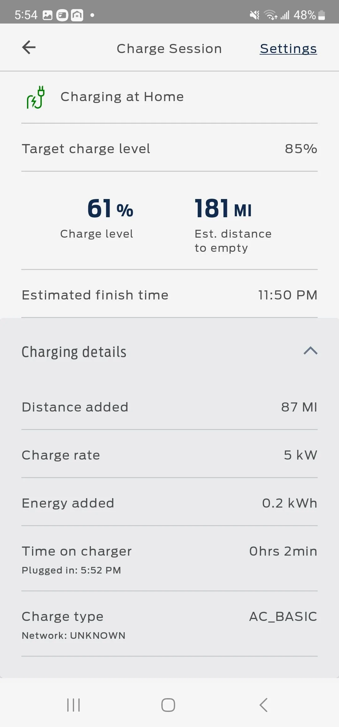

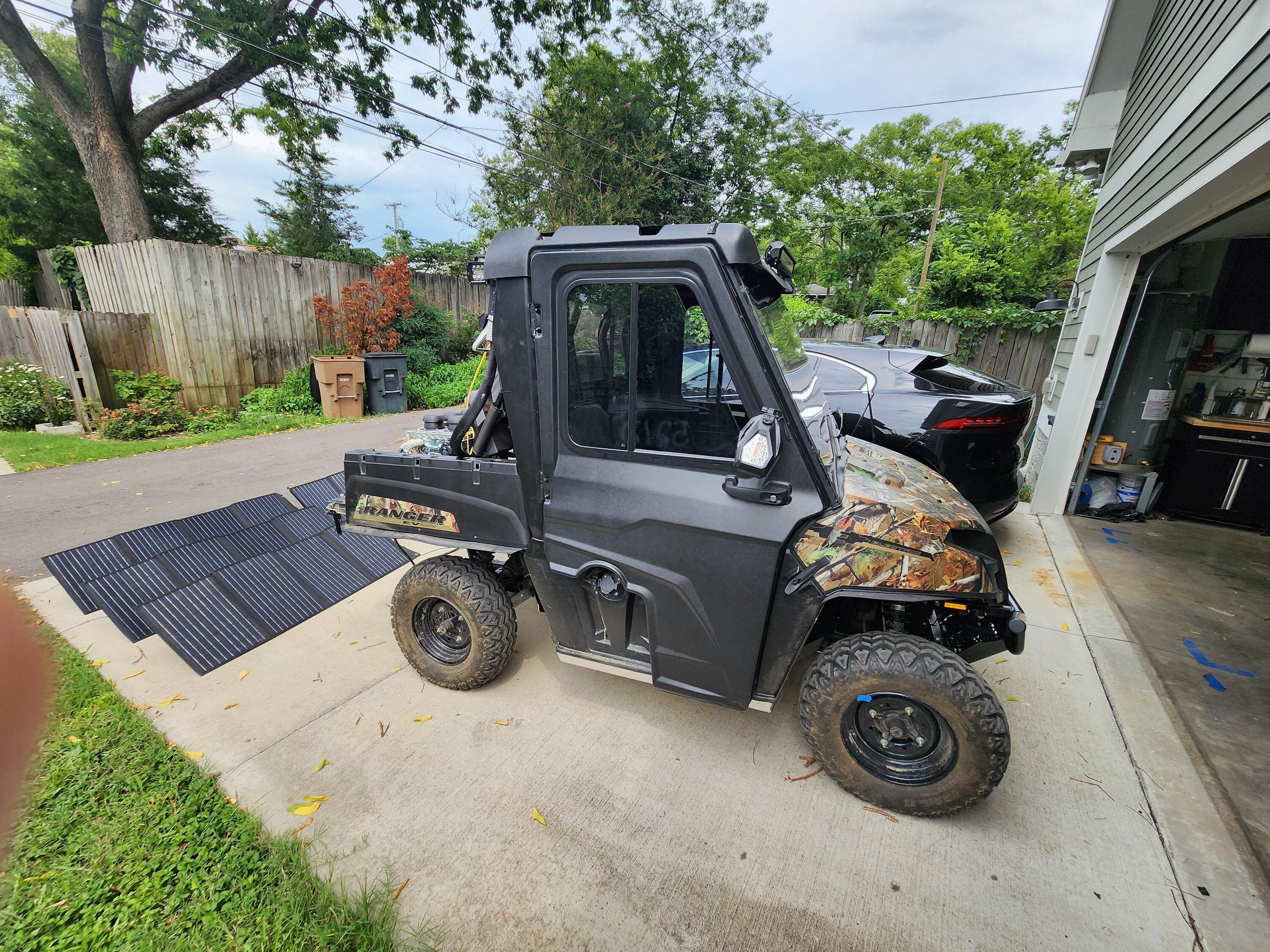

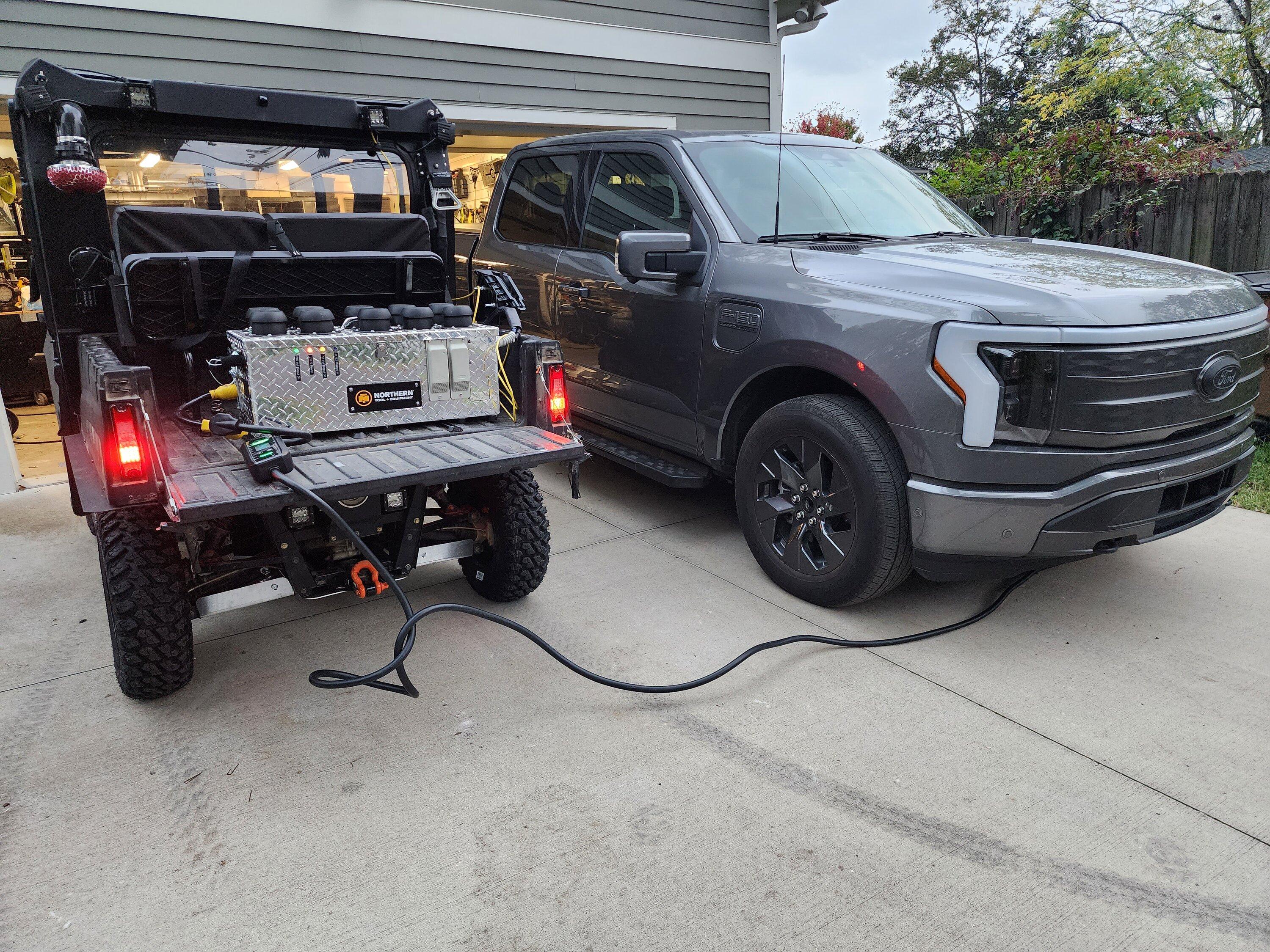

I bought a cheap Polaris Ranger EV with lead acid batteries on Facebook and converted it to run on lithium batteries. I rigged it up to run a 6 kW inverter so I could use it as a battery backup in a pinch. I also added a solar panel to the roof and connections for a solar array. It only takes 300 hours of direct sunlight to charge the lightning from empty using this setup!

I paid $4000 for a 2012 Ranger EV on Facebook. The motor and Sevcon motor controller were in great shape but the flooded lead acid batteries caused a lot of corrosion on the battery tray and the side of the frame. I was able to replace the tray and the rusted out parts of the frame for about $400 in parts from Partzilla. The rest of the frame was a bit rusty but structurally sound-I sanded those parts down and repainted them.
We bought six 24V 100Ah LFP batteries from Epoch and connected them in a 2 series 3 parallel configuration (48V/300Ah/14.4 kWh). At the time, the batteries were $900 each and the total was $5200 after discounts. We chose those batteries because they were waterproof, had self-heating ability, had beefy BMS's and were small enough to fit under the seat.
There are several companies that offer drop-in battery packs for the Ranger but they tend to be a little more expensive.
You can generally find cheaper options if you look around. The trick is that the battery's BMS has to support the peak amperage of the Ranger. It will draw close to 400 amps at peak load, so you really need a battery array that can support 400 amps for at least 30-60 seconds. Batteries we used have 120A continuous discharge and 200A x 60 seconds peak discharge capacity, so the 2S3P configuration can support 600A for 60s and 360A continuous.
You may not need as large of a battery pack as we have so you can save some money that way. We get 3.1 mi/kWh at max speed on flat ground, so our battery array gets us about 40 miles at minimum. That's a lot more than we need on a daily basis and it's easy to top it off with the 1kW on-board charger I installed.
