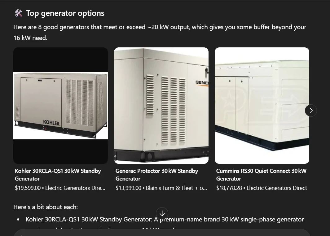

Check my math but I took a 135 mile drive this morning and stuck to 70mph on I40 from Raleigh to Wilmington, NC. Reasonably flat terrain with minimal wind but the temp was only about 45F here in eastern NC this morning. Dash showed 1.8mi/kWh. Got home and charged from 18%-80% on my FCSP today and averaged about 15.8kW to the battery (according to the difference in energy remaining in Car Scanner) over the 5 hrs it took. So at that rate, it would be a net used of 70/1.8=~39kW-15.8kW=23.2kW. Assuming no degradation, 131/23.2 = 5.6 hrs or ~400 miles at 70. That's roughly 10mi/gal. That is a substantial increase over the 235 miles or 3.5hrs I'd get on just battery though. 2.1mi/kWh would give you a theoretical 7.5hrs and over 500 miles at 70mph assuming a sufficient fuel tank. I'd need a couple breaks before the truck would.
And gotta love chatgpt. Asked it for alternatives to the westinghouse and got this. Guess I should've mentioned it needed to fit in the bed first. :cwl:

It really likes Winco Vehicle Mounted Generator - EC22000VE-17, 19 kW, 35 HP Briggs & Stratton, 3-Phase, 240 Volts for some reason.

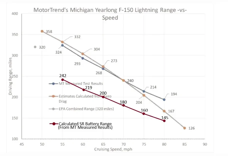

heck I felt like i was about to get run over just running the speed limit. Have a comma 3x and it estimates the speed of the car in front of you and most of those that passed me were showing 85-90 and this was from about 6:30-8:30am. Can probably count on one hand the number of cars I had to pass but I lost count of how many thought it was the Daytona 500.
My normal non-interstate route to the coast and back is mostly 55mph highway. Running 60, I average about 2.2mi/kWh which is pretty close to Motortrend's numbers.
