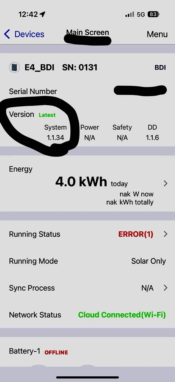

Ford F-150 Lightning Class Action Lawsuit - Home Integration System IMG_1193
Do you have a telephone # for Ford as to this specific issue? The one I had been using, 800-777-6609, is disconnected. Also, any suggestions on how to determine if I have the V34 update?
To see the software rev # on your HIS, you need to download the MProfessional app on your phone. Hold your phone next to your HiS and search for your HIS in the app. The default password is 6532. Once it loads, you will see the Rev # in the opening screen.
The 4-digit password specific to your HIS unit is also on the serial number plate on the side of the unit. The M Professional app will also inform you if there is a pending update for your HIS unit, and you can manually trigger it through the app. V34 is also the latest for me.
