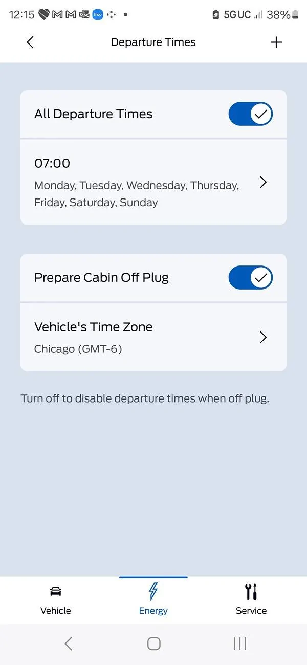

Today I did what the message said and started my truck. And bang the climate control worked again. Waited an hour and still worked as some thought it might go into a deep sleep. Then I wondered ?...I had my departure time active before so I turn that on:
Ford F-150 Lightning Climate Control issues - Setting Departure Time Schedule is messing with function. Screenshot_20250122_121546_FordPass
Immediately I get the Climate Command Failed message when I try it. The truck was not plugged in but I did have Prepare Cabin Off Plug selected. So I turn off departure time, started and stopped the truck. Climate Command worked.
Plugged in truck, departure time still off and Climate Command worked.
Keeped it plugged in with departure time active and got the Climate Command Failed message....is this how it works for everyone else?
