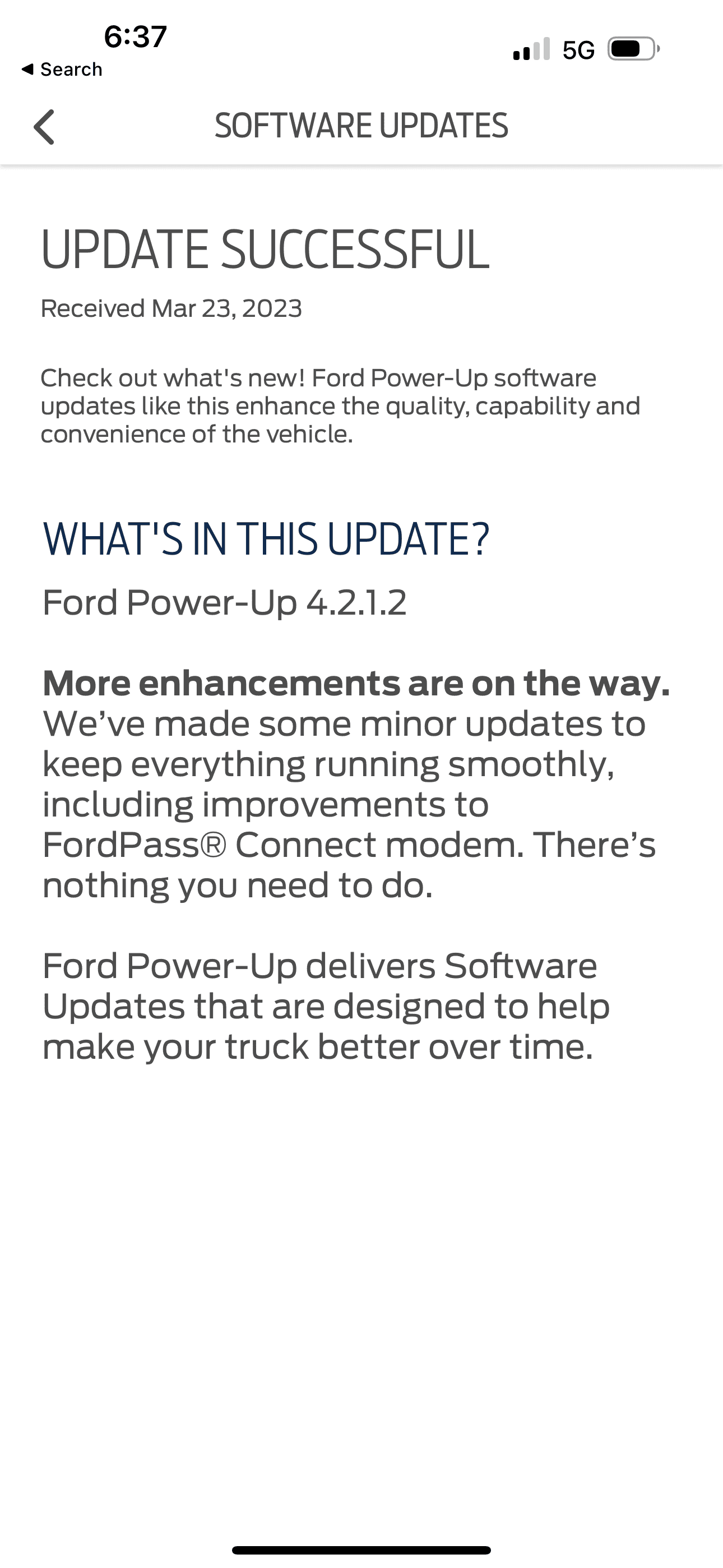

Well, for the record I finally got 4.2.2.2 yesterday. Great to have the volume knob versatility after having MachE envy for a while!
Still on 4.2.1.2 since 03/24/23 on my 2023 and patiently waiting for 4.2.2.2 so I can get my volume knob versatility. Lol ?
