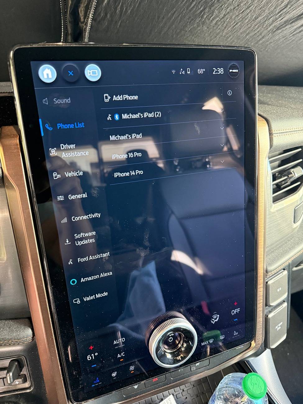

My truck may have received an update and the "control" screen for drive mode is now missing. There have been a couple people that have had this issue but I didn't see a resolution. I did the sync reboot holding the volume and next track button. Also disconnected the battery negative for a min. Neither worked. Software updates shows 6.14 available but not ready. @Ford Motor Company any thoughts here?

6.14 is the latest version to date. I can tell by your center stack screen it has not loaded as of yet. Beyond that I got nothing.

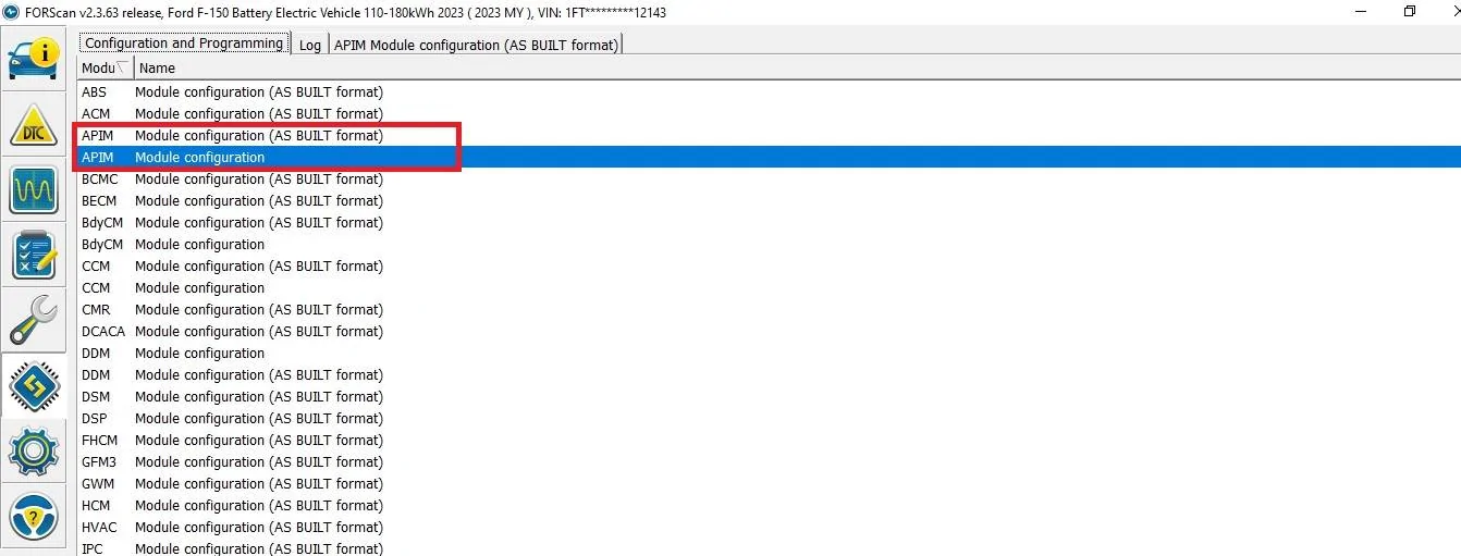

There are two lines for APIM.
Ford F-150 Lightning Control - Drive Mode Missing APIM
Ford F-150 Lightning Control - Drive Mode Missing APIM AS BUILT

Based on that it should be good. You could try changing that 0441 to 0041 and write. It'll give an error about the check sum but you can ignore it and then it'll ask to turn the ignition off and then back on. Then repeat with the number as a 4 and see if it happens to pop back up. Aside from that, it's probably time for a dealer trip. Maybe they can redo the APIM update. What's your sync revision under General-About Sync?

Well damn that worked! Thank for your help!

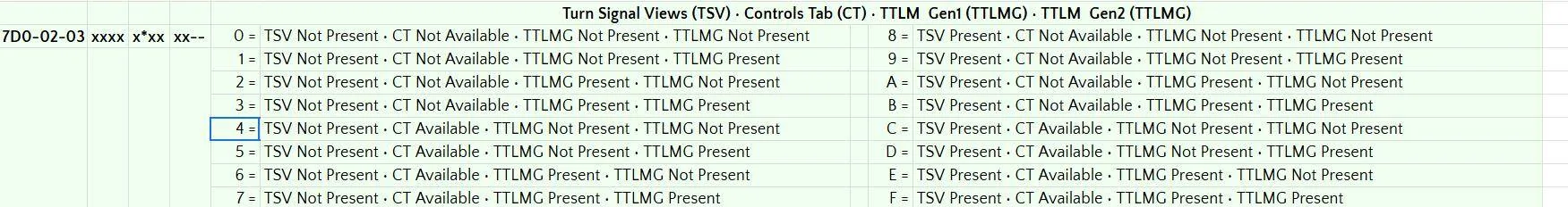

Glad it worked. Would like to say I fully expected it to but that was a total stab in the dark. lol. You can see in the below snippet from Livnitups spreadsheet why that digit can cause the controls tab to disappear if the wrong value was used there though.
Livnitup's FORScan - 2021-24 F150 - Google Sheets
Ford F-150 Lightning Control - Drive Mode Missing 1731375785123-k6
